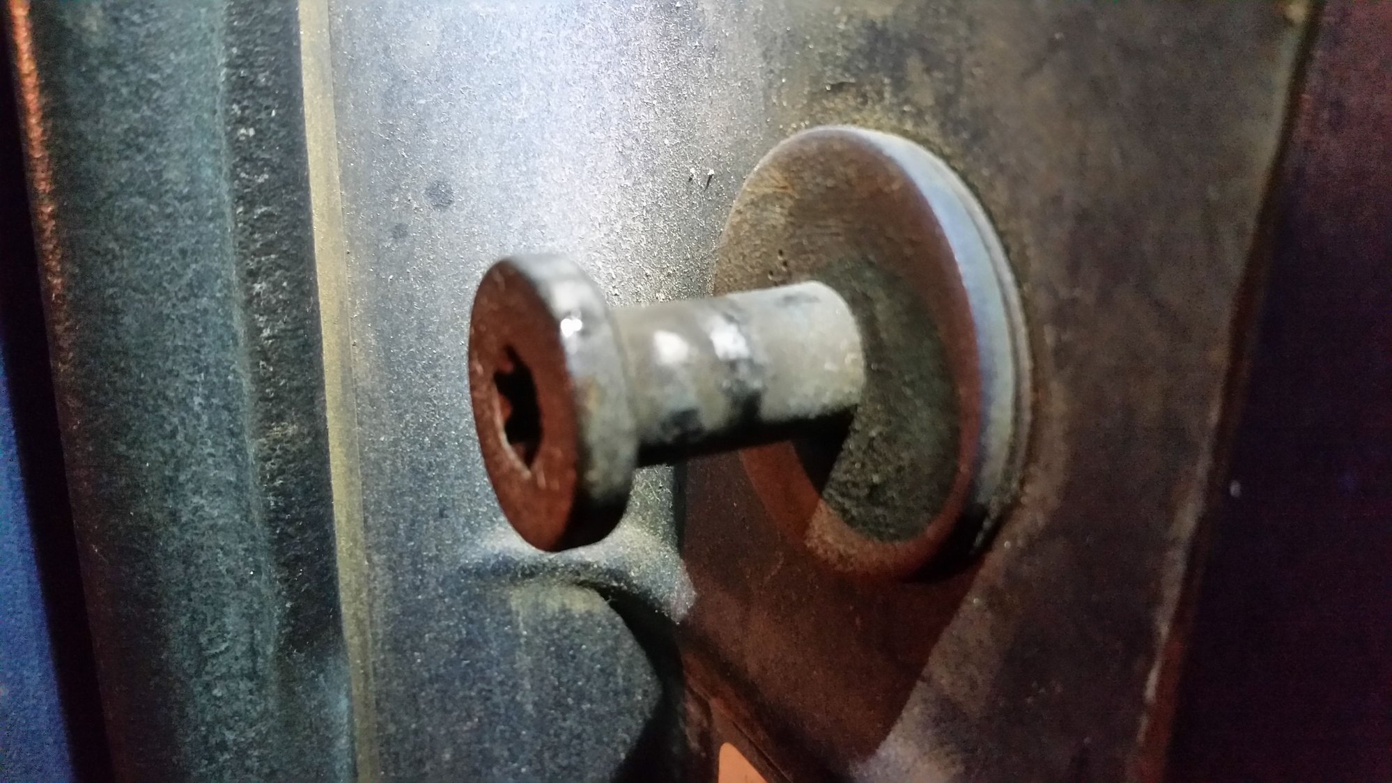

Neither door has a bushing around the metal strike pin, and I see no evidence that there was any there before. I have included a picture of the latch and pin for reference. Is this supposed to be thicker?
Thanks!
Yes, there should be a plastic sleeve or bushing around the striker pin.
