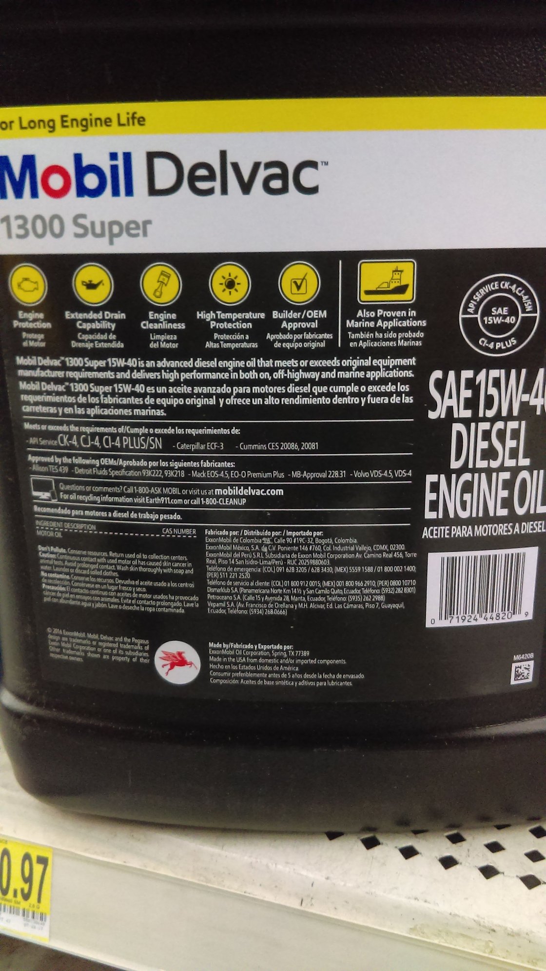

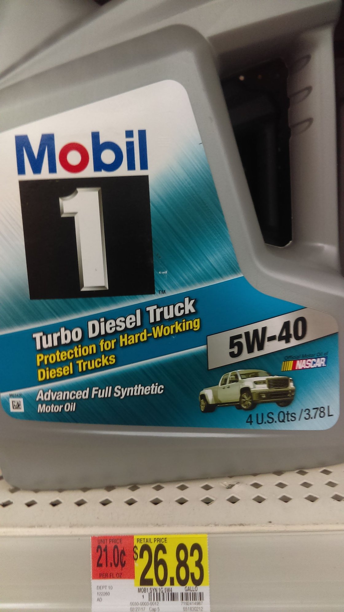

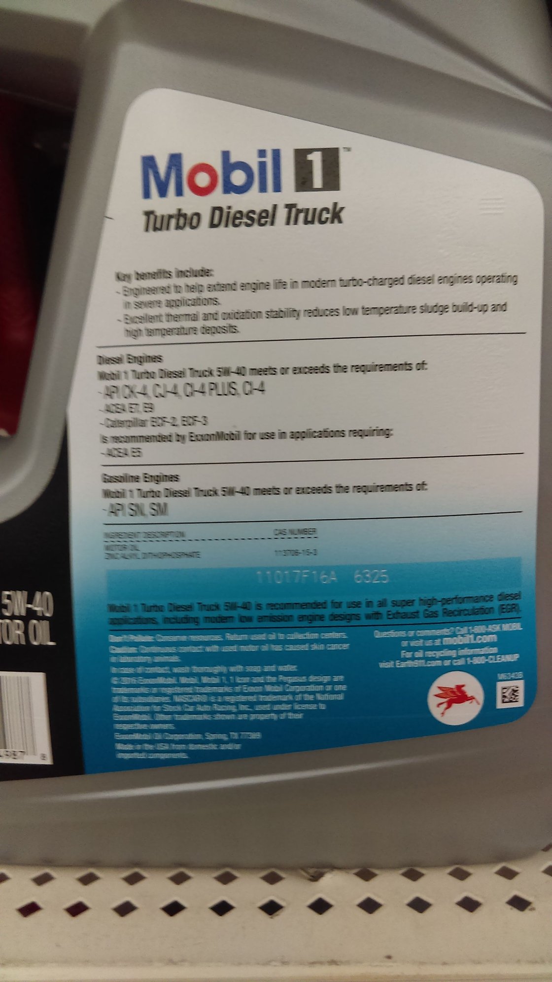

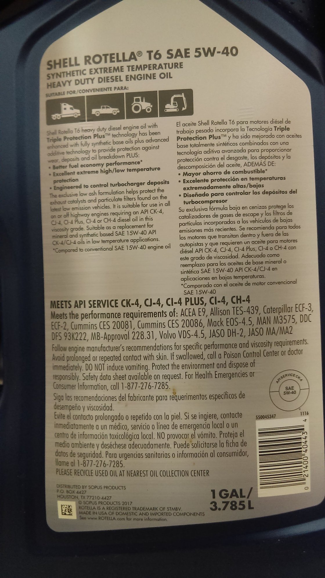

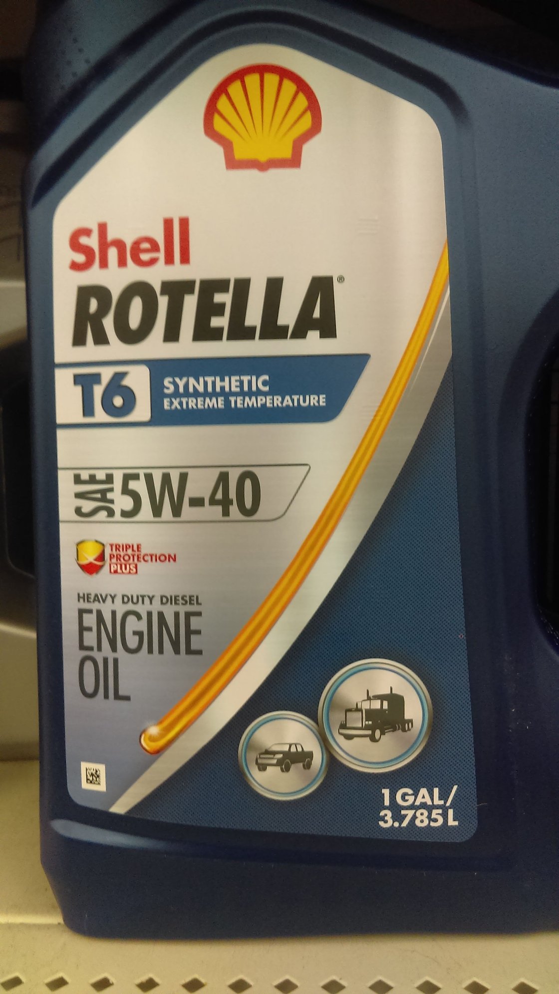

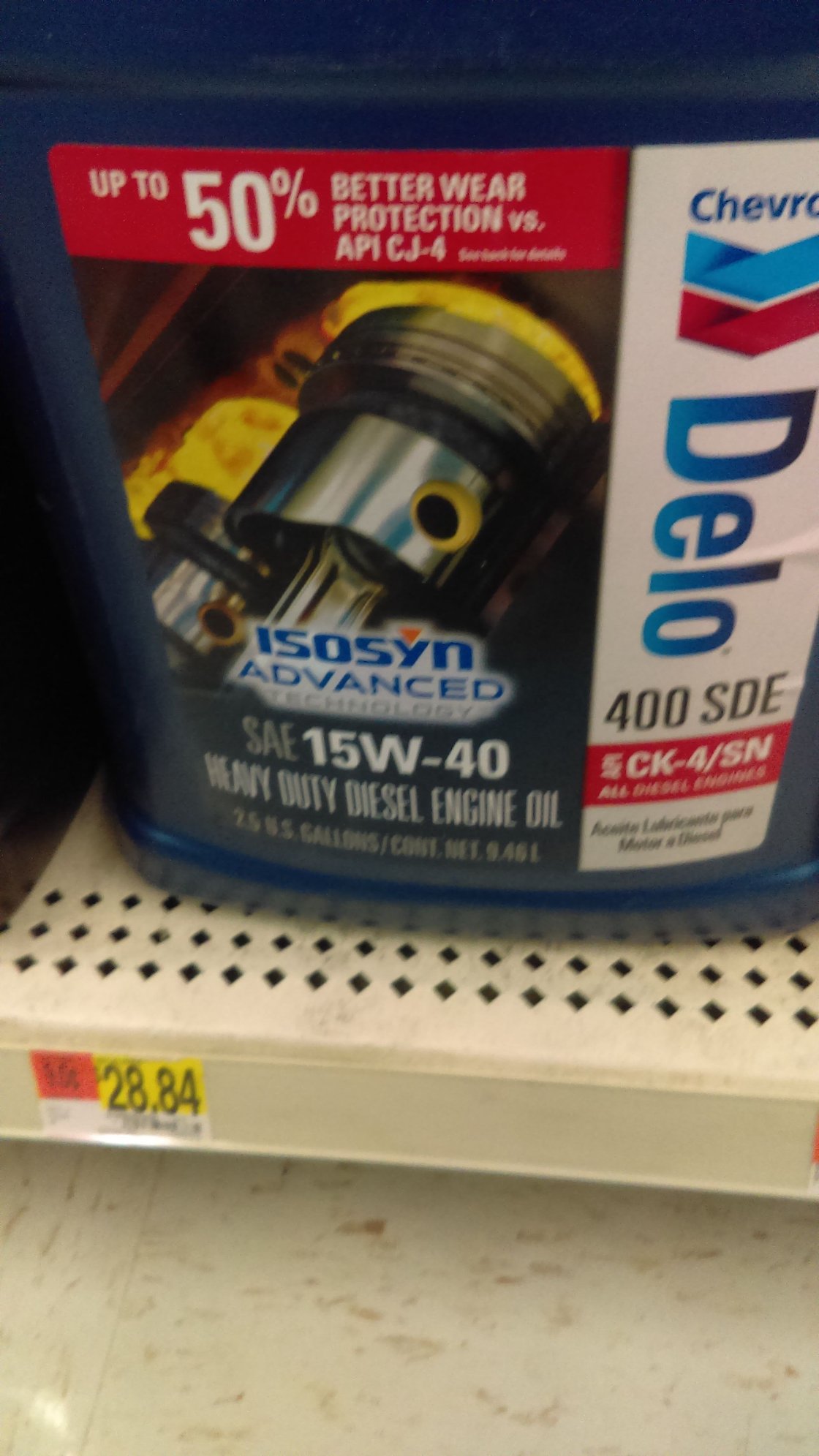

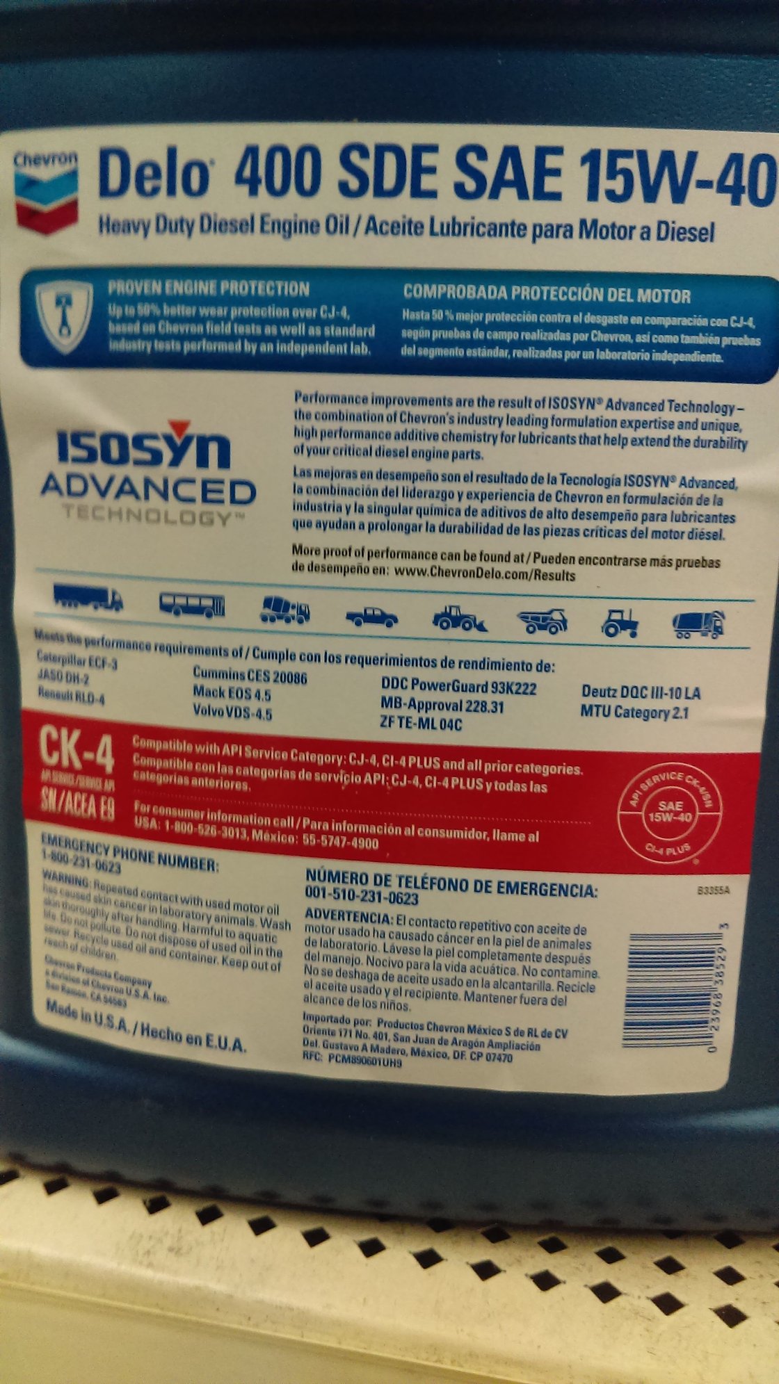

Took the liberty of taking some pics at WalleyWorld of some oils I need to know which would be good to use I'm fast approaching an oil change and ran the last stack of the 15W40 Rotela.
Which will you choose?

I'm having good luck with the T-6 and it says it meets CJ-4 so I'd go with that myself.

Ford says they tested the new CK-4 oil and found excessive wear on powerstroke diesel engines due to low phosphorus content. I really only think that this applies to the 6.7L. I just can't see Ford bothering to go back and test every single diesel engine they made. Did they go back and test and old 6.9L IDI too?
I don't think that Ford's recommendation applies to our engines. However, that doesn't mean the new oil is any better or any worse. I don't think anyone has done any testing to find out, to be honest. I don't know if it's worth it to try and find oil that meets Ford's spec or not. I wish I had an inkling but I will probably just go with the T6 next time and hope for the best. I thought that we would have more oils on the market by now at retailers that meets the Ford spec. If you have a 6.7L it appears you can't buy oil at Wal-mart anymore.

Every single one has CJ-4 written on the back.
I don't think that's in dispute.
