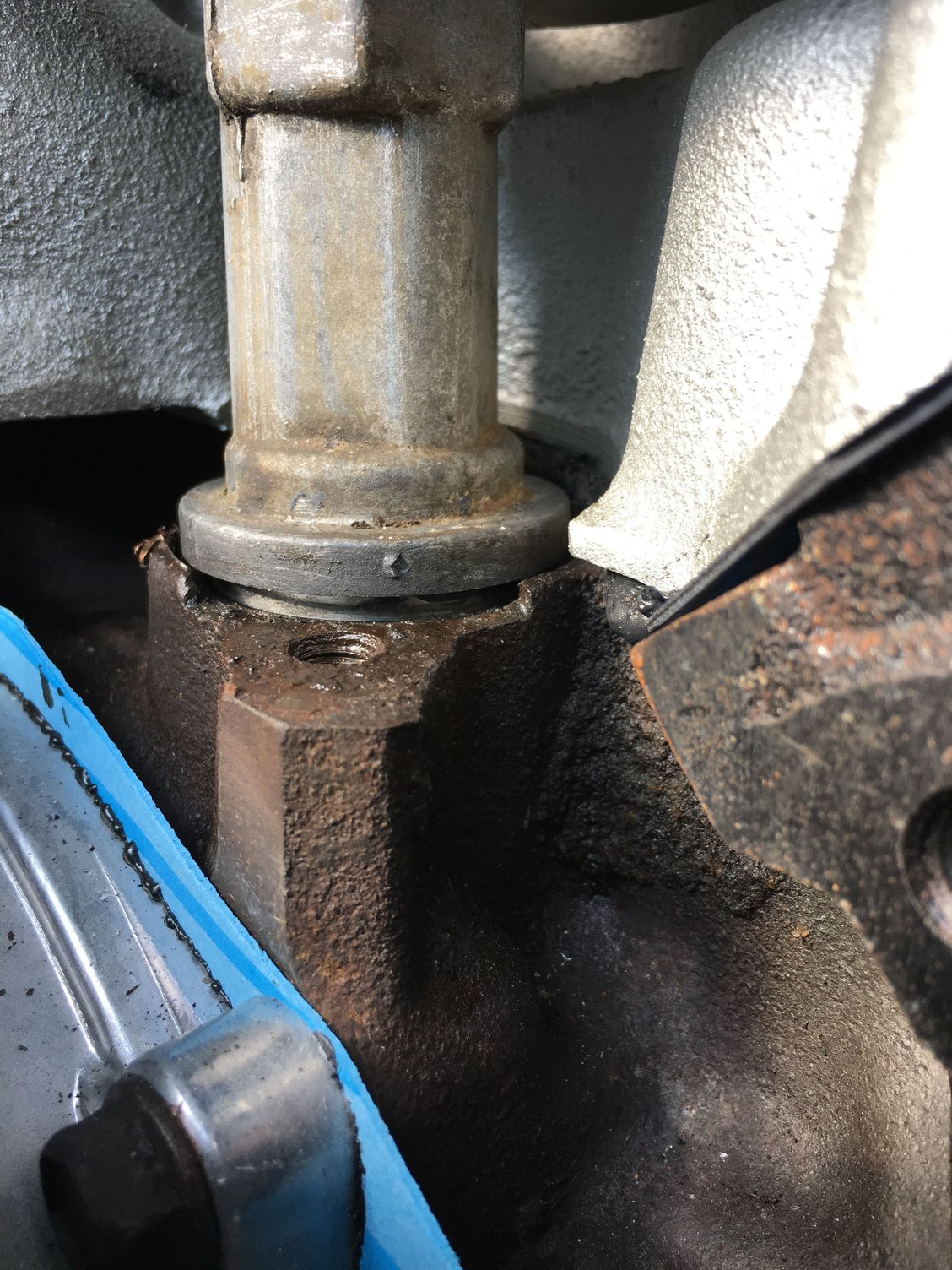

I had the cast gear ('89 302) replaced with the steel gear off of the '98 Explorer camshaft synchronizer to use for my roller cam. The problem is that the gear is hitting the support in the block before the distributor is fully seated. There is maybe 1/16" to go before that happens. I tried both the Explorer housing (without a gear) and an old distributor out of my '87 Bronco and they both seat flush on the block. I put a dab of grease on the gear and it is definitely contacting the support. Looking at replacement distributor gears there appears to only be the choice of material and not pin location in the gear. Would it be alright to run it that way?

I'm positive that the gear is what is preventing it from seating the rest of the way. I hadn't thought about the hold down putting even more pressure on the dist gear. I have another distributor on order. It should be here in a couple days. The 'new' gear was put in the same place that old cast gear was located since that is where the hole was in the dist shaft. There must be more distance between the (factory) hole for the pin and the bottom of the steel gear

I don't see how you could drill a new hole in the distributor shaft without weakening the shaft. It needs a little more than 1/16" to seat on the block.
It is the original distributor and it used to be fine. Both the Explorer housing (w/o a gear) and my '87 distributor with the cast gear drop right in.

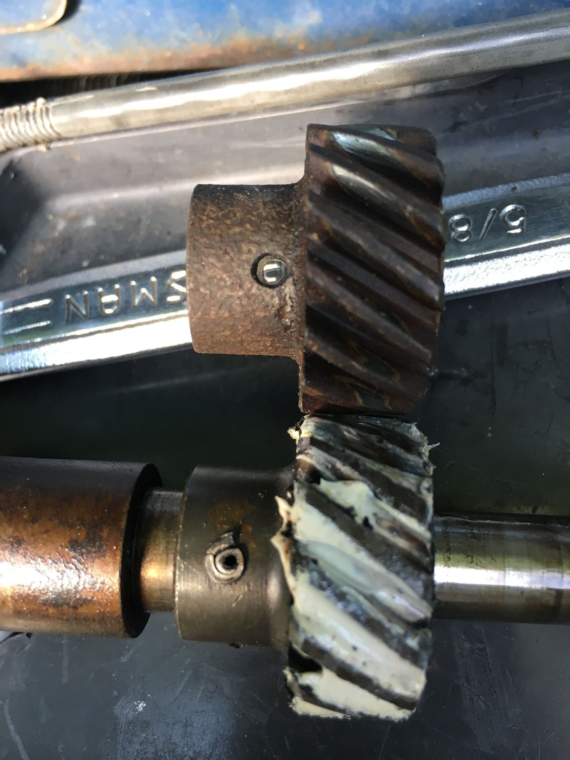

Old Aug 13, 2017 | 04:22 PM
My4Fordtrucks's Avatar
My4Fordtrucks
Joined: Jun 2015
Posts: 12,791
Likes: 2,426
Fully seated on the steel gear
Looks to be about the same amount I need it to drop.
I guess I'm mostly just surprised that I could not do an even swap
with factory distributor gears.

You can see how the old gear sat higher on the shaft, if you match the pin holes up, allowing it to fully seat on the block, versus the new gear.
