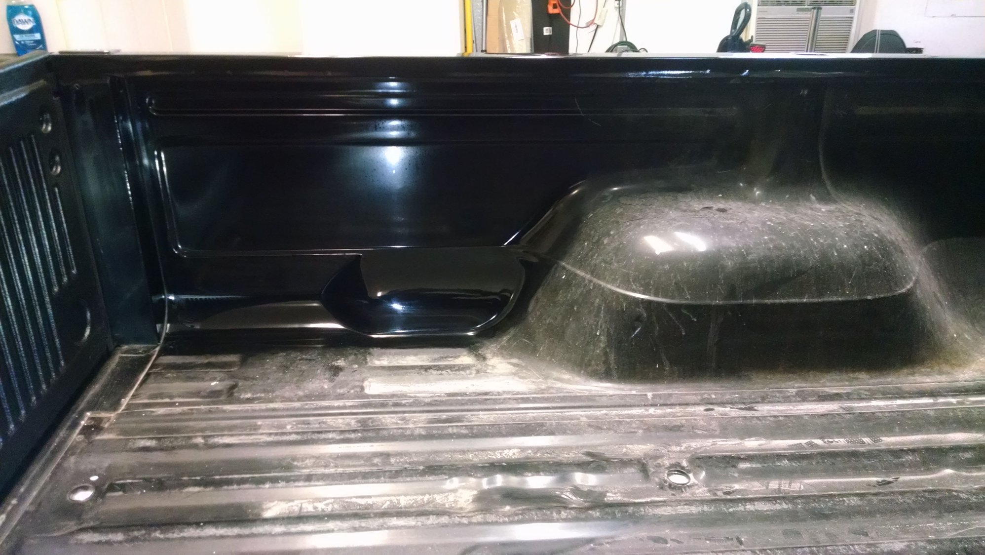

How do you bring faded back to its original shine? Half of my bed is faded and the other half has its original shine

Looks like a repaint?

Spend some time with some fine grit polish and then switch to the ultra-fine or the finest you can get your hands on.
Really odd how one side looks great and the other side looks like it was painted and not shot with clear.
I'm assuming the stock finish was a base coat and a clear, here. Assuming the clear isn't peeling, just spending some time polishing it up should bring it back.
You can make the job quicker by using a rotary tool, but I honestly prefer to do it by hand so you don't cut too deep with whatever medium you're using to polish.

What he said ^^^^ Unless it is actually faded and has been repainted (which I doubt) we need to know what does the rest of the paint look like? The hood, doors and especially the roof. Depending on what you tell me or better yet include some more good pictures so we can tell what has happened to the paint. One off hand possibility is the previous owner (if you have not had it long) worked his A$$ off and did a good job with the good side and then said " Since I'm selling it I'm just going to show them what is under the old paint. Basically said to heck with all this work. If that happened, you might have a real gem hiding. I think I could lure it out if that is the case. Also, if just that one side looks good, look under the truck for damage at that side. Look inside your door jambs and see what the paint looks like. Try a little polish and wax to the jamb and see if it looks like the good side. Sandy

I will cast my vote for it being repainted. Like Sandy said, pics of the rest of the truck will likely tell "the rest of the story". Also, look for other signs of repairs on the good side, newer wheel, trim, inside of bed, etc.

I hope the OP comes back. "I got's to know". OP, what planes are those in the reflection?

By the way, where are those airplanes you mentioned? All I can make out is a ladder and a can or jug of some type.

Shiny side has clear coat, the dull side is single stage paint

The rest of the truck is shiny. Just the driver side of the bed is faded. Thank you guys for all the help!

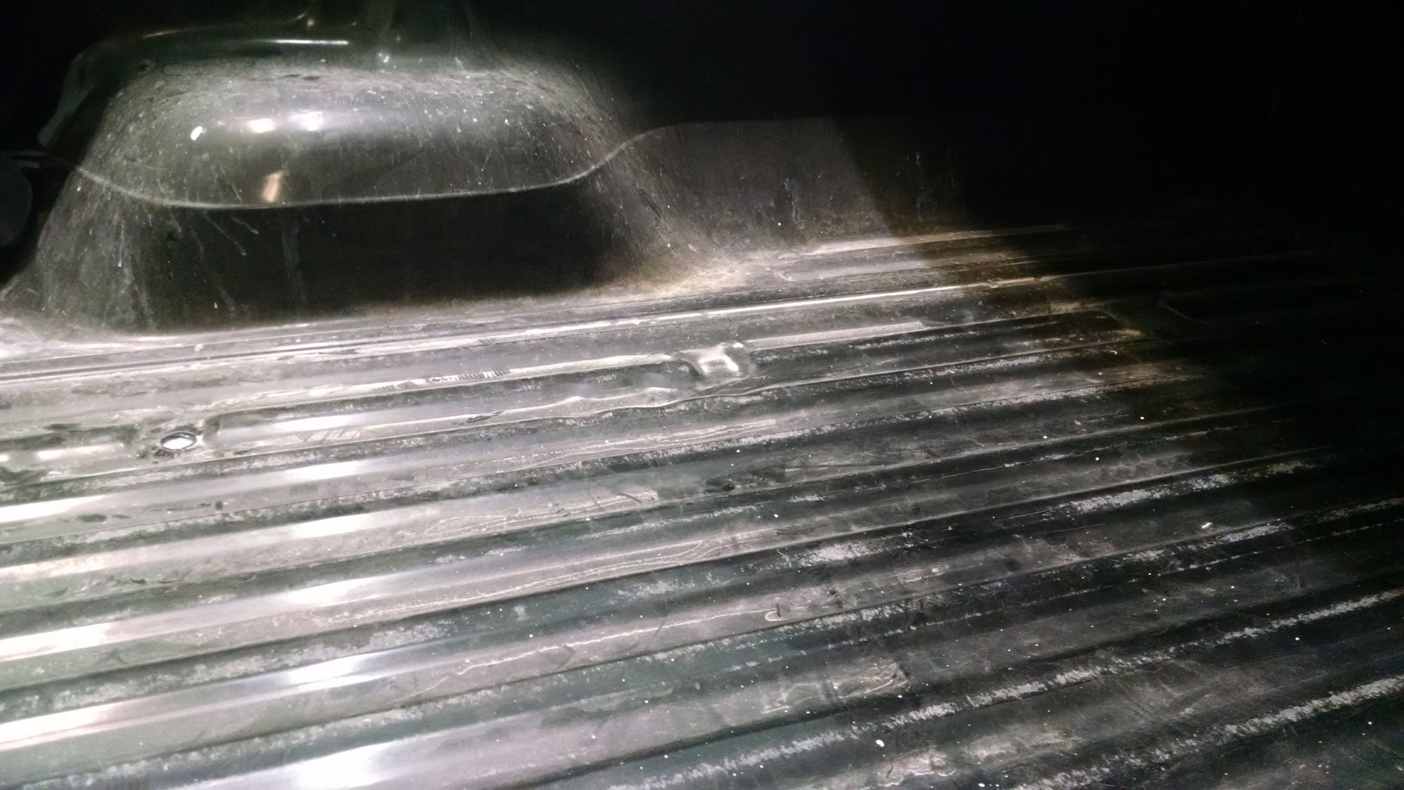

Do you want to try and see what you can do with that faded side? I can tell you what I would do. I need to do something with my bed after my body paint job. I put a tri-fold on it but I want to fold it back at car shows. I was checking my bed today and did a half-a$$ job of cleaning, polish and some wax to see what I had. The side paint looks in good shape but it had a bed liner for 22 years and is scratched up on the bottom of the bed. I am going to leave it scratched up but polish etc the entire bed. The scratches might add a little character. Sides look good. I am going to do what I would do to yours if it was mine. It will take me a couple of days to do mine so if you want to wait and see how it turns out, you can then decide what to do. Sandy....... Look what was hiding under that crap. Can't wait to put my Porter Cable on it after it is prepped for detailing.
