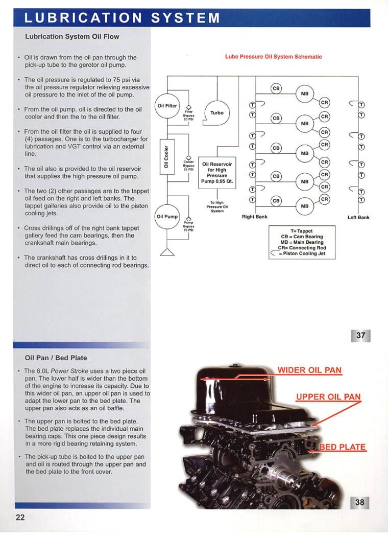

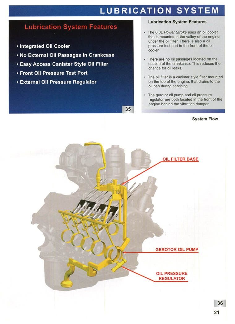

I had a really long post to this tread a few days back, went to another tab and when coming back lost it all.
Posted before, maybe once more, the old oil analysis spreadsheet of participants from DTS long ago.
The 6.0 is a curious animal compared to the 7.3 where we had seen guys go 50k miles and longer with extended changes. There was a member early on who I thought was a Nav engineer who posted about the shearing issue, and my take has always been the 6.0 shears down the viscosity modifier and the oil ends up at the base level. From the initial fill data collected in this pdf's graphs, you can see it happening pretty good at 3k mile life.
Extended life per Blackstone seems to be more in line with how much contamination is in the oil, including wear metals. If I posted the 7.3 data you could see that.
To me this motor has a very wide oil pressure delta by temp. While it's stated there is a 75 psi high pressure regulator off the base oil system, those who have installed agauge (not me) have noted on cold start all the way to 100psi at idle. Then it can be reported at hot idle the pressure is down typically in the 20psi range, and not unheard of around 15psi.
So for me it's the hot idle where I think things get problematic, mostly for lifters in a 6.0 and 6.4 since these are the motors that these widely used lifters in many motors get their roller bearings to fail. These are the only motors where the lifter have to open twin valves.
It's pretty well understood that the VT365 does have the head gasket issues the 6.0 has. With it's lower HP the injection event is a longer process for torque rather then higher volume early on for more HP, at least the way I understand it. That may have a lot to do with bearing wear and oil film compression in the lower end, but it changes nothing at the lifters. But it's possible if the 6.0 is programmed for higher HPOP system pressure for operation, the higher pressure generated and the resulting flow through the injector per a given motor state is why the oil viscosity is not lasting in the 6.0, and the need for early 6.0 intervals. Just SWAGing here.
In one of Anthony's video's he is trashing a factory rebuilt motor as it's worn out everywhere. But as he was going through it's problems from my gas motor life I kept thinking low oil pressure .... low oil pressure, not who rebuilt the motor. Maybe I'm mistaken but I thought the background vehicle the motor came from was a service truck with a bucket lift. If that ain't long idle I don't know what is. And long idle trucks like that often don't get oil changes as often as their mileage indicates unless the maintenance is based off engine hours rather then mileage.
Most lifter failures in the 6.0 seem to be the back cylinder 8 lifters highest, 6 the next. Cylinder 7 lifters are much rarer and the more forward lifters rarer still, not that they don't happen. The cylinder banks oil passage ways feed the lifters, but it's the odd bank passage that also lubricates the cam bearings and finally the main bearings. At first the gut feel is this might result in low pressure compared to the drivers side, but that would be dependent on the feed passageways coming from the top of the motor. That's not what I'm thinking may be happening.
With the drivers back passage only flowing to the lifters, the oil has a longer dwell time in that passageway since the volume is so low. In my mind its possible the oil in that passageway reaches a much higher temperature, absorbing more heat energy from the nearby piston cylinders duet the swell time.
Mark K could probably tell this story better, but how much thermal energy is absorbed in a cooling media is dependent on flow rate, and sometime it's best to slow down flow to get the best absorption as I understand it. So the oil waiting to feed the lifters on the even drivers side gets hotter, and lower in viscosity. And maybe that's the reason for the roller failure rate to be higher on that bank, especially if the truck is at idle generating lower oil pressure.
Sorry, just SWAGing in writing.
Attached the spreadsheet for Gabriel.

I have taken a lot of heat transfer classes and you don't often times get better heat transfer by slowing down the fluid flow (only if you are desiring different flow characteristics like laminar instead of turbulent flow in some fairly high fluid velocities). If you have heat that you want the oil to reject, assuming a constant heat transfer area, you increase the flow. After a point the turbulence will drop the heat transfer efficiency, but these flows are not designed in that region because of the lower oil pressures that you pointed out.
I agree that oil temperature is a key to the performance and longevity of these engines. Oil temperature will drop the viscosity and will lower film coefficients. If viscosities are too low (whatever that lower tolerance might be), excessive heat will only make it worse.
