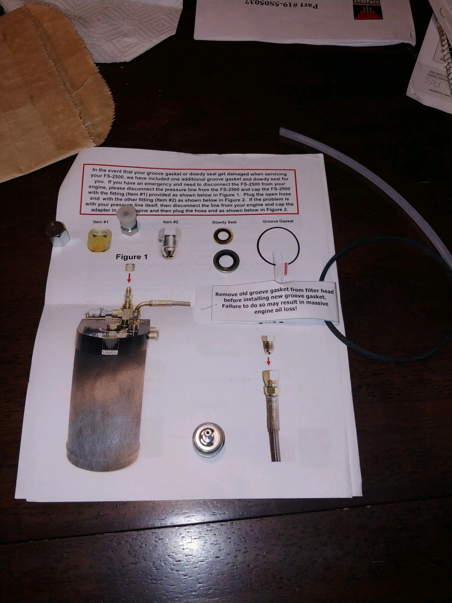

I finally got a start on my FS2500 bypass filter. Yesterday was a rainy day so I assembled the filter housing fittings. Going through all the hardware which I did not do when I got it, I realized I was short a 1/4" tee fitting for the factory oil filter housing. I called the number on the installation booklet and got friendly service. The part was being sent out that day.
I was short one tee fitting, second down from the top.
The oil fill cap, fitting, mounting plate and hardware.
The fittings loosely fit together.

Besides getting an extra sealed washer and new o ring with second filter, you also get an emergency set in case you have problems and the housing is leaking. You also receive fittings to cap off the pressure line in case you need to take it off due to a problem.

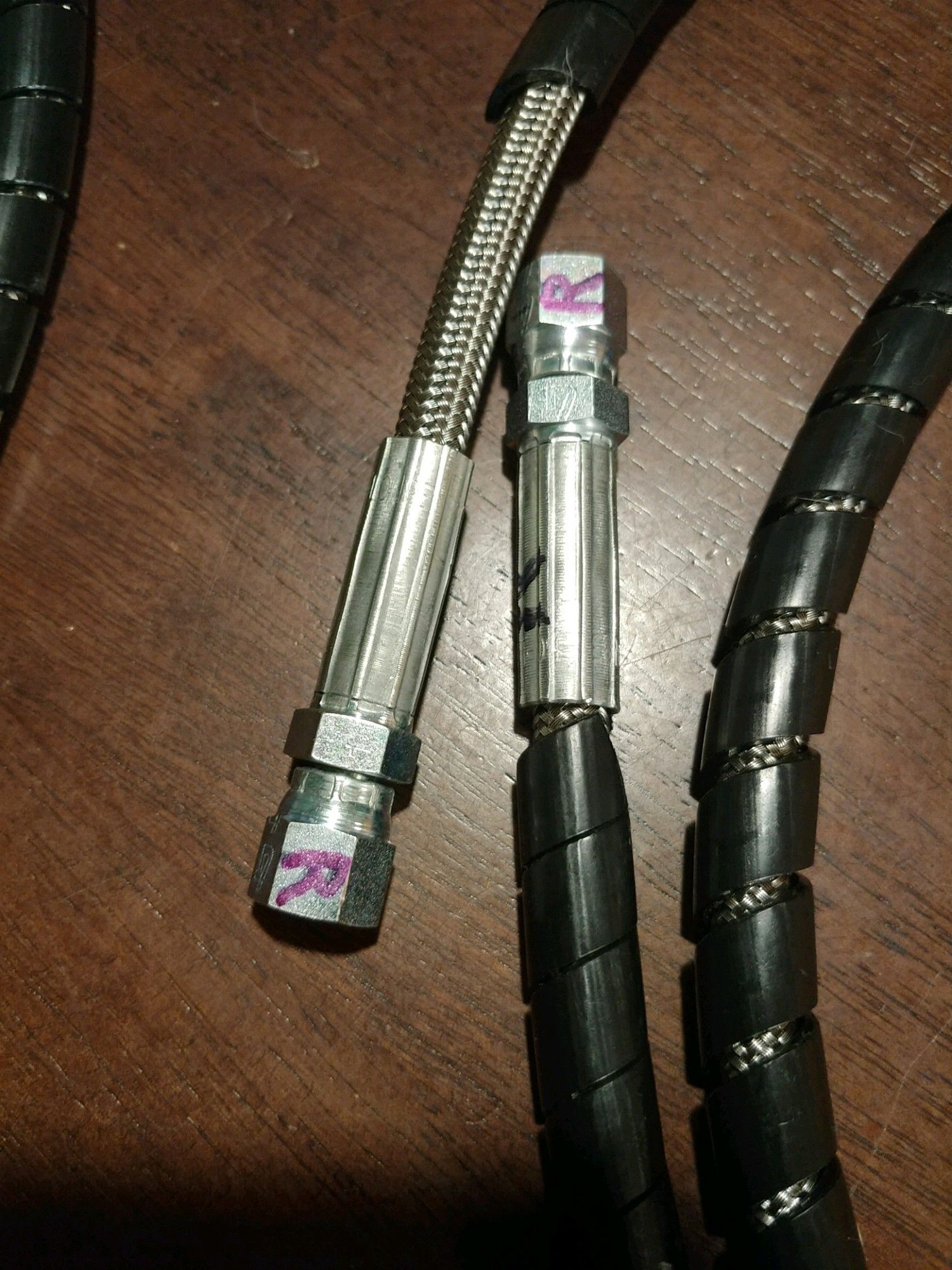

The sampling fitting and hose.
This is the pressure hose because it's a little longer than the other hose. Since the filter mounts on the driver's side, it makes sense because the hose has to run across to the other side. Haven't figured out yet what that fitting is for.
The return hose.

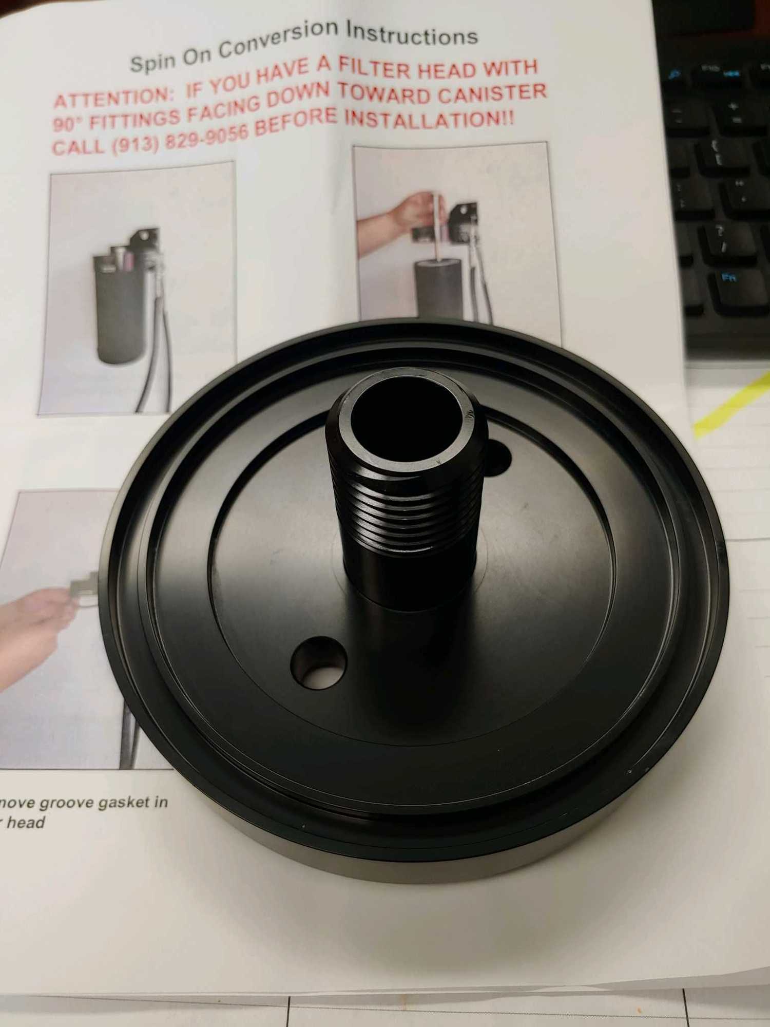

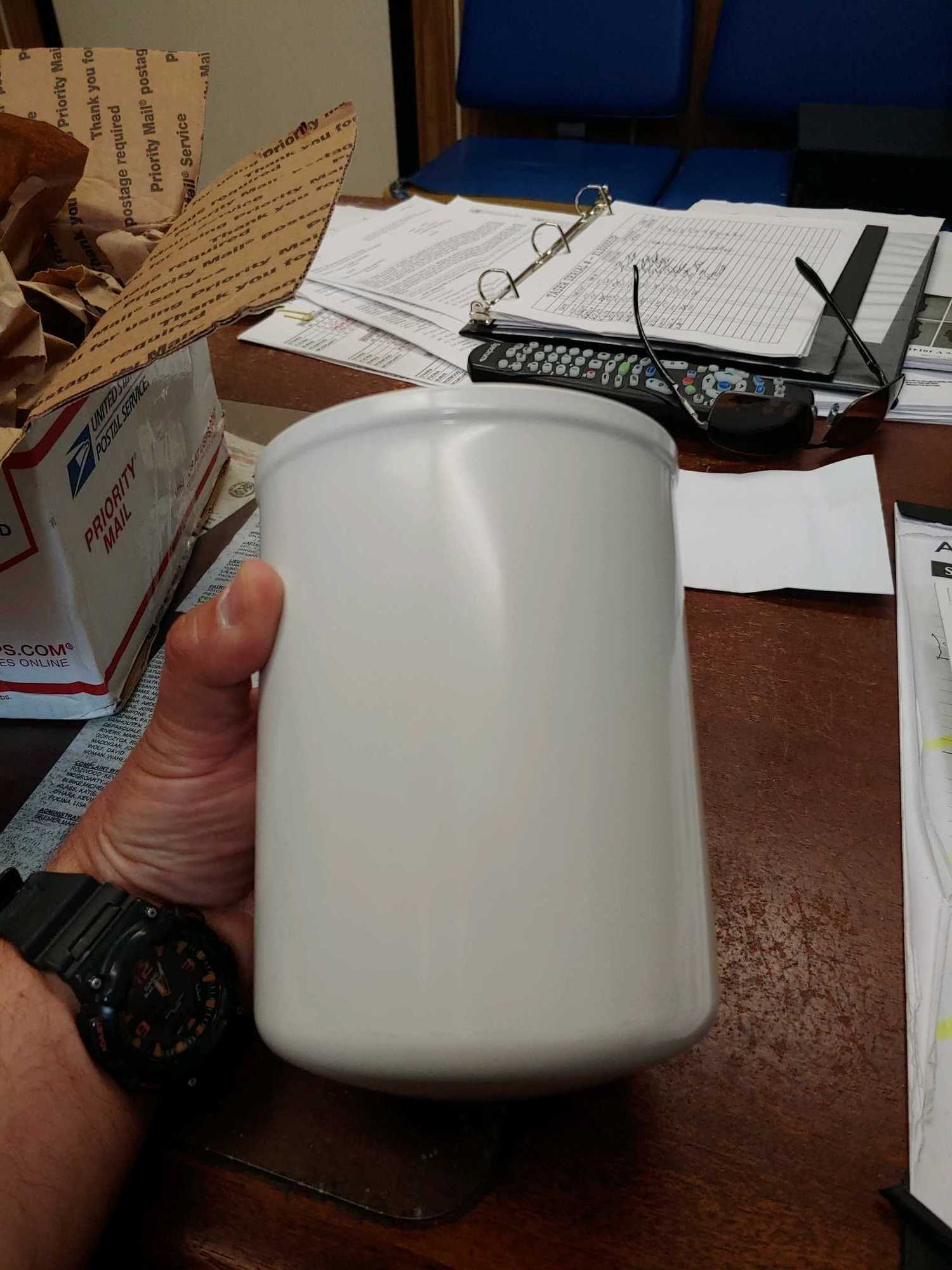

I never posted a picture, or I can't remember, of the FS2500 mounted. But the spin on filter conversion kit arrived today at work. I have truck stuff mailed here when I don't want my financial manager err wife to know about it. It just came out recently so it will be easier to change and last 15k miles instead of the rated 10k miles canister. Before the FS2500 install, I changed the oil out at 33,396 miles. The bypass was installed about 200 miles later at 33,579 miles. I don't have the notebook here with me that has the mileage that I ran the first canister out to but it was 7k miles plus. Filtration Solutions wanted it changed out at 5k miles but I went out to when truck told me to change oil. I checked oil flow on return on oil fill cap and it was good until I changed the oil out.
This thing is a big *******.
About 7 inches high.
At least 4.5 inches in diameter.
The housing that bolts into the FS2500 head.
Machined aluminum, very nice.
The parts...
Very clear and color instructions.
