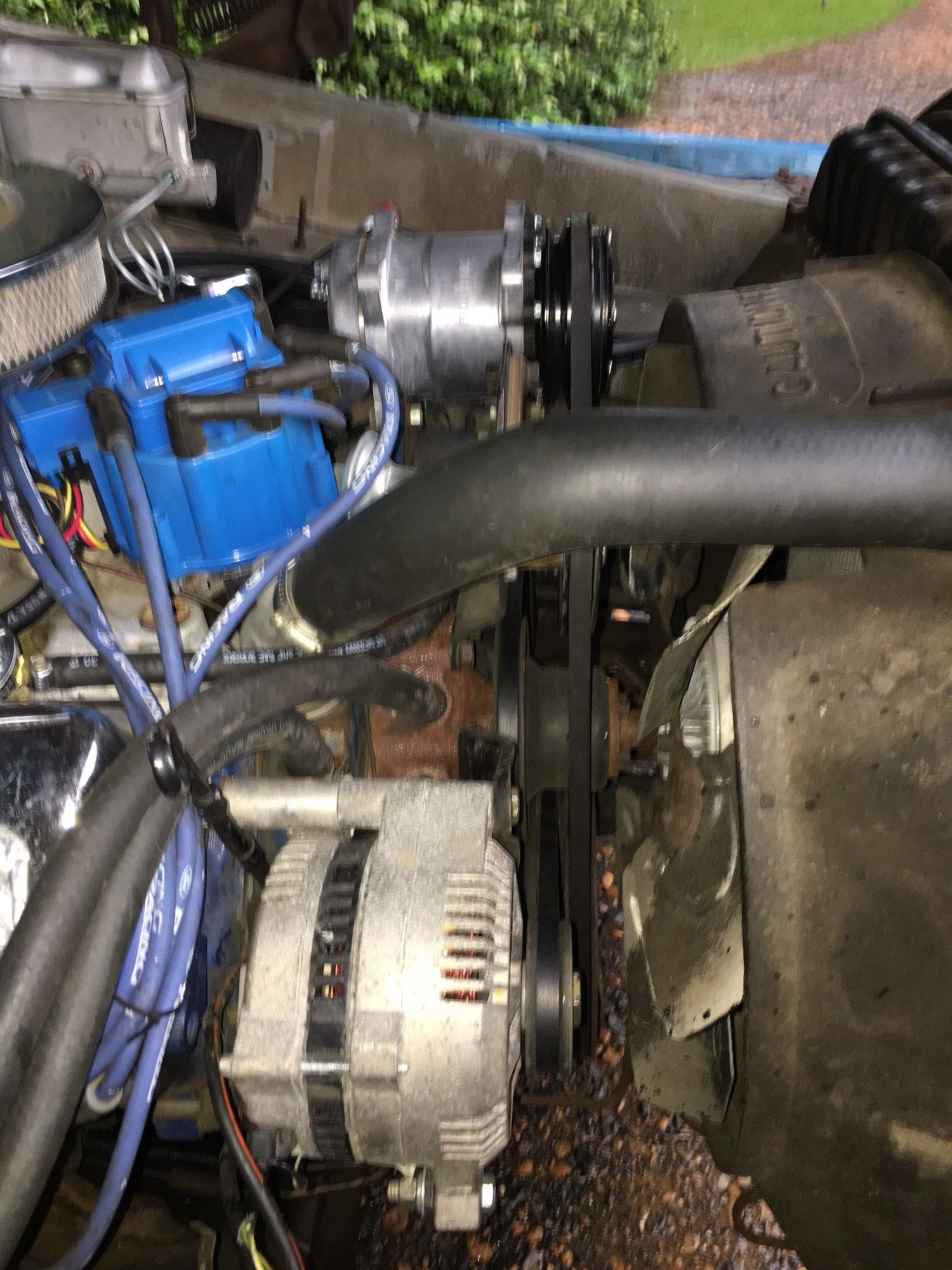

I initially had a smaller chrome pulley on it because it allowed for more thread on the nut. I couldn't get it to stop squealing, so I made the original, slightly larger pulley work. It improved things, but I'm not comfortable how much tension I have to put on it to minimize the squeal.
I thought about a dual groove pulley, but I can't figure out out how to make it work. Here's my 3-belt setup, going from the engine forward:
1- crank, water pump, power steering pump
2- crank, alternator
3- crank, tensioner, AC compressor
I'm not sure how I could make it work without a lot of effort.

Got a pic of your engine compartment showing the belt layout by any chance?

I'm not sure I have enough room to push back my alternator to get it in line with the water pump and PS pulleys.
One thing I have working in my favor is my AC compressor had dual grooves, and they both would line up with a dual alternator pulley. I figure I could run one of these two options:
2 belts on - crank, alternator, compressor
or
1 belt on - crank, alternator, compressor
Not sure which would be better altogether, but it seems like two of the same belts would be easier. Then, I could get rid of the tensioner.

Yeah, I see what you mean. The 3G is all the way up against the head (or at least as close as you'd want it) and you don't even have multiple grooves in the water pump pulley.
With the non-stock compressor things might have been worse, but the fact that it's got a second available groove that might just line up is at least some silver lining. At least until you prove it can't work.
But it might be worth trying two ways. Looks to me initially as if your inner groove is not usable because any belt trying to go all the way over is going to run afoul of the a/c idler anyway.
But that idler is maybe a gem in disguise. If your dual groove alternator pulley just happens to push the second groove out in line with the A/C belt, you might be able to use just the single longer belt over the a/c, crank, idler and alternator.
The idler actually would be able to help keep traction on the accessories.
The dilemma comes if the crank pulley groove for the existing alternator belt is a different (smaller usually) diameter than the one for the a/c. You can't drive a single diameter pulley from two different diameter drive pulleys. Just leads to slipping from another source.
You do have kind of an odd assortment there, without a multiple groove water pump pulley. But it does look from here like your pulley grooves are all different diameters at the crank. That correct?
So yeah, not going to be easy. Things would have to be re-oriented all over the place and likely it's not worth it. Or it might be if your squealing is bad enough.
I know I hated mine!
Maybe you can be the first to do a retrofit serpentine setup to one of these engines. I've got two different Ford setups in my garage but have had zero time to see what it would take to make them work. Before the folks got old (and sick) and I was spending most of my days and hours being with them, I had visions of making a setup for the 351M/400 engines using a combination of custom and factory parts.
One of those things that is going to keep getting put off until that other, way more important "job" of mine isn't as needed.
Good luck!
Paul

Two belts on crank, compressor and alternator is a well proven setup. OE engineered in many cases. Can you push the AC compressor forward and make it work?

Still has the size issue. Not a personal problem of course!
The different sizes between the crank sheaves is going to cause an issue
Not having a dual-groove idler is going to be an issue if the longer belt solution is used.
Possible alignment, but that's the easiest thing to fix usually.
If used with only one belt from the A/C and the other drive from the crank pulley, then the only thing to contend with is having a crank pulley with equal diameter grooves.
Ford probably has 200 different pulley combinations over the years. Of course, that would narrow down by hub size, pulley depth and bolt pattern, but even at that there are probably 20 applications to search through on the off-chance you could find one.
Not sure NumberDummy's database is going to include pulley specifications, but if it does, that would be a huge time saver!
If you were lucky enough to find the right crank pulley then, one belt could come straight from the crank like it does now, and the second would run around the compressor, idler and alternator and back to the crank.
But without a part number, or a big-buck aftermarket conversion option, hunting the yards and suppliers of old used pulleys could take a long time.
