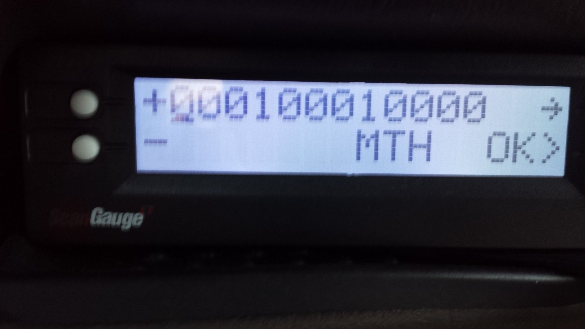

You are e first person I've seen get
​​​​​​​a misfire count from SGII FOR a specific cylinder
will you post the code you used to program
​​​​​​​Is the count still there upon restart of vehicle??
We had talked about someone forcing a misfire to see if it worked but I don't think it ever happened

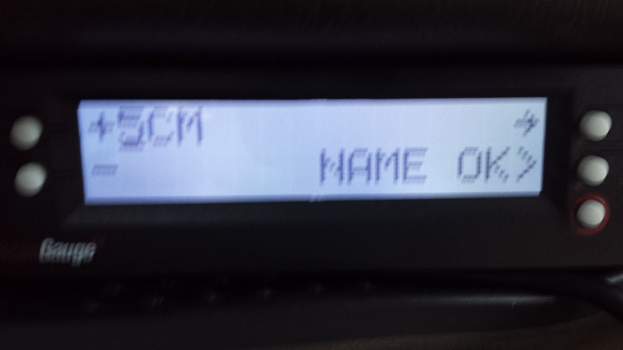

So do I win a prize? I will get the code I used to program it in the morning direct from the device and post it. You know, I did not check to see if it cleared when I restarted it. (I cycled to other gauges once I determined 5 was the culprit )
​​​​​​​I will check that too.

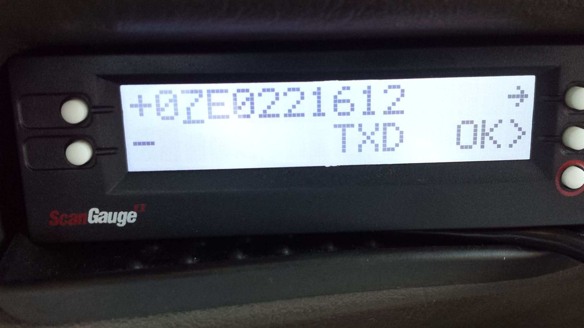

Here's the code ai used. The count did dissappear upon restart.
Old Aug 21, 2017 | 12:58 PM
BLADE35's Avatar
BLADE35
Joined: Apr 2010
Posts: 19,073
Likes: 243
From: Saratoga Springs,UT
Thanks just what I wanted to know
