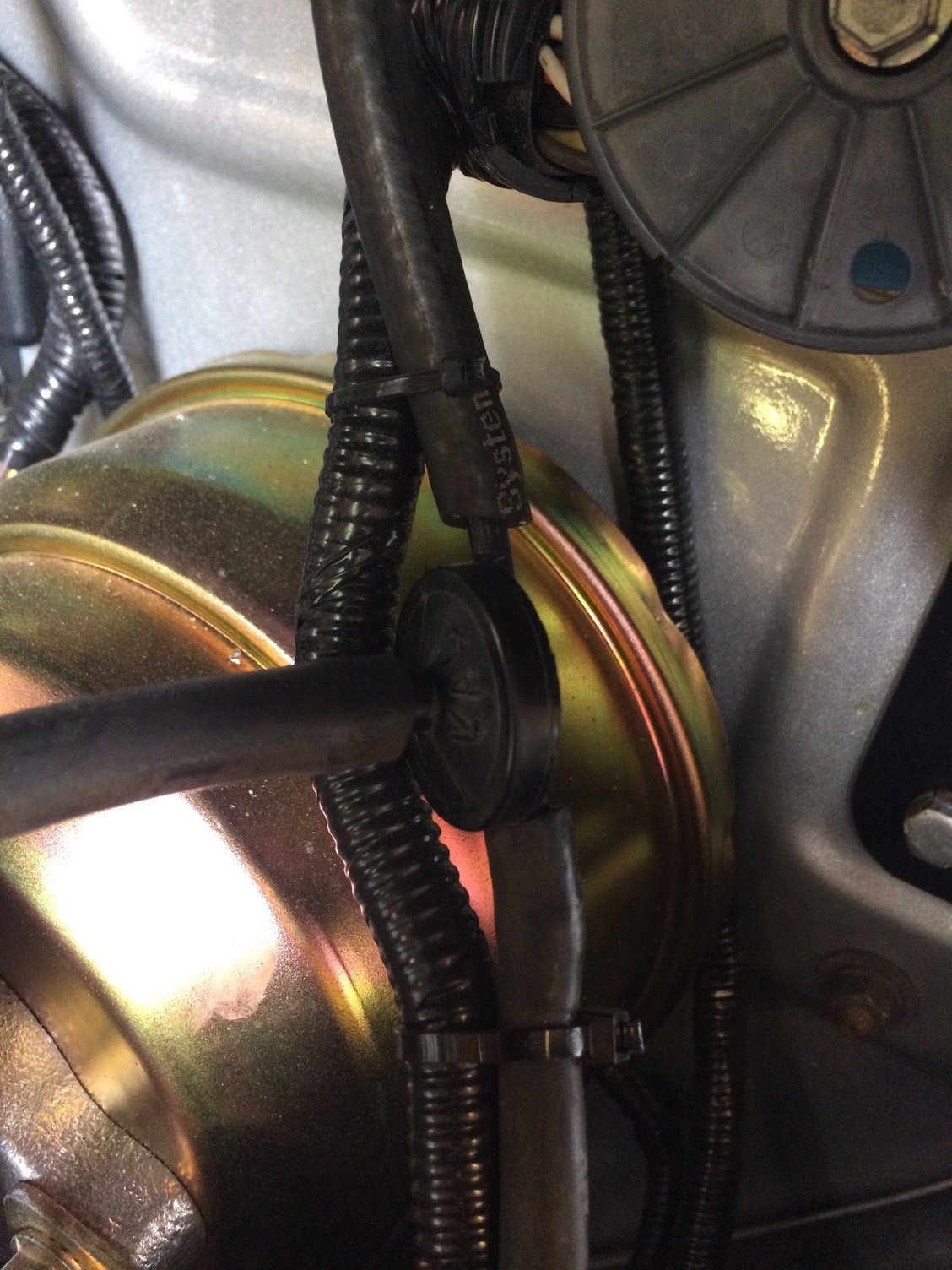

The vacuum canister I used has a check valve built in. The clear line from the check valve goes to manifold vacuum. The small orange line goes to the wiper motor and the larger black one goes to the power brake booster.
Mounted on LF inner fender
