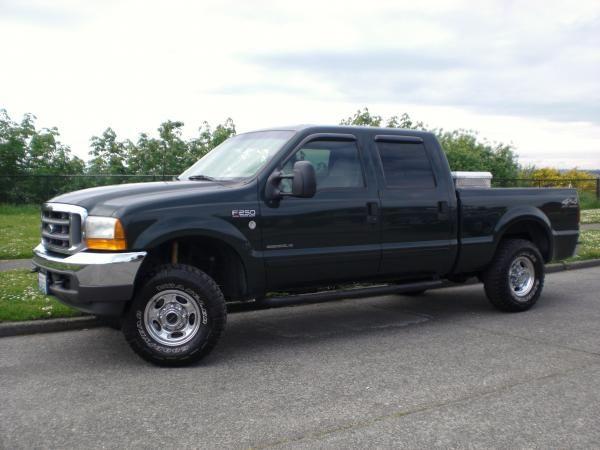

Originally Posted by binuya
I run 285/75-16 Michelin LTX MS2 10 ply on the Lariat rims, and could not be happier. With our camper fully loaded and pulling our boat, I am at around 16,000# gross combined weight. No discernable tire squirm at all. The tires perform so well, they're the least of my concerns. At highway speeds, lane changes, braking, surface irregularities and the like, are all handled with complete confidence and ease. I keep them at 80psi when towing heavy. I also have air bags, and keep those at 80 as well. Hard to imagine it could be better.
Are they the original Lariat rims? Got a pic? Thx
Old Aug 4, 2017 | 11:20 AM
binuya's Avatar
binuya
Joined: Nov 2008
Posts: 1,573
From: Seattle
Yes, the original alloys. Here is a pic of when I first bought my PSD. It came with a brand new set of Goodyear Wrangler MT/R's and I couldn't wait to replace those things. Luckily for me, they wore down in about 20k and I got the Michelins.
F250 Superduty 002
