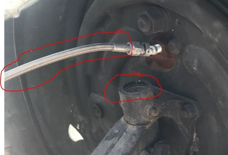

Welcome to the forum! You have your work cut out for you!
I see a couple of things that seem to be worth investigating.
Is this rod end really seated fully?
This is not what I'd expect for a kingpin locking pin. It could be like this on the bigger trucks, but I doubt it.
This kingpin is way down in the spindle, that doesn't look right... Maybe the spindles were adapted to a bigger axle? Both brake hoses appear to have almost no slack to accommodate turns.
