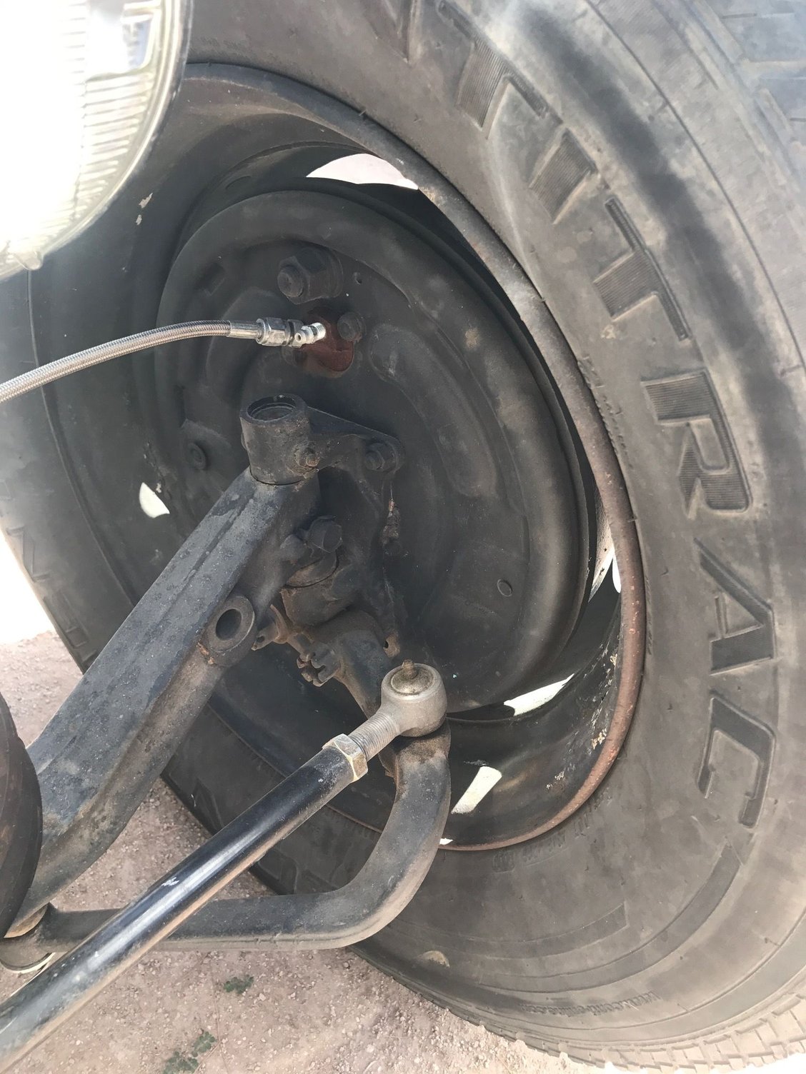

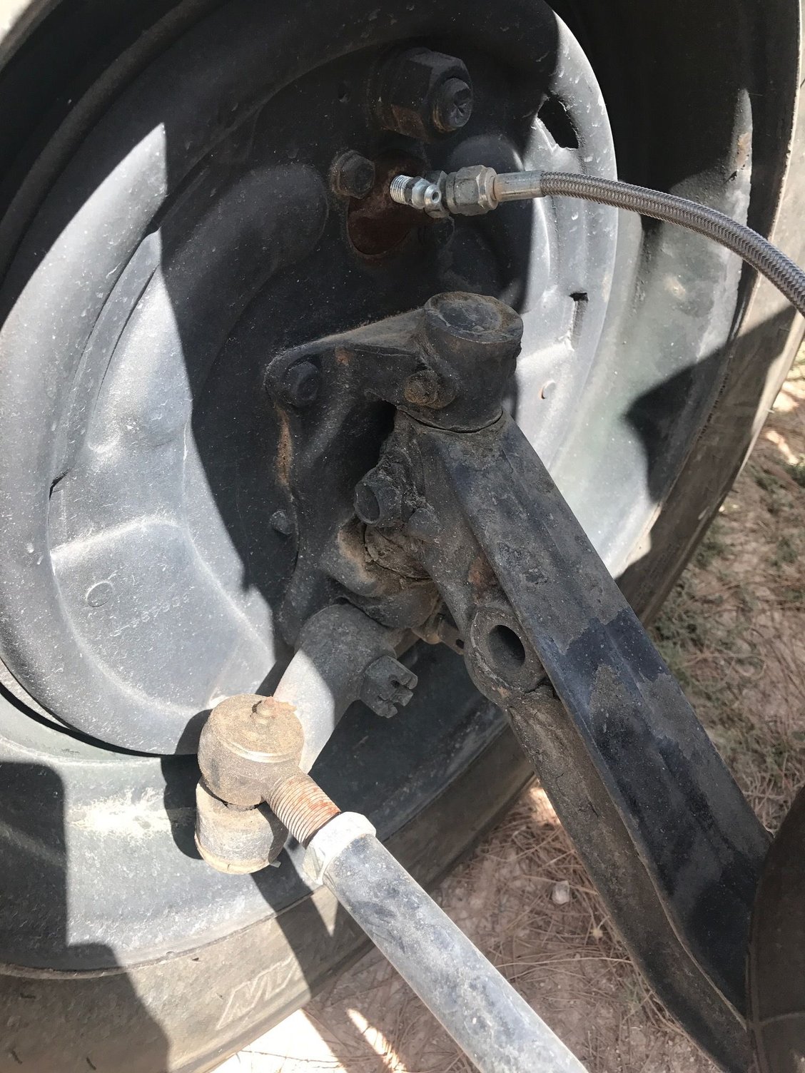

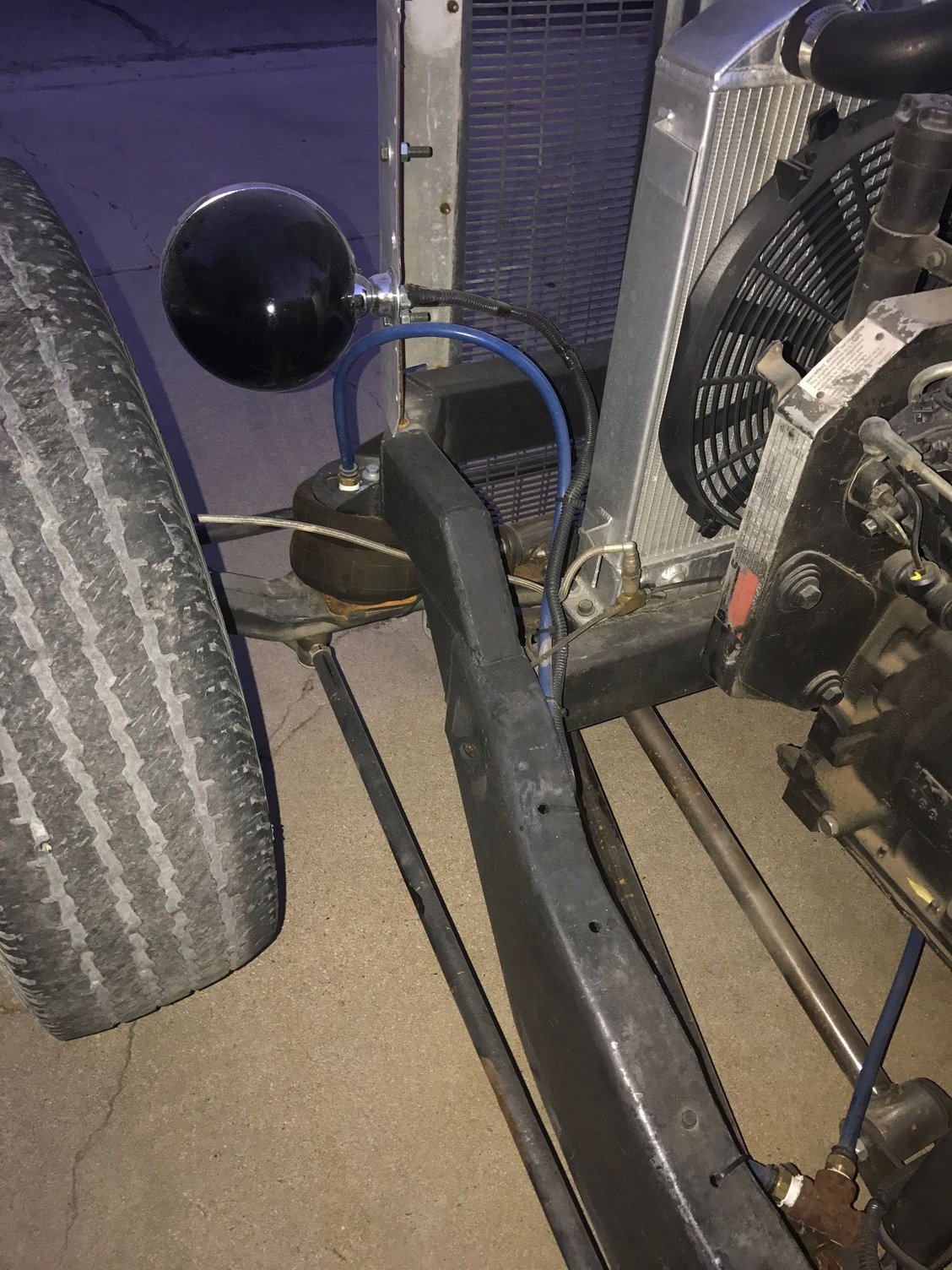

Hello guys, I am new to the site. I have what was believed to be a 1946 F5 ratrod truck. I recently wanted to convert to disc brakes but after further review im learning the F5 didn't come out till 48. the front half of the truck is stock framed other than being air bagged. it is a 6 lug which leads to believe it really is an F5. i cant find a disc brake conversion kit for the F5 so i was wondering if the spindles are the same from an F3 (5 LUG) so i can go that route? any help in identifying?

Trucks like this are hard to sort out. I see an F-5 badge on the door hinge panel, and, unless I'm seeing wrong, the cab looks to have a big back window signifying a 51/52 cab donor. (Edit - maybe it is 48-50, I'm changing my mind.). You might post more pics. The frame is anybody's guess. There is nothing I see that is Ford F-3. That would have 8 lug hubs rather than 5 lug.
What I am comfortable saying is that the 6 lug x 7.25" pattern tubeless wheels came from either a Ford F-350, 1956 to 1966, or similar Dodge or Studebaker. The fronts having six hand holes are Budd 71320s while the rears having three hand holes are Budd 79120s. They are 17.5" x 5.25", and appear to have metric radial tires that look too wide for the rims. The truck that donated the wheels probably also donated the front axle and hub components. I see a number on the backing plate in one picture that follows no Ford numbering sequence, and no Studebaker sequence that I've encountered. Might it be Dodge? I know that a member of the Studebaker Truck Talk forum has been attempting to engineer a disc brake system for their 6 x 7.25" bolt pattern hubs, but have seen nothing recently to show he's making progress on that. Stu

I see some iffy stuff going on with that front axle assembly. I'd go over it really well and check for things that might cause some safety problems.
