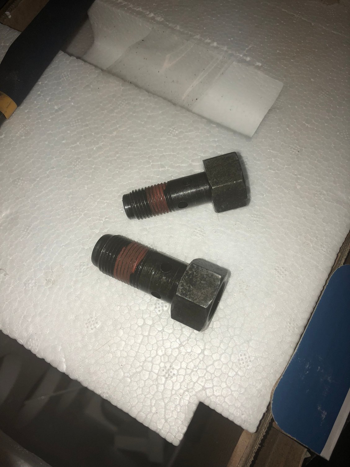

Does anyone know what size and thread pitch the bypass fittings are? I just rebuilt my bypass valve and it looks like I’ve buggered the trans case threads on the front port. The front fitting mics out at .518 and 13mm is .512. The rear fitting mics out at .650 which is 16.5mm. My thread gauge says they’re 1.5 thread pitch, but I want to make sure before I cause more damage.
