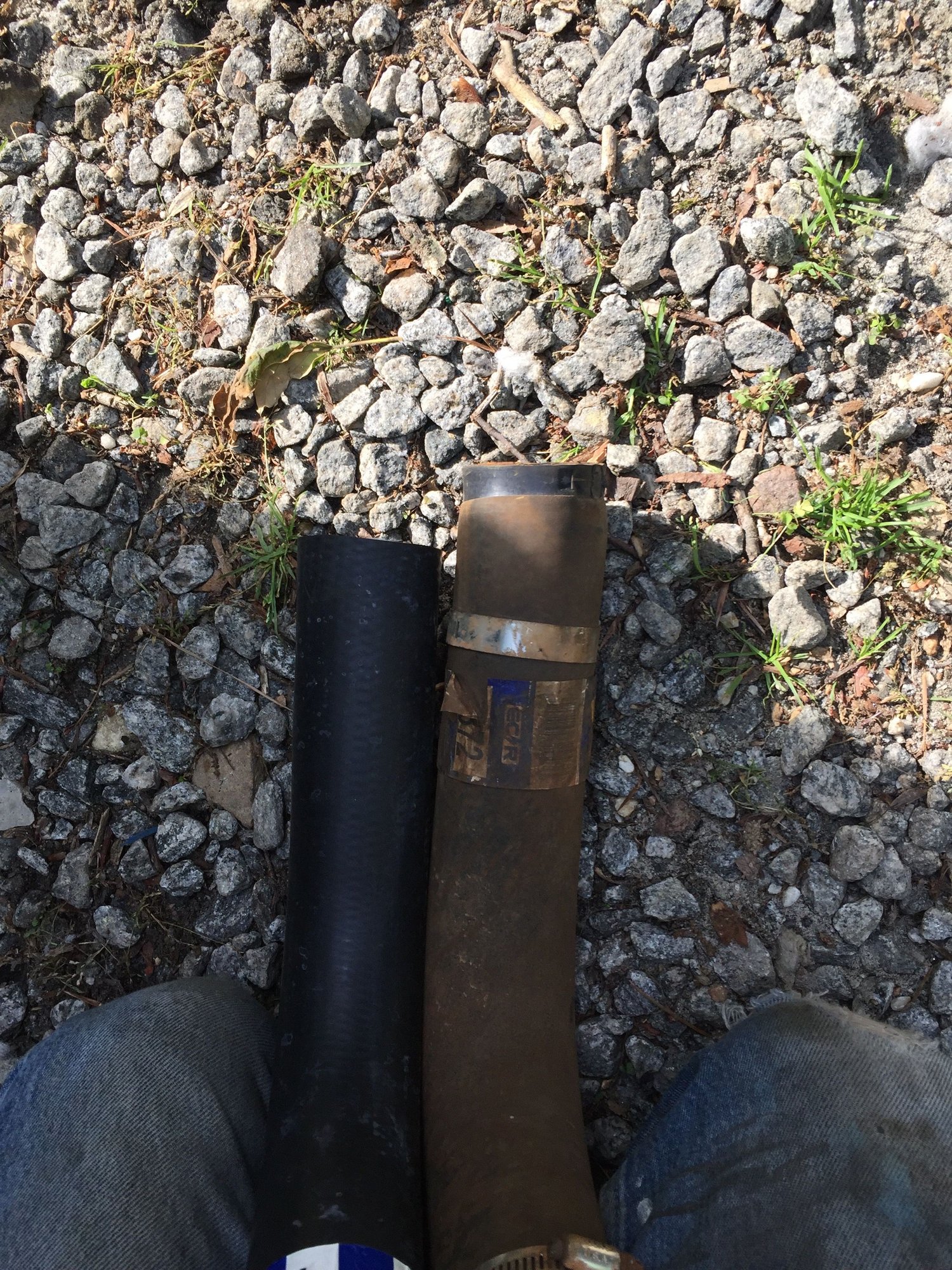

Hi, I bought a radiator some time ago. I attempted to fit it today.
With the new radiator the original OEM hose is about two inches too short for the new radiator.
Have any of you had the same issue, did you buy a different bottom hose, if so what was the part number or any other ideas? Thanks,

When I've bought radiator hoses at either O'Reilly or AutoZone, they were too long and had to be trimmed. Sorry to be of no help

AZ has a too long 2" inner diameter 90 degree bend hose (part#: E70739) and you can just cut to size. did this just a couple days ago.
Note: you will have to cut from both ends.

I'm not seeing vehicle specs via my iPhone. I went to replace a gates 7372 hose on my 460 and the new hose was too short.
Went with an 8076 and just cut it down.

Thanks guys for your posts. much appreciated. I'm stuck here in Australia and getting parts is a pain, no where near as good as US and expensive. I have heard the name Gates bounced around. Hopefully its the same company. I will look to see if I can get the 8076. I think it would be a better solution all round. Than fitting an extender of some sort?
Thanks! I would never have known about the possibilities of different lengths.

Hi, thanks. Couldnt get the 8076 or anything longer in Australia.
I went to the local exhaust center and they cut me a piece of 2" tube about 6" long. They flared the ends for me too and they never charged. So that was a big help.
I have put it on and tested it briefly and it seemed ok. I will have to keep my eye on it to see how it goes during a drive? (Hope I don't jinx myself).
