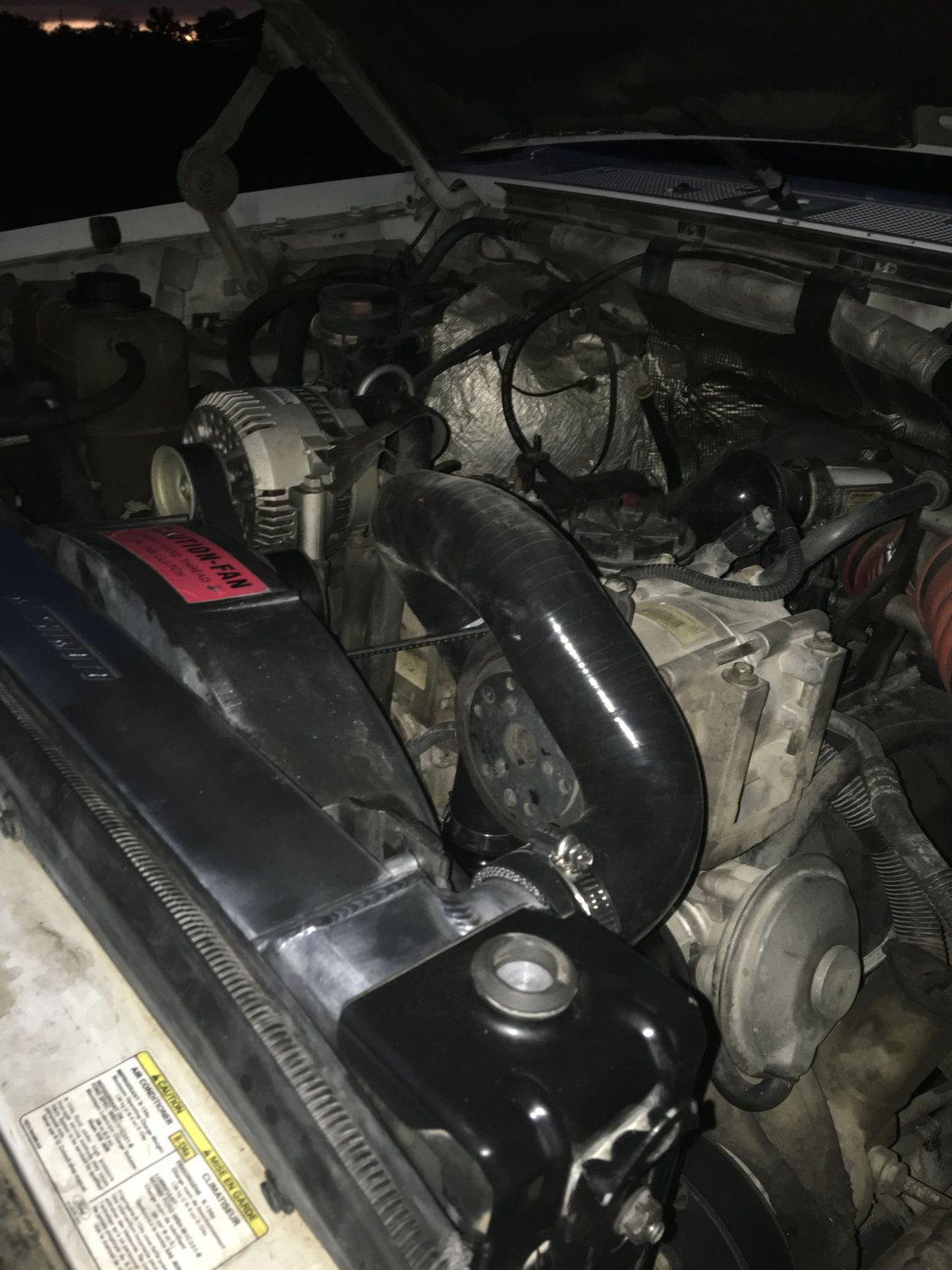

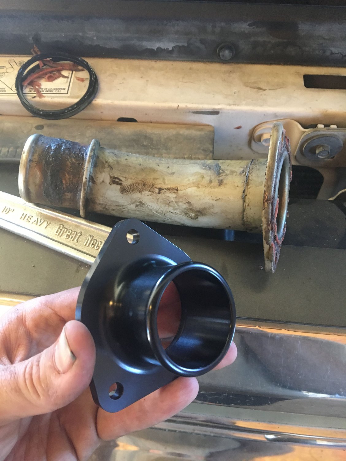

OEM radiator cracked (see pic) and replaced it with Mishimoto. Also replaced the upper hose with dieselsite silicone version, billet housing and 203* thermostat. New up-pipes are next.

The only bad thing about the short neck and the SD upper hose is to change the belt you have to remove the hose
Still goes over the top on the OBS. Or am I missing something?

Nope, they updated there hose
Our OBS hose has always been this design. We only sell it so customers can use the housing in their 1995-1997 and it has always gone around the belt.
The hose we sell is a custom design. It is not a stock hose from any vehicle model.

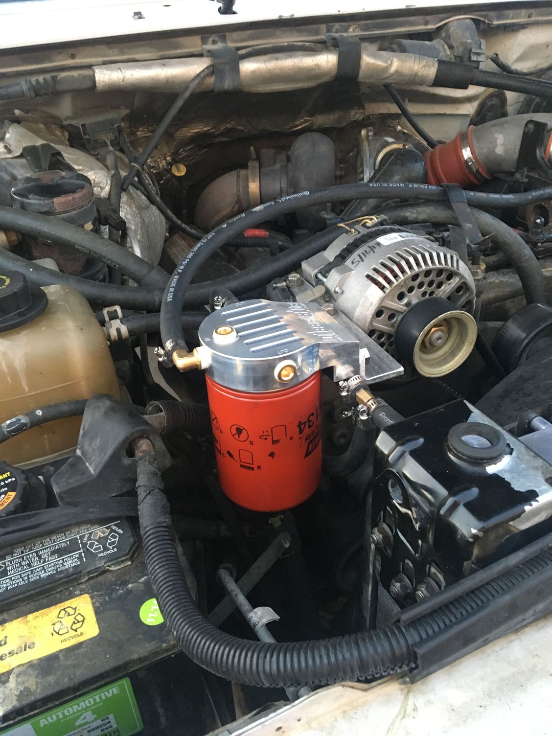

Slapped a dieselsite coolant filter on for chits and giggles.
it should be dirty by now. Mine was full after 1000 miles and I had flushed the heck out of it before.
