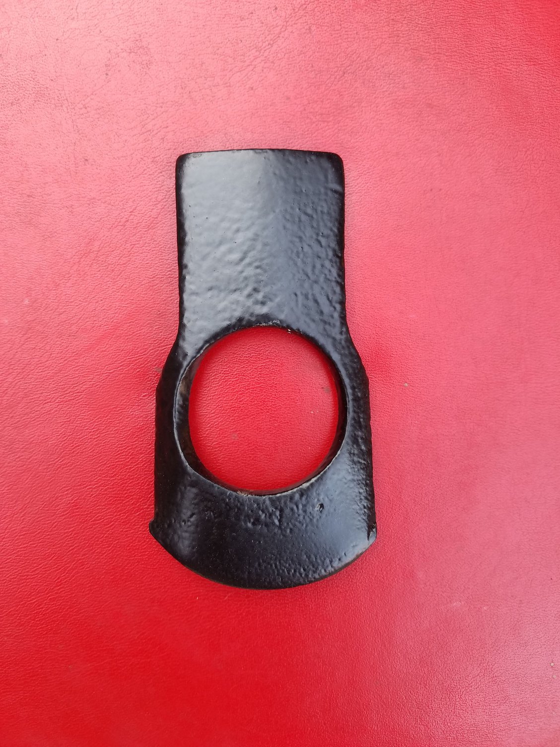

A "shim" between the radius arm and the lower coil spring seat. I've seen exploded views where these are for '65-'69 but not '70-'72. Mine is a late model '69 and had a shim on the D side and no shim on the P side.
I installed chassis tech drop beams and the D side coil is just kissing the beam so I'm thinking I ought to use shims. Since I only have one and doubt I'll get another does anyone see a problem with just making one?

I've seen parts catalog exploded views where these (basic part number 5355) are for '65-'69 but not '70-'72 or 1973/79. Mine is a late model '69 and had a shim on the D side and no shim on the P side.
Look up the basic part number in the text, and...
AR=As Required) C5TZ-5355-A .. Front Spring Shim / Obsolete
1965/73 F100/250 2WD
MILLER OBSOLETE PARTS in Binghamton NY has 2 = 607-722=5371.
NOS PARTS LTD in Waxahachie TX has 3 = 972-937-2201.
KLIMESH MOTOR SALES in Calmar IA has 4 = 563-562-3241.

As a follow up I never purchased additional shims. These appear to my eye as being a level or camber correction part and if anything mine needs to go lower to correct for positive camber.
I'm now entertaining an adjustable height coil seat set coupled with shorter coils instead.

I was just wondering if anyone has any ideas on finding one of these shims. I know this is an old thread and I did try the places that were listed above but they did not have any.
Old Apr 12, 2024 | 12:49 PM
smoky_diesel's Avatar
smoky_diesel
Joined: Sep 2007
Posts: 2,470
Likes: 535
From: Chandler, AZ
Suggest making one. piece of flat bar with a hole drilled. or a stack of washers would work.
