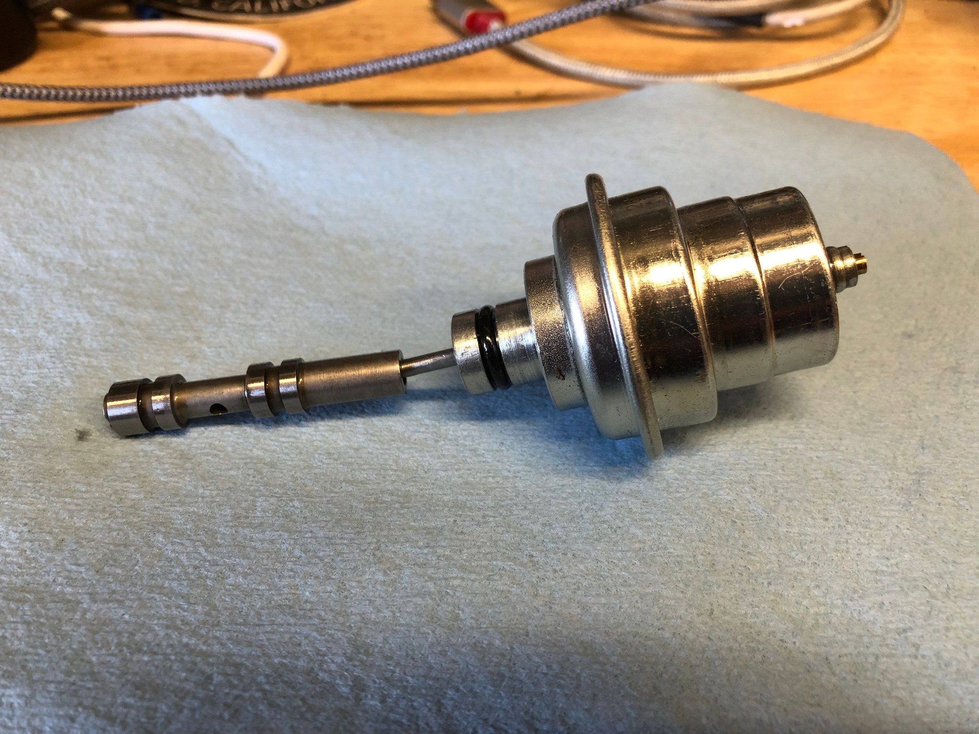

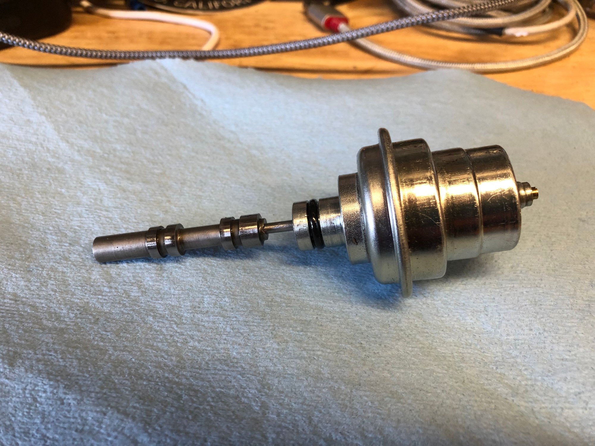

I do not know which way the adjustable pin on the left goes into the transmission. The bottom photo is how I installed based on diagram, non-shifting transmission. The 1.6 inch pin does go into the adjustment screw top photo. Can you provide guidance.
Old Nov 14, 2022 | 01:58 PM
Crop Duster's Avatar
Crop Duster
Joined: May 2015
Posts: 4,469
Likes: 965
From: Tri Cities, TN
Bottom photo is correct. You know there are two different diameters of the modulator valves, .434 OD, 64-69 and .372 OD. 70 and up. If your trans happens to be older than you think and you stick the small diameter one in it, it would be the same as not having one in it at all.
