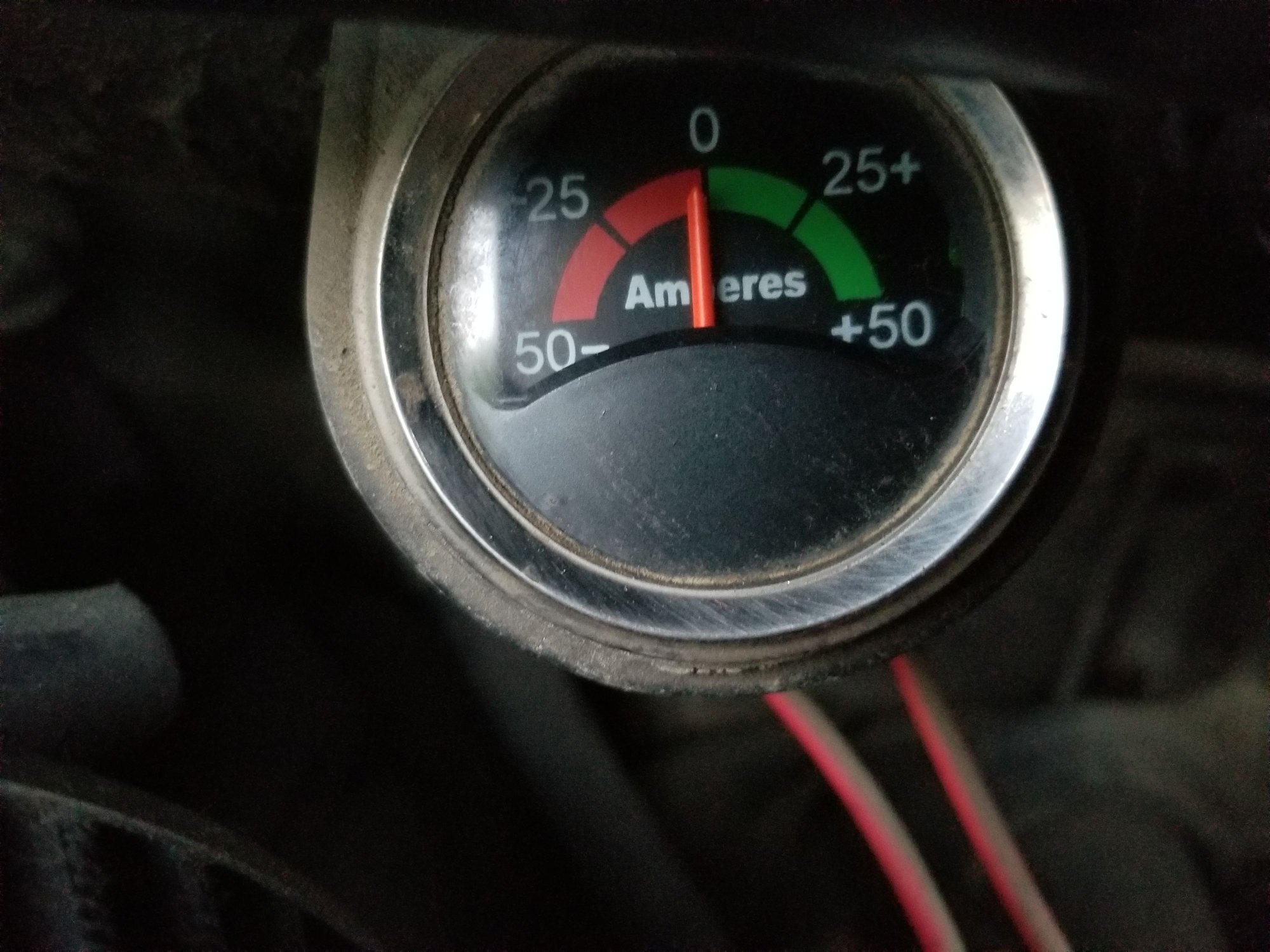

Alright guys, what is this all hooked up to?
So this is attached right under the hood
Here you can see the wiring. It dips below that but runs to the fuse on the right
Here is the fuse

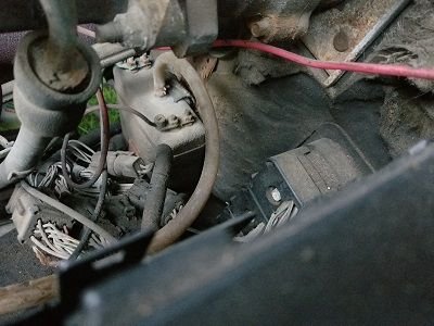

This box is the source of the clear tubing and a black ground cable that has an end just hanging out by the battery. Ideas?

Ampmeter is wired to a circuit breaker and feeding a relay, the black wire (terminal #87 ) Is the wire that powers the accessory

Yeah, it has been through a lot. I've got a lot of cleaning to do and I'm just going to assume I'll need a rebuild in the not so distant future. I'll have to figure out what the accessory is. I have a toggle switch in the cab but it does nothing that I can tell.

My guess is the black wire off the relay went to a water/methanol injection pump that has been removed.
Put a volt meter to it and hit the switch

Working on that. Just to be clear, that box in the pictures about that has the wire running to it and the clear tubing, isn't stock either? I'm pulling it all out later tonight. I've got a ton of work cleaning up the bay so might as well start there.

There is no clear tubing under the hood of my truck. I can't really see that last picture very well though. I think you went a little overboard on the resizing.

Lol, oops. Well I went ahead and redid it and circle the box. It is pretty far down on the firewall on the drivers side. If it isn't anything stock, I'll pull everything going to it. Just a couple wires that I havent traced yet.

With that larger picture I am seeing wires going to that tank, can't tell for sure but it looks like a red wire covered in grime and possibly going to that replay.
I still guess the previous owner made their own water injection setup using that tank with a pump in it ?
Either way it is not stock.
