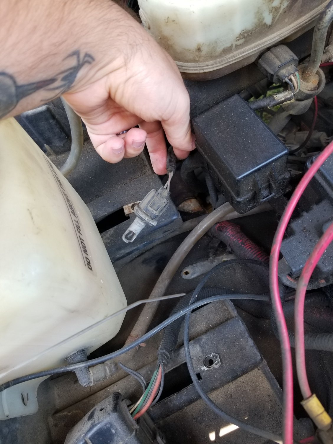

What is all this?
What the crap is this?
And what is this clear box with clear tubing? It says don't overfill but the tubing is connected to the air filter

That sensor is the intake air temp sensor that is suppose to be plugged into the air box.
Speaking of air box.... first thing first....get rid of that ricer air filter.
Best filteration available is the Ford-Donaldson AIS setup.

So I can pull all that plastic tubing crap too? Cause that mess looks terrible.

It is sitting where the factoyair box goes, what ever it is it is not stock.
