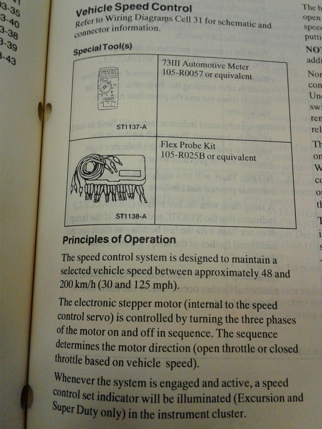

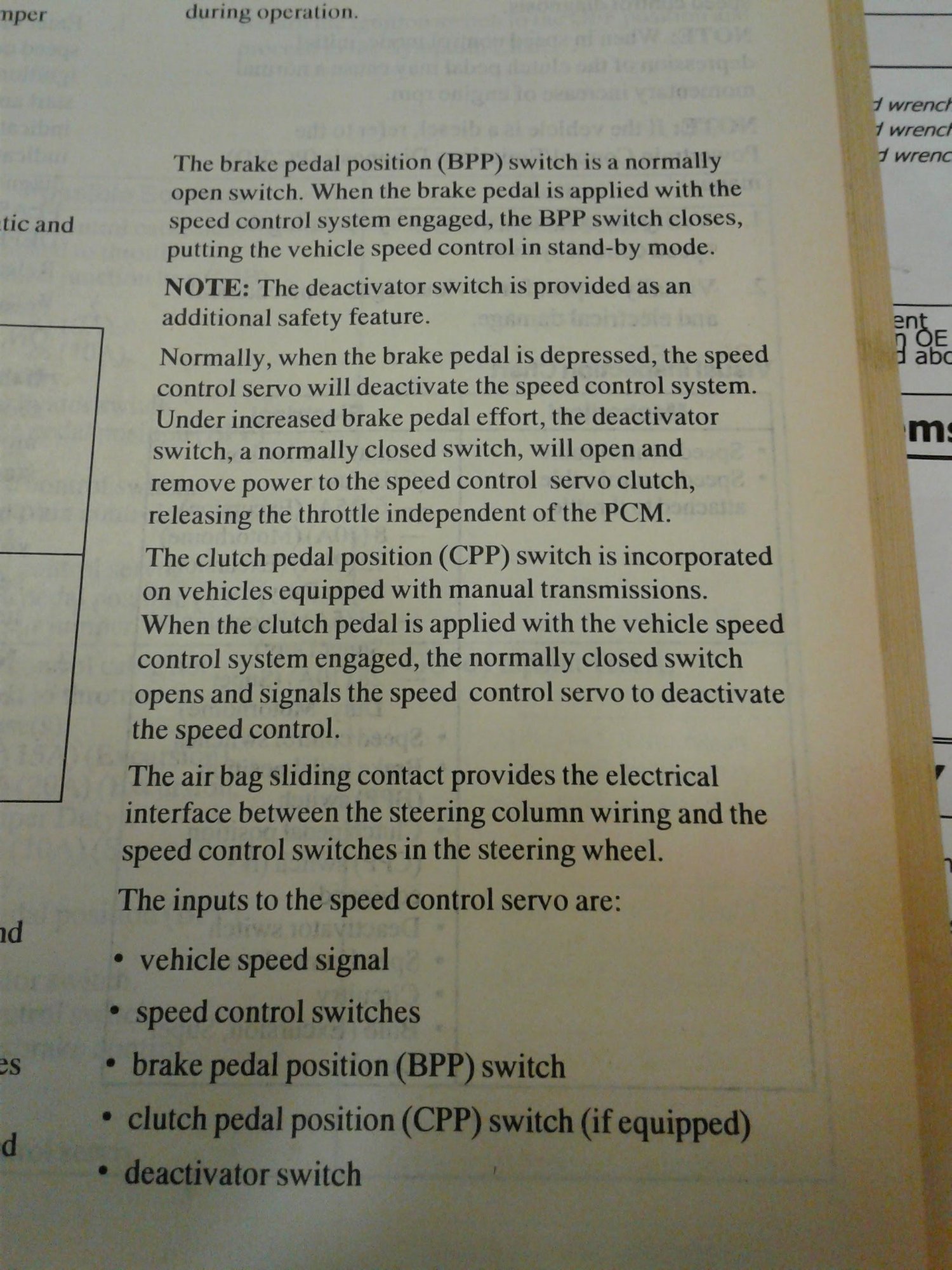

You need diagrams?

I can post the pinpoint tests if you know which one you want.

WOW! I'm going to have to digest this first. Thanks!

One bad ground can throw the whole system off. Check the grounds first. You can do this visually, but it is best to do it with a multi-meter from the plug.

I also had an issue with the switch under the brake pedal. It was replaced, and the cruise worked immediately after. If the brake light works is that switch OK?
