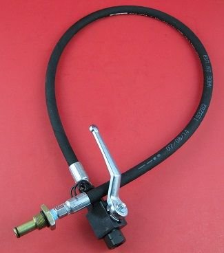

I put 100psi of air at the hpop. I did this by using a ipr air fitting. I couldn't hear any air leaking with a stethoscope. I'm going to do it again with the valve covers off. I'll post tomorrow after I try that.

I am attaching a link to a post from JenC of Diesel Site. There is an interesting bit of information on testing the HPOP using air:
https://www.ford-trucks.com/forums/1...l#post17270486
My takeaway from the post is to "not" pressurize the pump using air.
When conducting the "Cody Test" to make sure that the injector o-rings are sealing properly, which is what it appears that you are trying to do, isolate and ONLY pressurize each head individually at the high pressure oil fitting hole that services the oil rail, as Larry stated above.
FWIW, the pump in that thread is also a T500.

Heres what I was using to do the air test. Not sure if that what JenC was referring to by blowing out dust. But I am going to test the air at each head. Just waiting to get my pump back from Joey.
