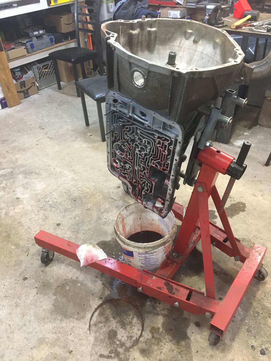

FYI, if the case is vertical, it's easier to load the guts into it. If it is horizontal, it's easier to get the valve body installed. Keep that in mind.
I used an engine rebuilt stand and made a dedicated mount just for the E4OD. It worked out great.
ok thank you
good idea

1Butcher's Avatar
1Butcher
Joined: Mar 2007
Posts: 2,811
Likes: 1,022
I have fixed Mercedes since 1988. I made a lot of money doing that. Enough to retire at 52. Now I just have a small one man shop and fix Mercedes/BMW.
When I made my mount for the transmission, make certain the tail shaft is not going to hit the base of the engine stand. If you have an engine stand, you seem to have the skills/material to make it. A welder and steel is all I used.

X2 on the engine stand. Makes life a lot easier.
