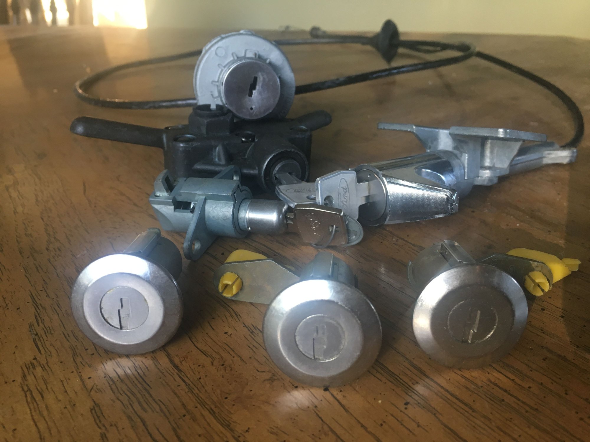

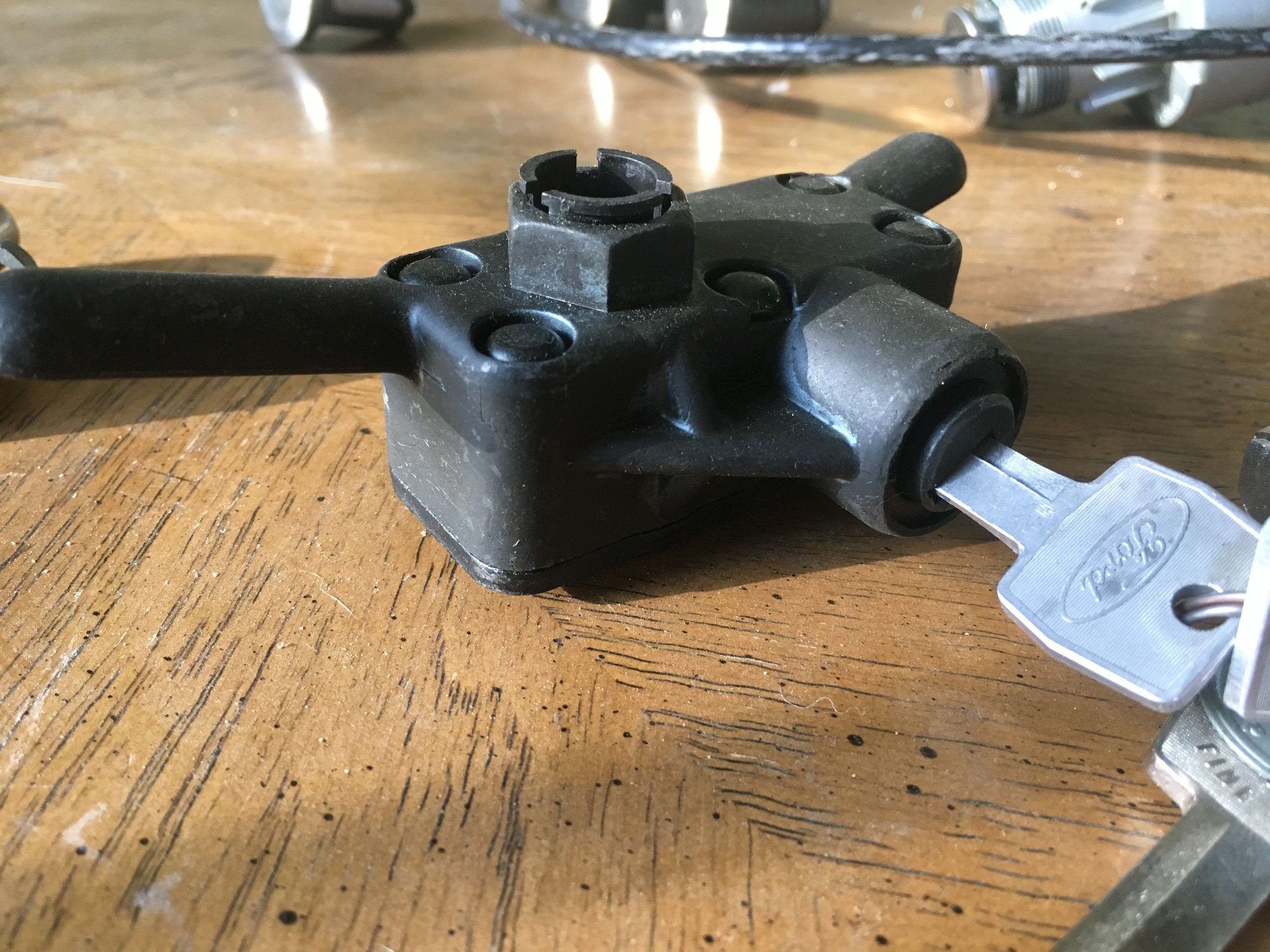

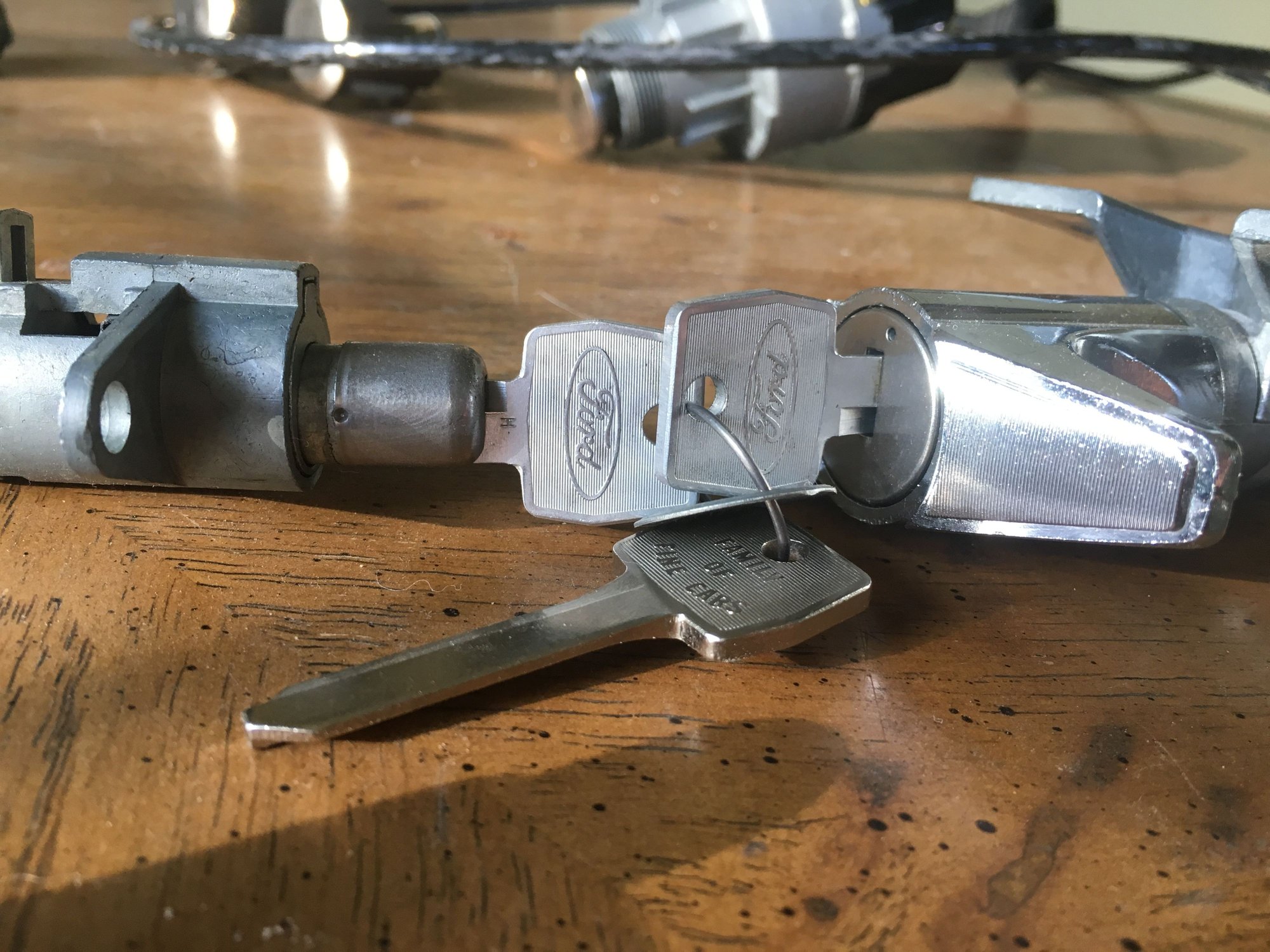

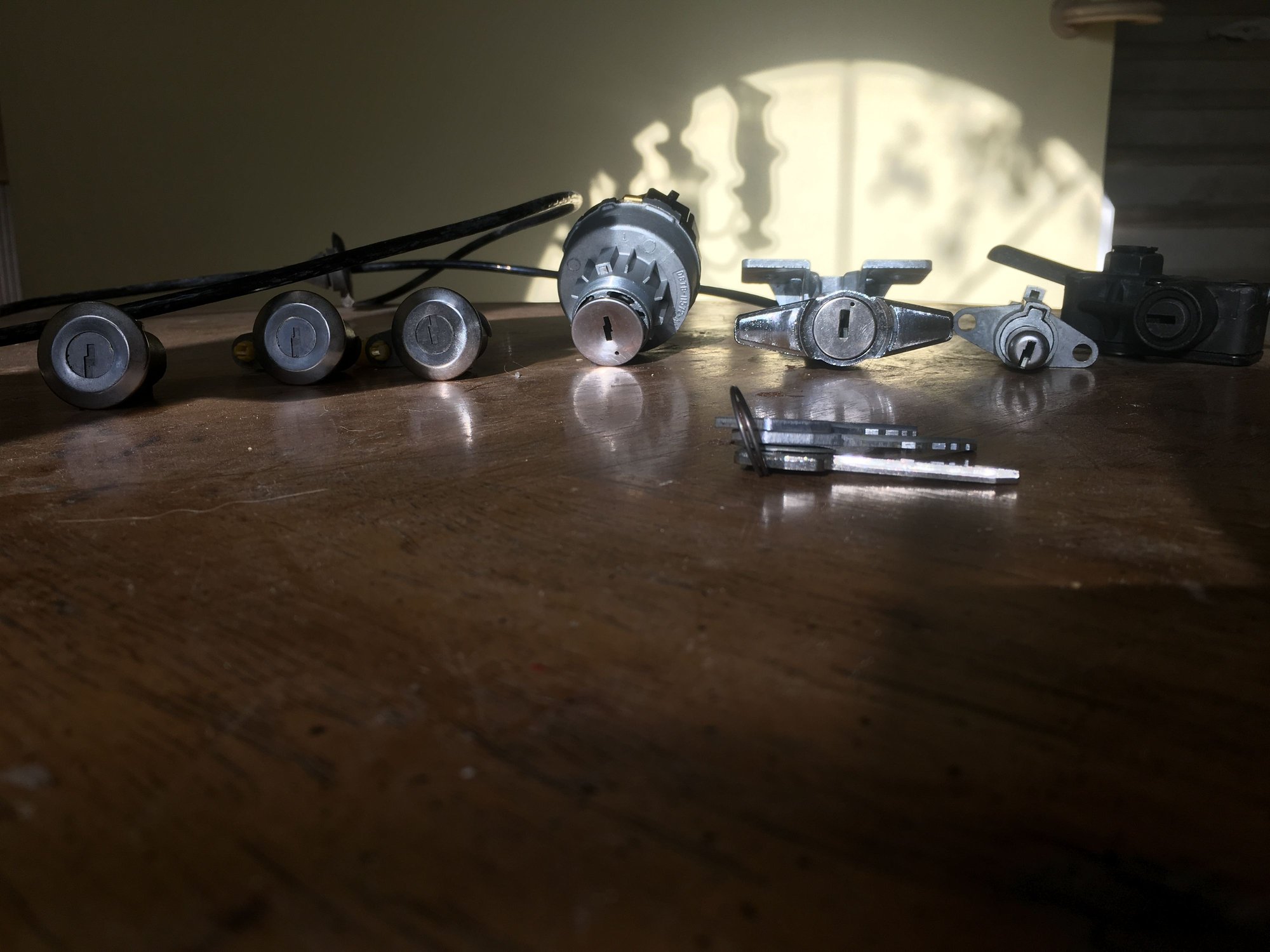

All in one factory sealed Ford kit except for the switch and handle which I have assembled. (Bronco):
All these locks except for the spare tire lock can be re-pinned to match your existing locks. The glove lock uses three of the five pins and take the same pins. Hood release uses four wafers and can be re-done to match if yours does not. Bronco tailgate uses same pins again.
This set may be the last NOS set that existed. But like I said, you can make your own keyed alike set wits some spare-parts-locks and a few hours. I already have another set that I matched for another bronco.
The tool box lock is a different key and any locksmith will be able to make you a key for one. Some are disassembleable, some are not. Some have a "keyway door" some do not.
