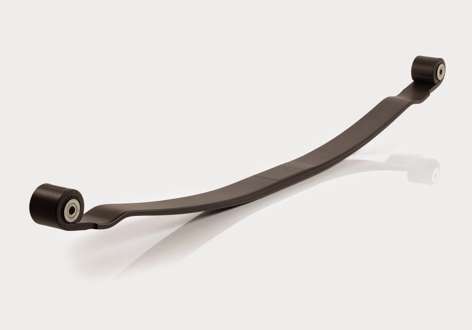

The other approach for this is to Order a new parabolic main leaf that would increase your rear GVW 2000 pounds and keep your comfy ride.
