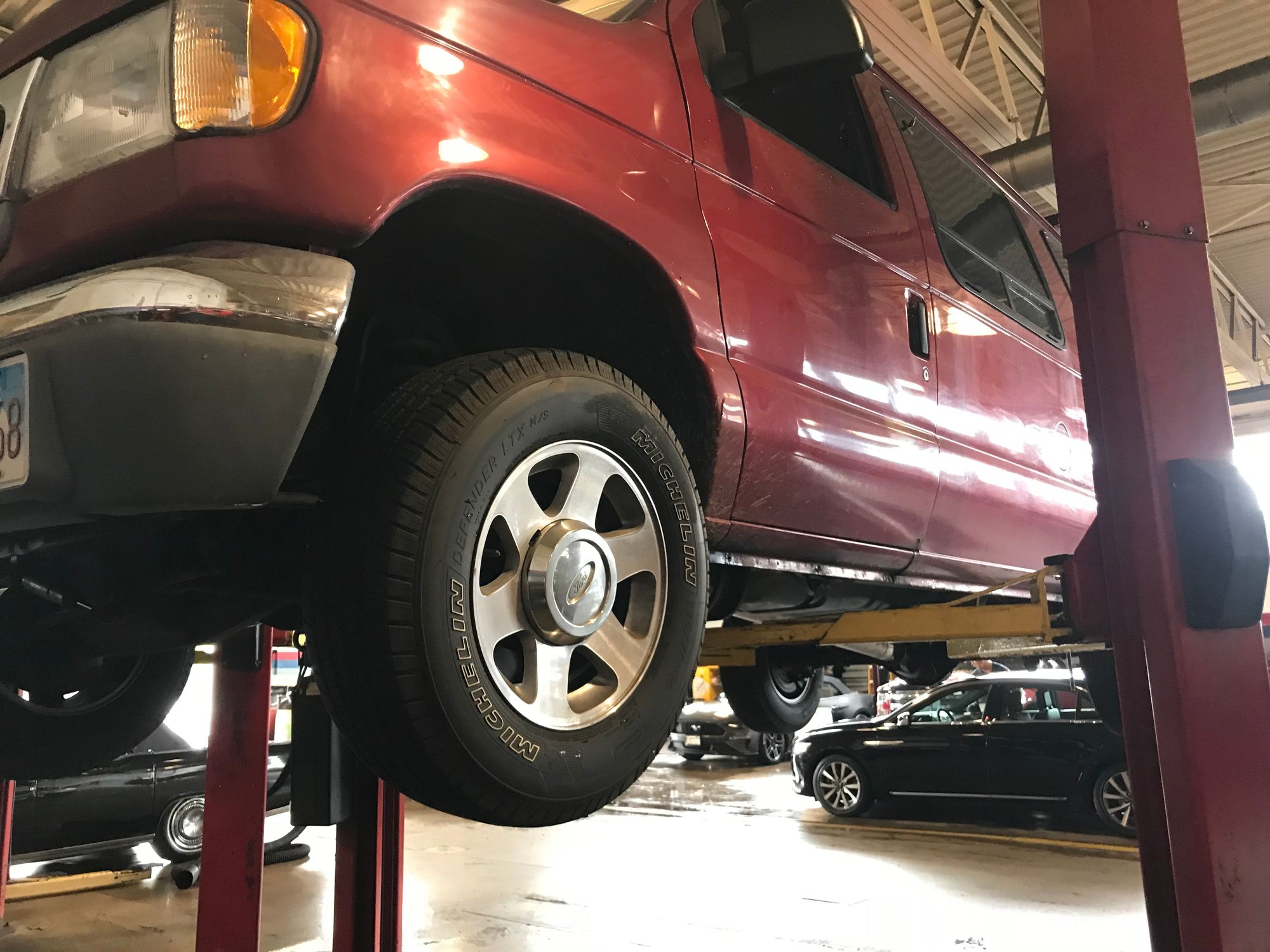

Here are the 16 inch Ford wheels. If you choose to do this upgrade you can pick aluminum or steel wheels.
