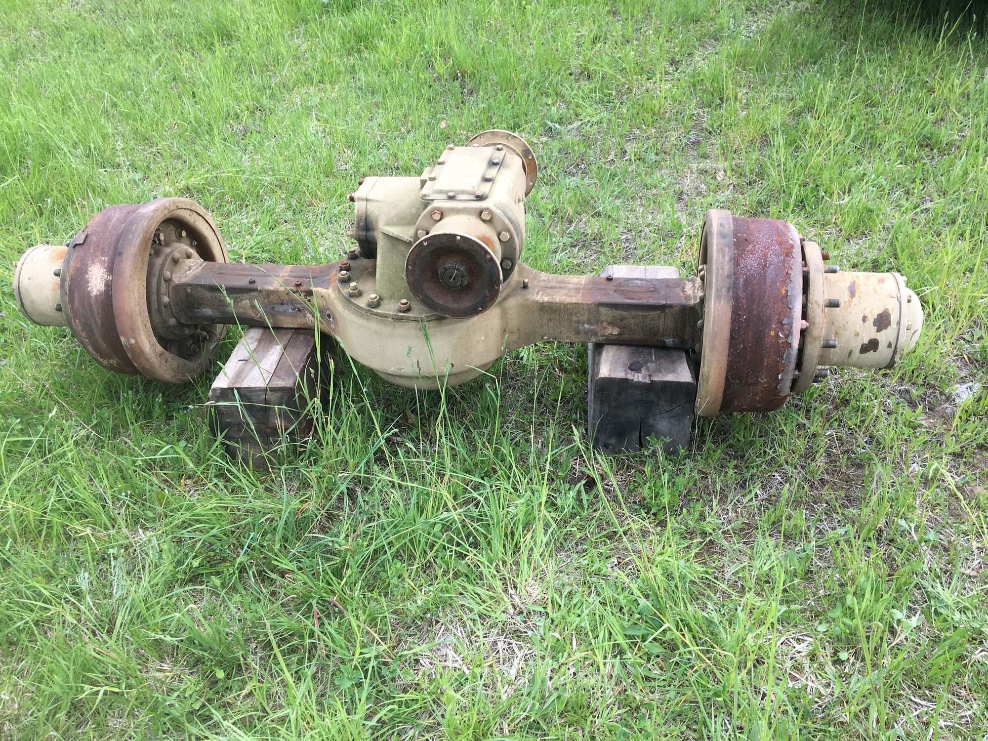

So I recently purchased a 1947 Ford Heavy Duty with an 8BA flathead v8. I am planning on putting a 1937 cab on the frame that has been sitting in a sinkhole on the family property for the past 40+ years. I am also going to build a flatbed for the rear of the truck and decided that I want to swap out the current 2-speed rear end for a 5 ton rear end out of an 800 series military truck. I am also looking at picking up a 5 ton front end out of an 800 series truck and a 2.5 ton transfer case in order to switch the truck over from 2wd to 4wd. My biggest concern is with the steering. Is it possible to convert the steering on the '47 to a more modern type of steering or am I going to have to do some fabricating? I know that some fabricating will be involved but want to limit the actual amount needed to a minimum. Also has anyone else done this before? If they have pictures would be much appreciated.

Are you seriously going to try to make a flat head turn those differentials? It took a Cummins 250 (I think) to turn them in the M800 series. Found it.
That would take some kind of magic gearing wouldn't it?

How much more different can it be for a flathead to turn an axle with 6.44 gears vs the current 2-speed rear end with 8.80 and 6.40 gears? I would think the biggest problem would be you can't put as much of a load underneath the truck because the truck wouldn't be geared for pulling the maximum amount. But I wouldn't really be using it to haul anything, more for show and a mud bog here and there. As for the motor it should put of roughly 120hp being a 255 Mercury block with Ford heads that bump up the compression. I'm not expecting to go fast just want to build something unique. If it doesn't work I'll try to find an 8v92 or a 12v71 and toss that in the truck and save the flathead for another project. Could always make a flathead powered late 80's one ton. Have those trucks in spades.

I had a pair of those axles once and remember they were unbelievably heavy. Add the weight of tires and wheels and it might be too much for the frame without some serious stiffening mods, especially if it will be bouncing through the mud. The flathead might work but it will be maxed out all the time and probably won't last very long. Interesting build to say the least.

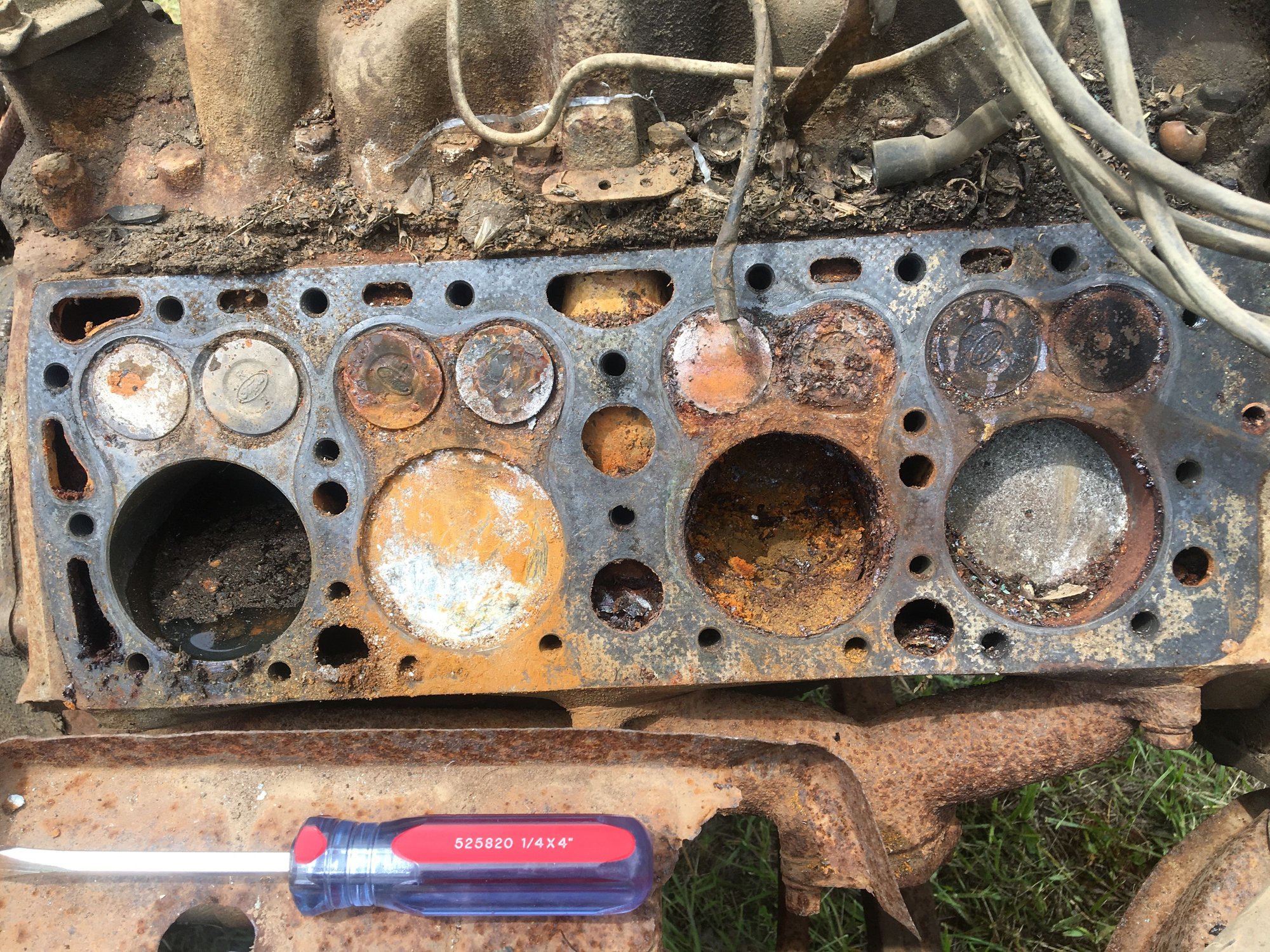

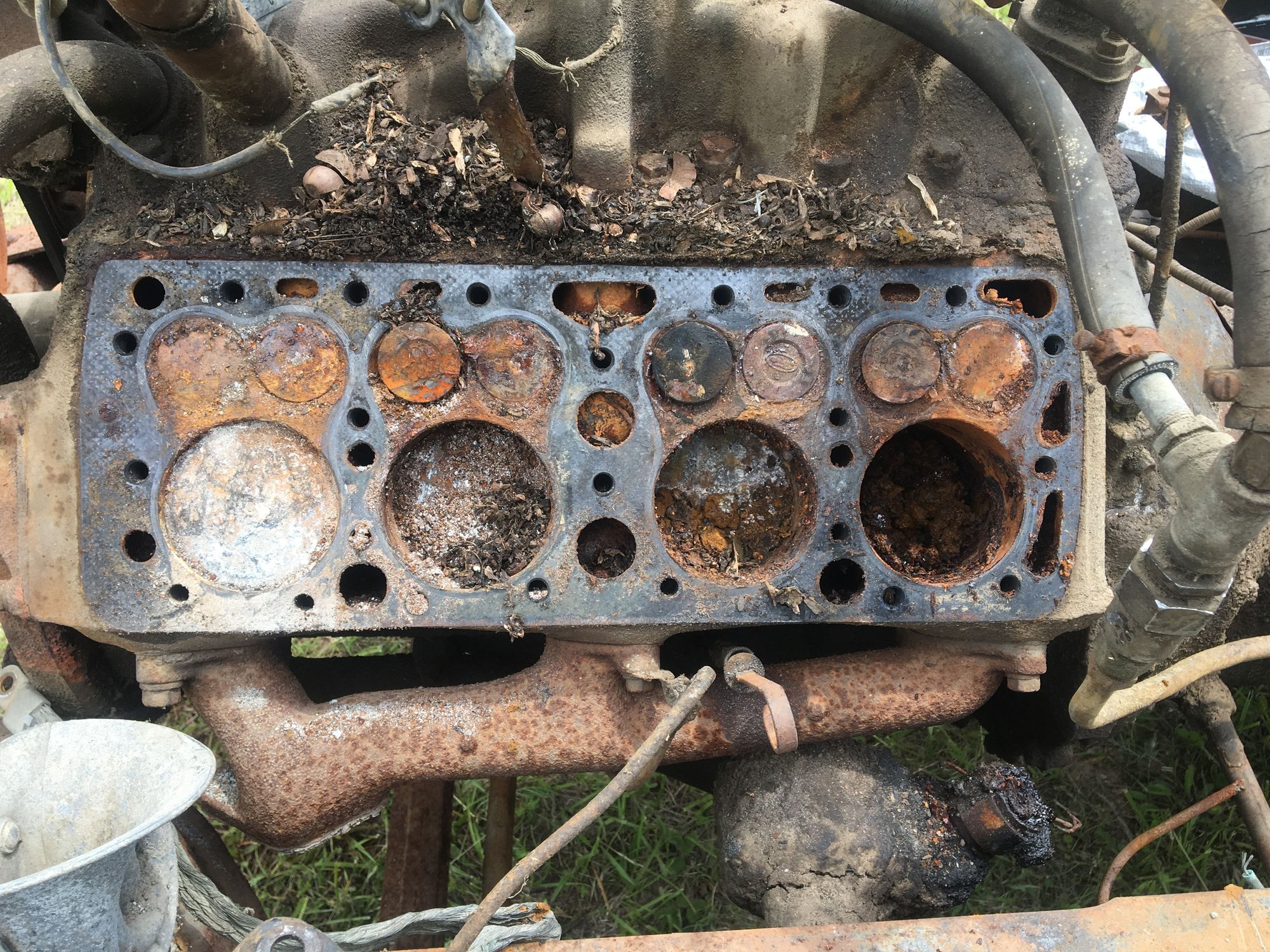

So I pulled the heads off the motor today and looked inside, and the is water in the one cylinder and the heads are both cracked, so planning on rebuilding the motor and replacing the heads cause the block doesn't have any cracks in it as far as I can tell. Was wondering if anyone could see anything that I am missing. Passenger side
Drivers side

Hard to tell. I'll tell you it's a lot of work getting one like that unstuck. Can't get some of the pistons out without disassembly, can't disassemble some of the stuck pistons as you can't get to the rod nuts. Here's a trick I use and it's never failed me.

If you can get a working starter hooked up, pb blaster and atf soak with a few bumps of starter here and there works wonders.
