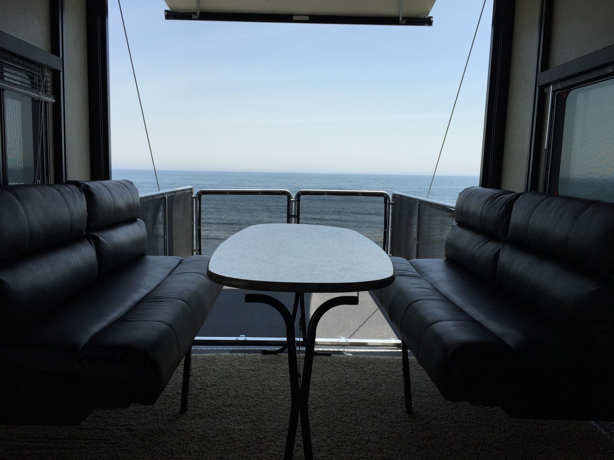

Yep, our garage turns into a dining room, a bedroom for our daughter when you fold the couches to a bed, and has access to the rear party deck with sliding 3 season doors. TV, DVD, and washer dryer in there too...
This is dining room mode at the coast...
