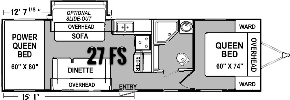

Bringing this back to life... So we are looking (hoping it'll work) at getting something like a Keystone Fuzion or Carbon or a Dutchmen Voltage. We want one with the separate sealed garage and a minimum room of 12'4" in garage (RZR 4 1000).
Here are a few that we are thinking about....
http://www.dutchmen.com/voltage/floorplans-and-pictures/floorplans-detail/?modelId=27402
http://www.dutchmen.com/voltage/floorplans-and-pictures/floorplans-detail/?modelId=6687#
http://www.keystonerv.com/carbon/models/347/model-mobile

Here is my confusion... I know based on everything that the Max legal 5th wheel would be right around 15000 loaded. I'm just confused how to determine the other parts. Here is an example of a higher one I found:
UVW (Unloaded Vehicle Weight)* 9,750
Dry Hitch Weight* 1,900
Dry Axle Weight* 7,850
NCC (Net Carrying Capacity) 3,450
GVWR 13,200
Interior Height 92"
Exterior Height 12' 7"
Exterior Width 96"
Exterior Length 39' 11"
https://www.kz-rv.com/products/sport...r-352TH12.html
I feel that the truck can pull this easily but can it legally? That is where my confusion is. Since I don't plan to really use a 5th wheel like most people do (travel the country and such) I'm okay with planning routes that do not take me near scales and such if I have to.
I was also told by someone the other day that if you have a triple axel on the trailer (5th wheel) that you have to have a 3500, is this true?
I was also looking at something like this: XLR Boost Toy Haulers by Forest River RV
Does moving weight around (say more weight in the garage) help reduce the hitch weight?
Thanks!

That pin weight, dry, is almost your entire payload. Wet, it would most likely be over, not to mention you couldn't have anything in the truck at all.
Legal, no. Could it pull it, yes.
