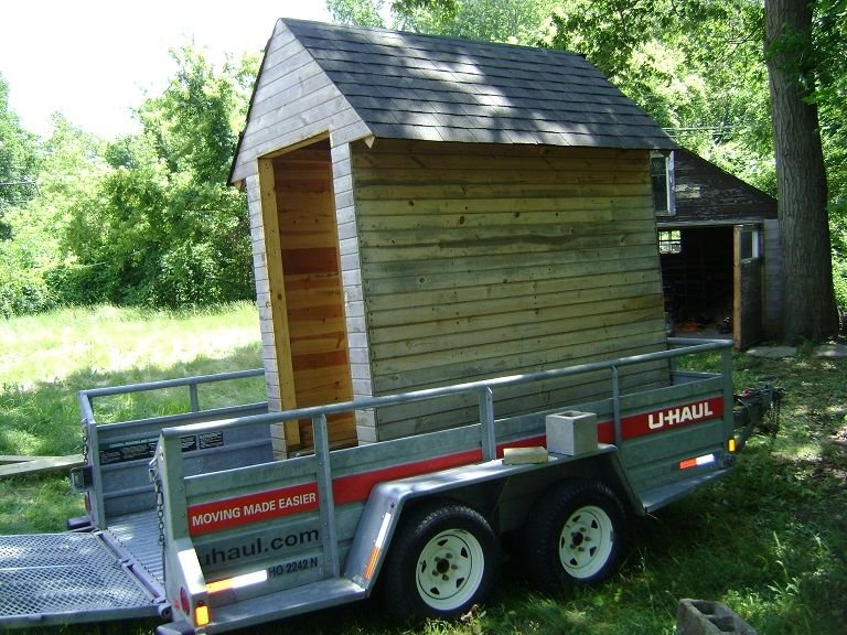

I guess I got lucky and the lights all worked perfectly. Here's a couple pics of the tremendously heavy shed I moved to a friends house.
One seater or two?

One seater or two?
More than 40 years ago 3 of my uncles bought a hunting cabin in the Upper Peninsula. It's a very nice cabin still in the family but it had a two-holer (still does). I couldn't imagine sitting elbow to elbow with someone while having a sitdown. Summertime sitdowns were brutal with the aroma. Wintertime was better except for the morning frost on the seat.
