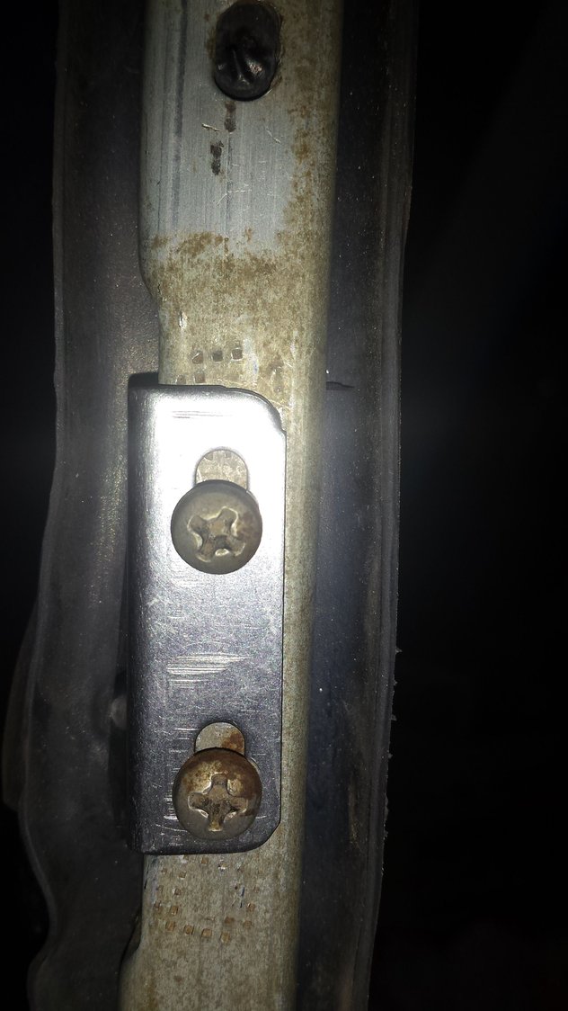

I am attempting to put the door glass, starting with the wing windows and am having nothing but trouble with the seals. The area around the hinge gas about 1mm of gap. Ive tried to bend the frame but it seems that when you screw it back in reverses your work.
Any tricks?

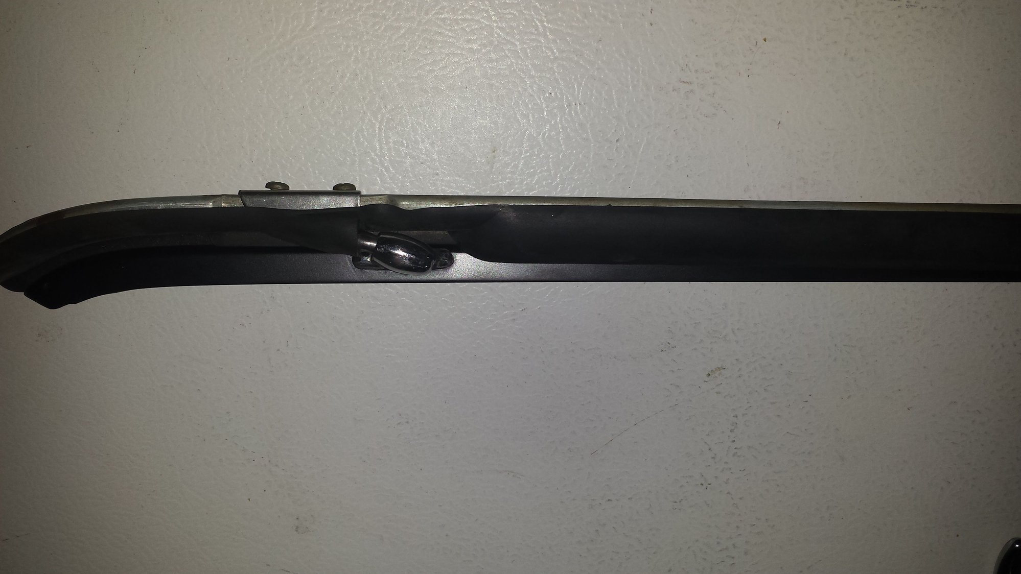

I just noticed but you can see the gap I am talking about in this photo too.

Same issue I have on my 53. I was able to shim the back side of the frame to get it somewhat fixed but I'm not happy with it. When you shim the back side it moves the whole unit back into the division bar.

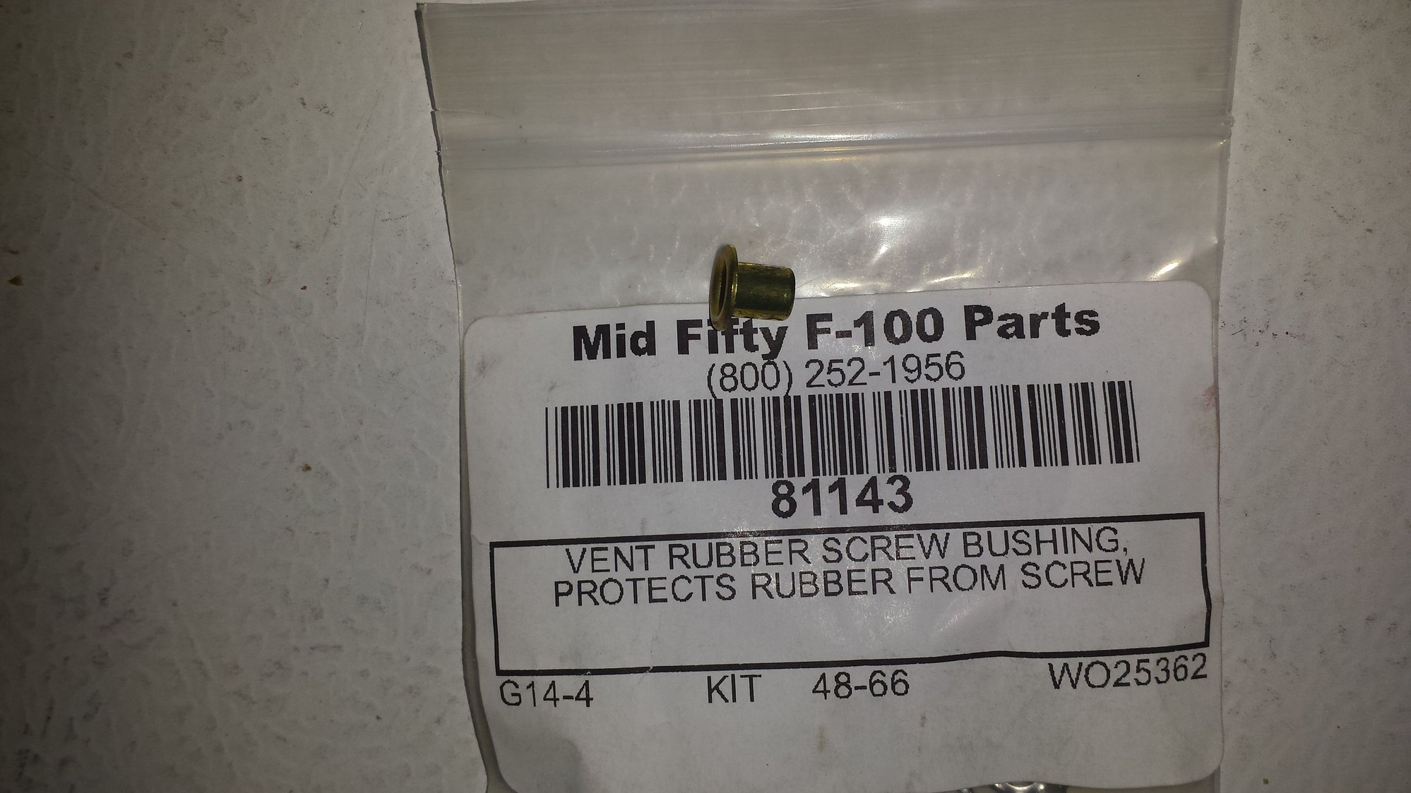

No gap in mine but they aren't installed. Did you use these brass bushings? Not sure if they would keep the outer frame from collapsing into the door frame or not.
Old Jun 9, 2017 | 08:16 AM
avf100's Avatar
avf100
Joined: Oct 2010
Posts: 2,091
Likes: 599
From: Lancaster, CA.
They go into the outer frame mounting holes. Bad pic but it goes into that top hole for the screw.

I ended up just shimming the little hinge post about 1mm. There is still an ever so small amount of daylight visble, but you'd have to have good eyes to see it. I think it might even be possible to glue a thing piece of rubber or a tiny scrap piece of window tape flush on the back of the frame and seal it.
