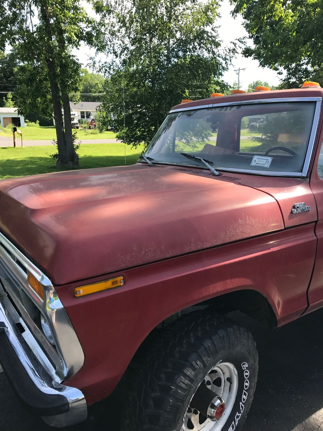

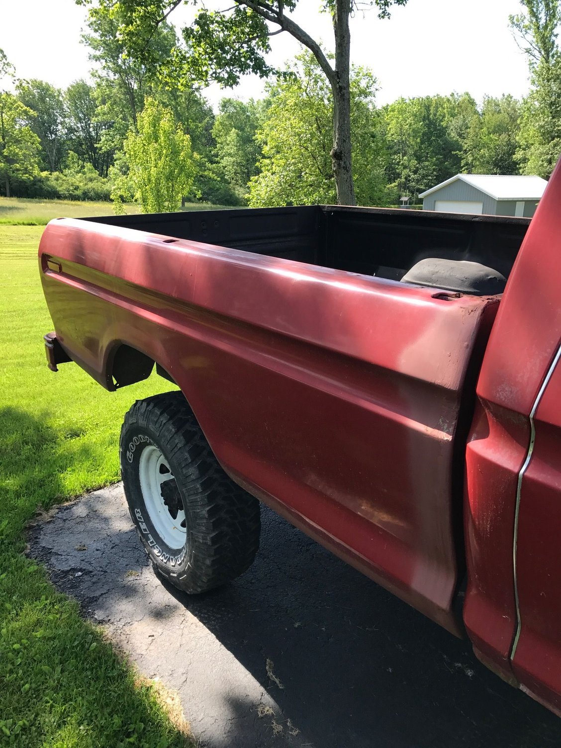

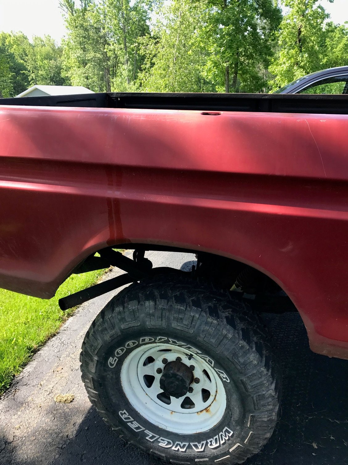

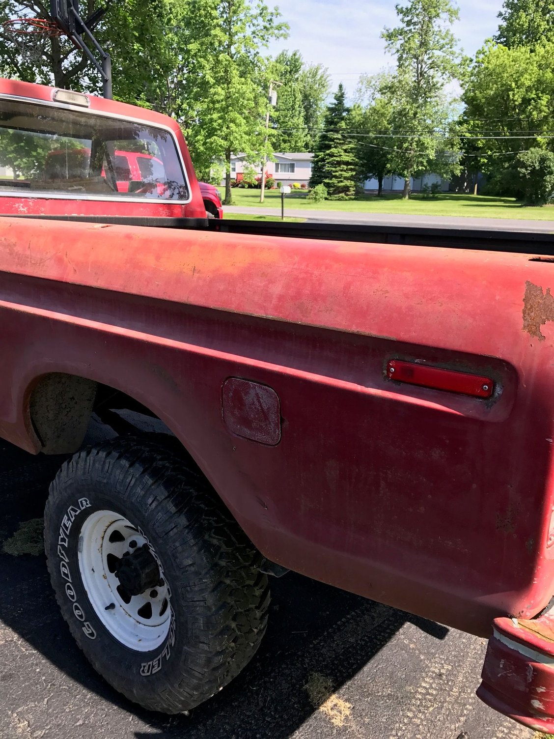

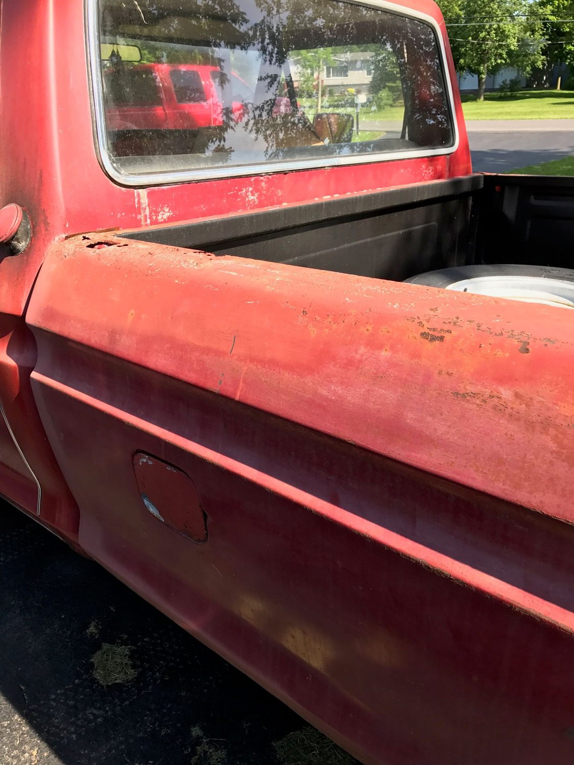

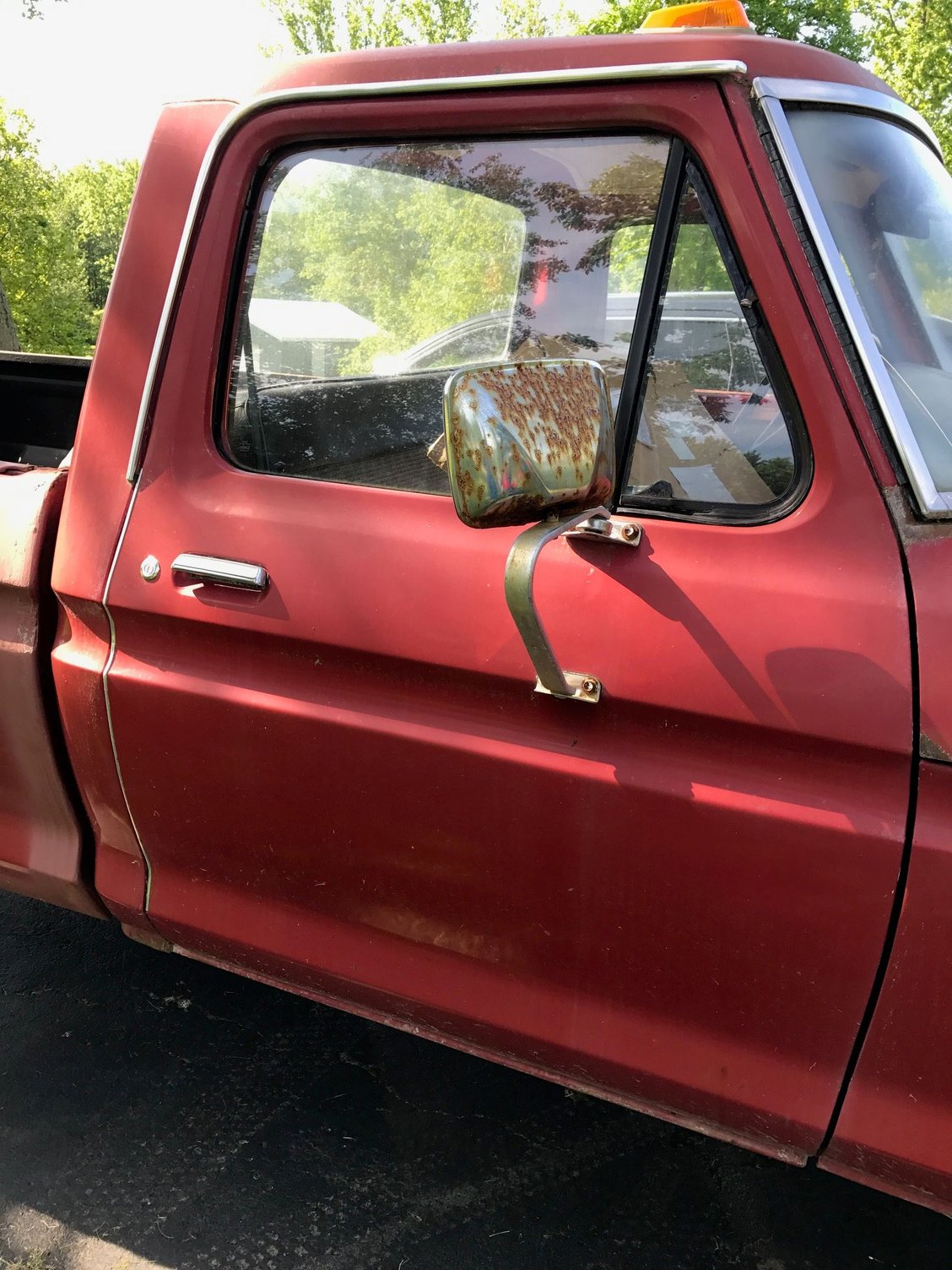

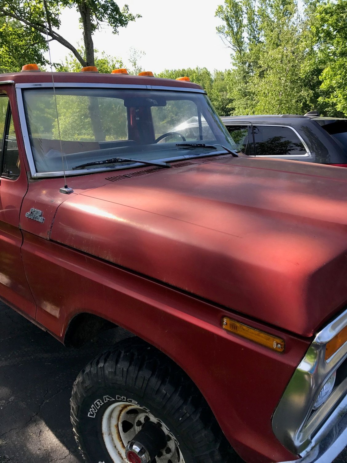

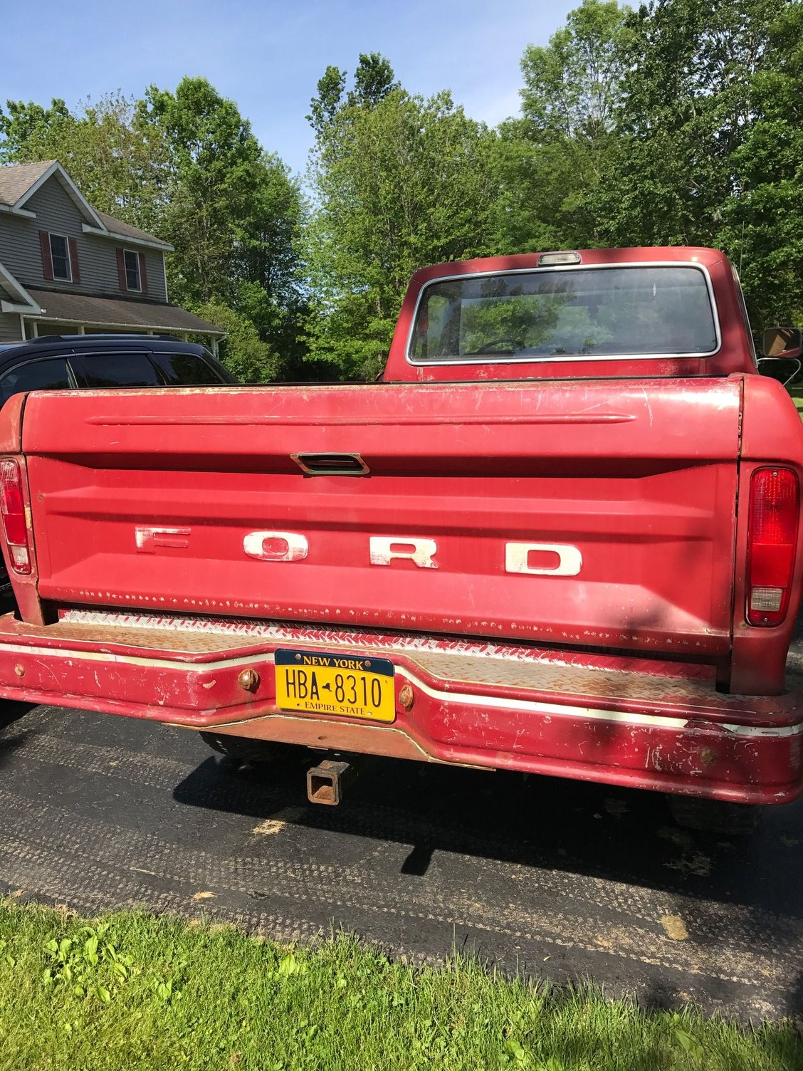

Question 77 Highboy
So, I've checked Craigslist from Vermont to Virginia and the most likely candidate seems like it's in Syracuse. Here are the details
https://syracuse.craigslist.org/cto/6156678045.html
- np205 transfer case
- driver side bed has some surface rust
- odometer is 38,000 - most likely 138,000
- current owner bought it from an old timer that rarely drove it
- leafs and shocks are not stock, but everything else might be?
- I can't run a vehicle history report, but the VIN checks out for a 77
Anything else I should be asking?
Pictures to follow in the next post...

Now you are looking at a truck worth the $...IMO. OBO so start it at 3000 CASH and see how that works. Cab gas tank and bed with twin gas flaps, I bet the bed had be swapped on.
Highboy front frame cross member. HB 101 https://www.ford-trucks.com/forums/9...mpilation.html
New truck 101 https://www.ford-trucks.com/forums/1...l#post14696861
Probably has the Bendix or Garretson ram assist steering. Rear springs 2 1/4 wide ='s HB
Good luck with this one.

That truck is wayyyyyyy! Better than the last one! That one seems pretty solid. Like what was said bed was probably swapped but that's no biggy. Most beds by now have been probably anyways. I doubt he will take the 3k cash, but it is someplace to start and you just never know. No engine pics ��. Make sure to crawl under it and inspect all that real good for leaks and rust. Check for leaks after test driving it getting it all nice and hot. I noticed yesterday I have developed an oil leak I need to investigate now that I've been driving and pressure washer the truck haha.
