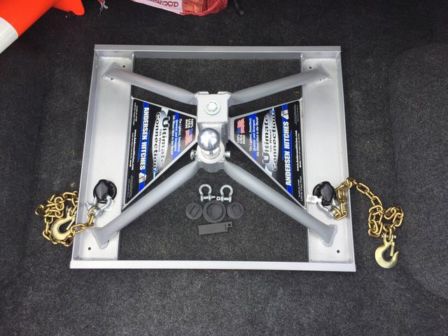

Another vote for Andersen Ultimate Hitch. I tow a 14000 lb 5th wheel. I get a little over 2" sag when hitched. I can get about 70 degrees of turn backing up.
I'm 70 years old with a bad back. The 37 lb Andersen is a piece of cake to remove or install.
