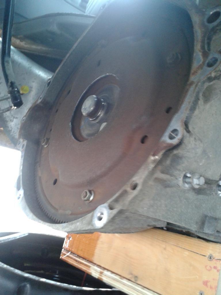

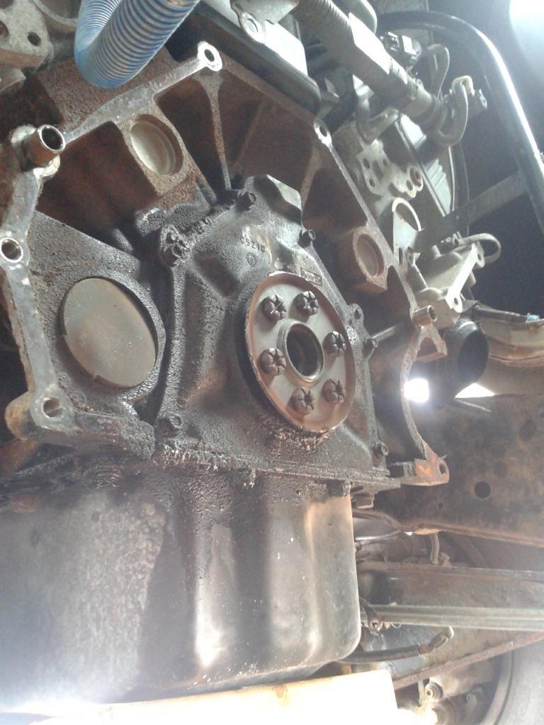

You may have a broken flexplate. I experienced the same symptom with my '06 Van last winter only difference was the truck ran fine one day, parked it and the next day the engine appeared to seize when I tried to start it. Breaker bar on the crank could not move the motor, but in working it back and forth I manage to get it free. It cranked briefly after that but seized again, worked the breaker bar some more and then the starter spun freely and didn't appear to engage the flexplate any more, so I changed starters but that didn't help so that is when I started looking at the flexplate closer and eventually discovered the real problem. Upon removing the inspection cover at the front of the trans I discovered I could push the flexplate back which isn't right, it had somehow become disconnected from the motor. Anyway after dropping the trans this is what I found, my guess is that with nothing centering the flexplate on the engine is would jamb on the trans case when I tried to start it.
