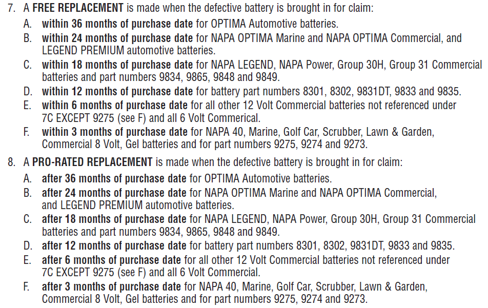

Autozone has a 5 year warranty on Duralast Gold. Napa's best warranty is 2 years. I'm confused by your smart shopping.
https://www.napaonline.com/en/p/NBP7527F

The NAPA Legend 75 may be rated for 75 months but, as far as I can tell, the they're pro-rated after 18 months...
Correct on the warranty.
