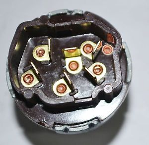

The original 1968/69 F100/750 & Passenger Car; 1970 F100/750 (before serial number F90,001) ignition switch (C8AZ-11572-A) shorted out and caught fire!
1970: FoMoCo replaced it with a new switch kit (D1AZ-11572-C / Motorcraft SW-1054) that included a pigtailed wire harness w/plug.
It plugged into the switch, then pigtailed wires were spliced into the existing wiring harness.
There were no US Gov't mandated recalls back then, it was up to the dealers to inform the customers of the POS switch and its replacement.
Some dealers did, but some did not. So, if your switch does not have spliced wires, it's the original POS!
C6OZ-11584-A .. Ignition Switch Bezel .. It threads off/on / Obsolete

If you can't get it out or in tumbler out or in as your watching the sun go down.
an you say your stuck on the road side.
A fast lesson learned waiting to get home before tinkering with trying to install the new part.
If you can't get the old girl started then, I'd would just Hot wire the old girl by just running a jumper wire from the + side of the battery to the coil+ side an then use a screw drive, crossed the large+ term. on the solenoid an the closest small terminal.
This will engage the starter. Remove jumper wire to kill engine .
Orich
Newer replacement switch
Old fire starter switch
