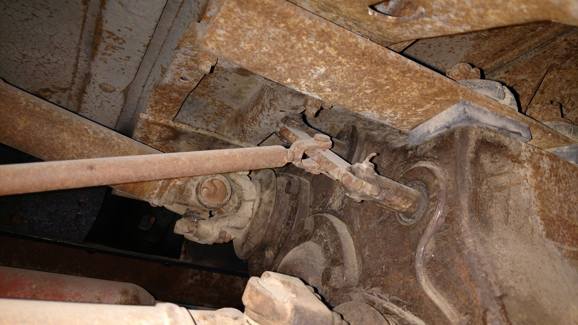

It isn't much, just a lever and a rod. Lever bracket bolts to the top left side of the transmission. I don't have pictures of mine. If you still have the piece on the T-case connecting the 2 shift rods, the rest would be real easy to make. If you get in a bind, I have the junk Dana 24 from my 59 and could get pictures of the shifter (if I have to)

Ok, I went out and took some pictures for you. My T-case is a NP 205 but the shifter is original.

From: Black Hills of SD
Sorry they are crappy pictures, Evening sun was in the way.

Wso the bracket on the tranny is there and the bracket connecting the two rails I'll just have to fab the rest even the linkage is there just the shifter itself is missing!
