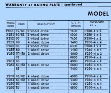

Here is a screen shot from my Ford catalog it shows Model F253 as 1960 F250 4x4. with GVW 7400. Came from the factory that way, Ford first offered factory 4x4 in 1959
​​​​​​​so according to the chart your truck is a factory 4x4. The #F280 I found is for '59 F250 4WD '60 is F253 which matches the model # on your rating plate.

That's good to know. Now does any one have a picture of the original tcase shifter setup? I assume ide have to fab my own!
