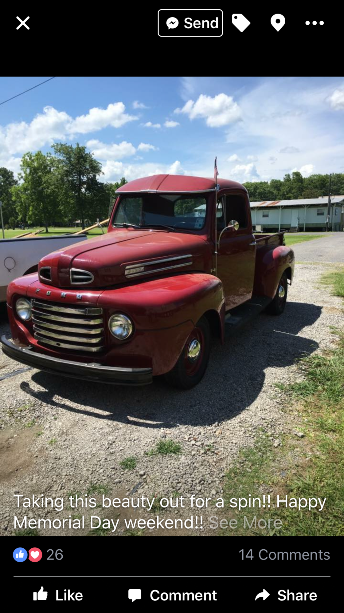

If only they were all as simple as our '49 F-1 we'd have no problem!
