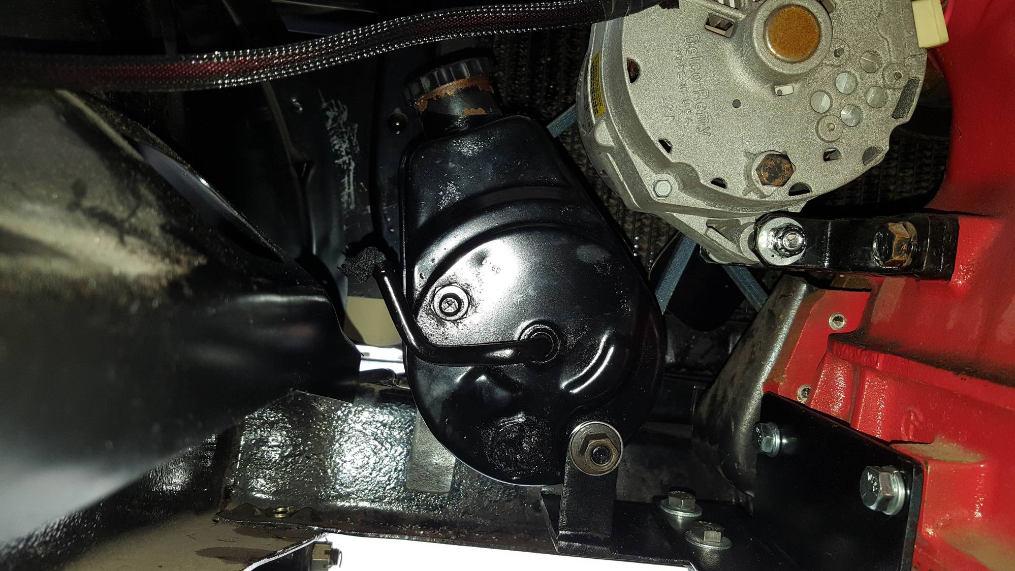

Decided that I wanted to add power steering to my truck. Picked up a "canned ham" pump and reservoir from my local U-pull it yard. Used pic I found on this site to make a bracket for it. Finally got it done.
Now I need an early Toyota 4x4 pickup gearbox. They are as hard to find as unobtainium in a salvage yard. You can find them online...but they want big bucks for them.
My search continues.

You can use a box from a Toyota 4Runner too, I got one out of a '84 Toyota 4Runner.

Yea 86 is when they changed over from straight axle on the 4 runners
