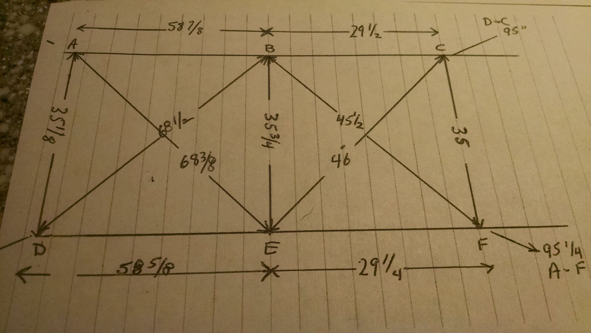

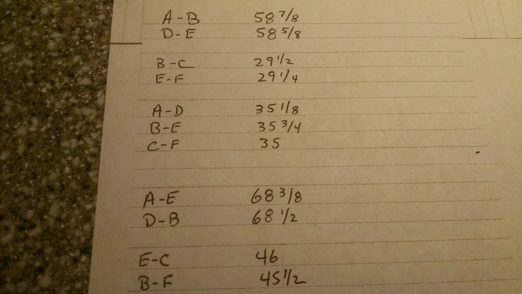

Thank You for this. I did some more plumb bobbing today and came up with this. If these numbers are not to bad the issue is going to be the rear bumper. I discussed the problem with a body guy today and we will look at this tomorrow. In the meantime this is what I have. A-D is rear

Do the numbers look like the specs are close enough? Are there any recommendations?
