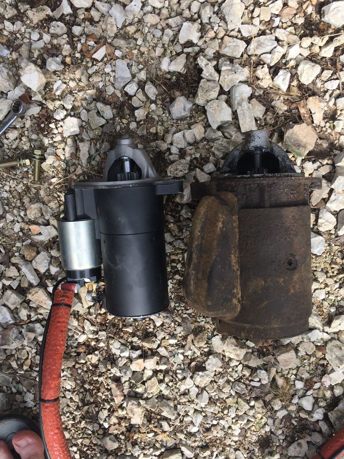

This is the size difference between the 93 460 gear reduction starter that will die the 351m or 400m engines. There is a difference between auto and manual trans starters so make sure to get the right one for your application. The orange is a fiberglass heat sleeve to protect the new battery cable
Is the new style able to function without the grease and grime?
lol the grease and grime is just added lubrication.
