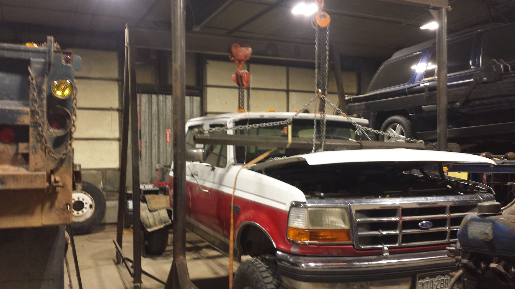

Prepping the frame.
Preparing to lift the cab.
Got the cab up!

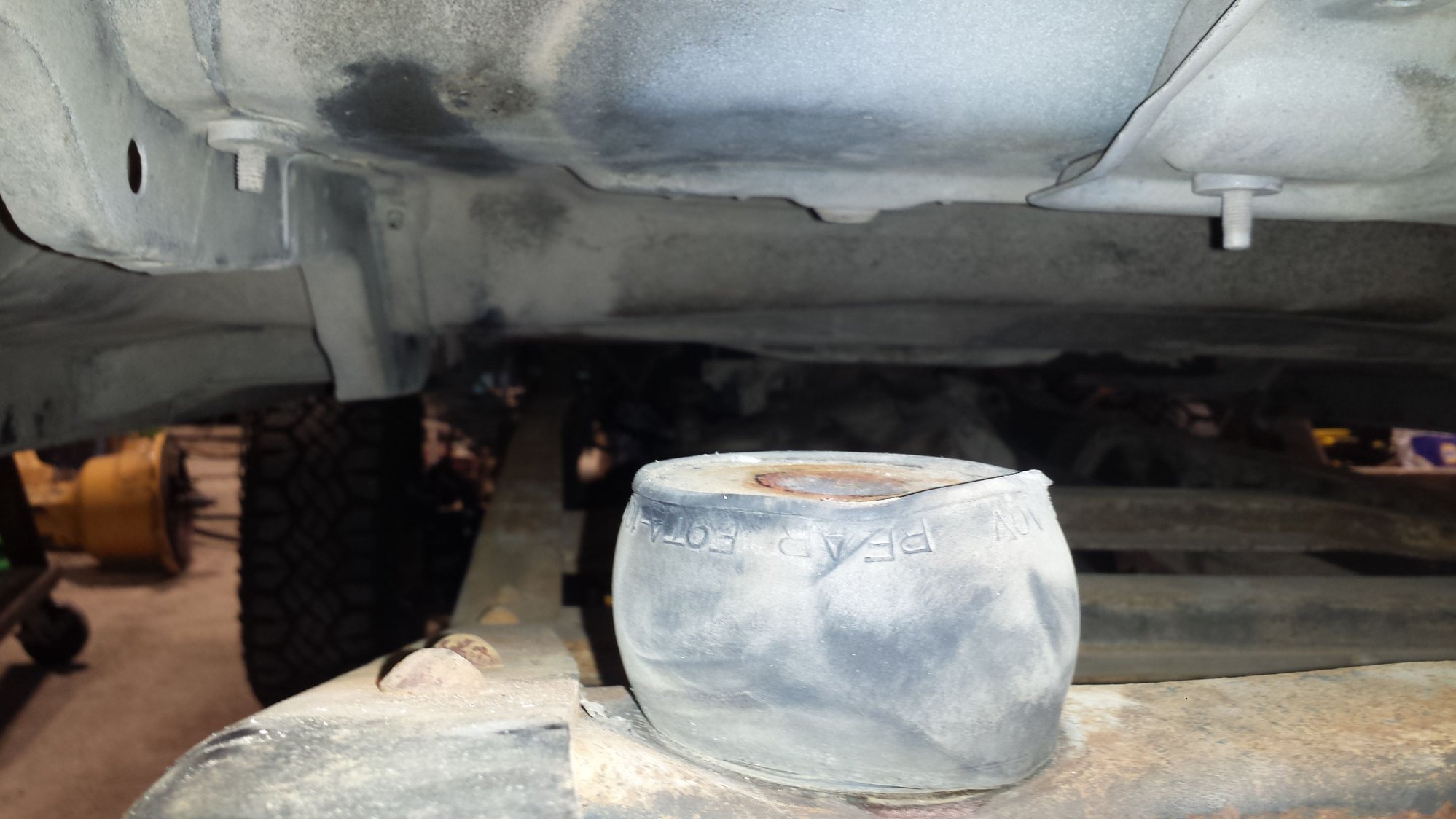

Body mount bushings and gloving the frame.

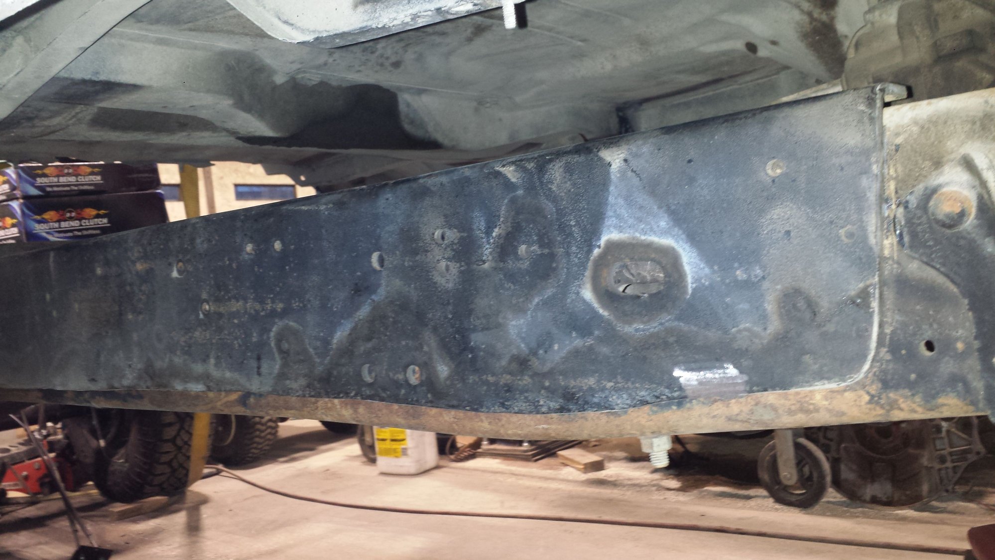

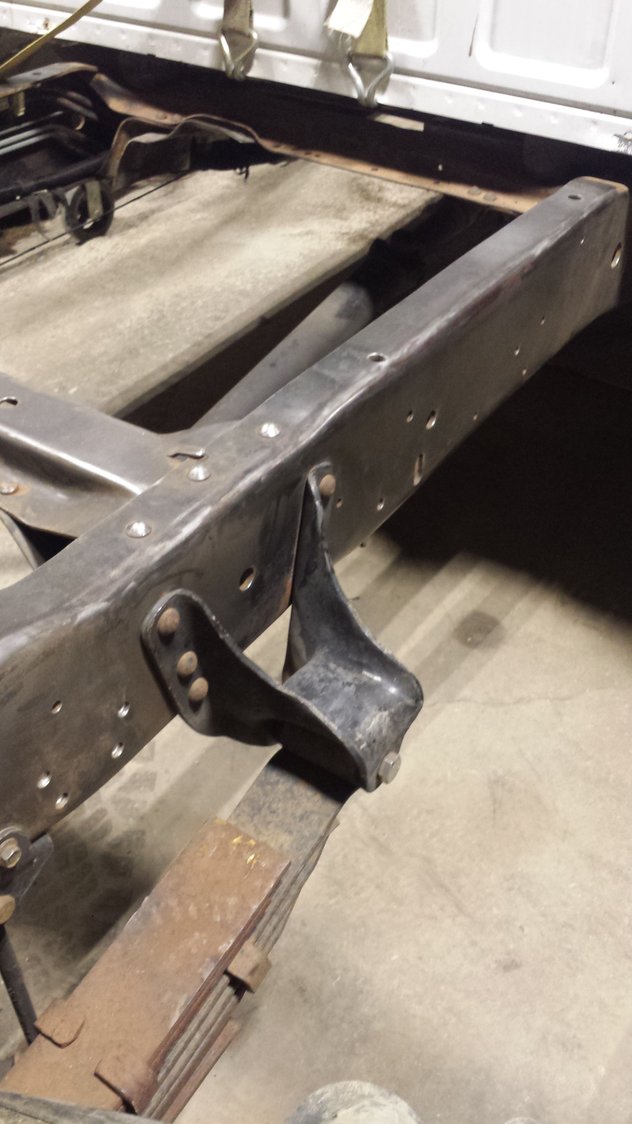

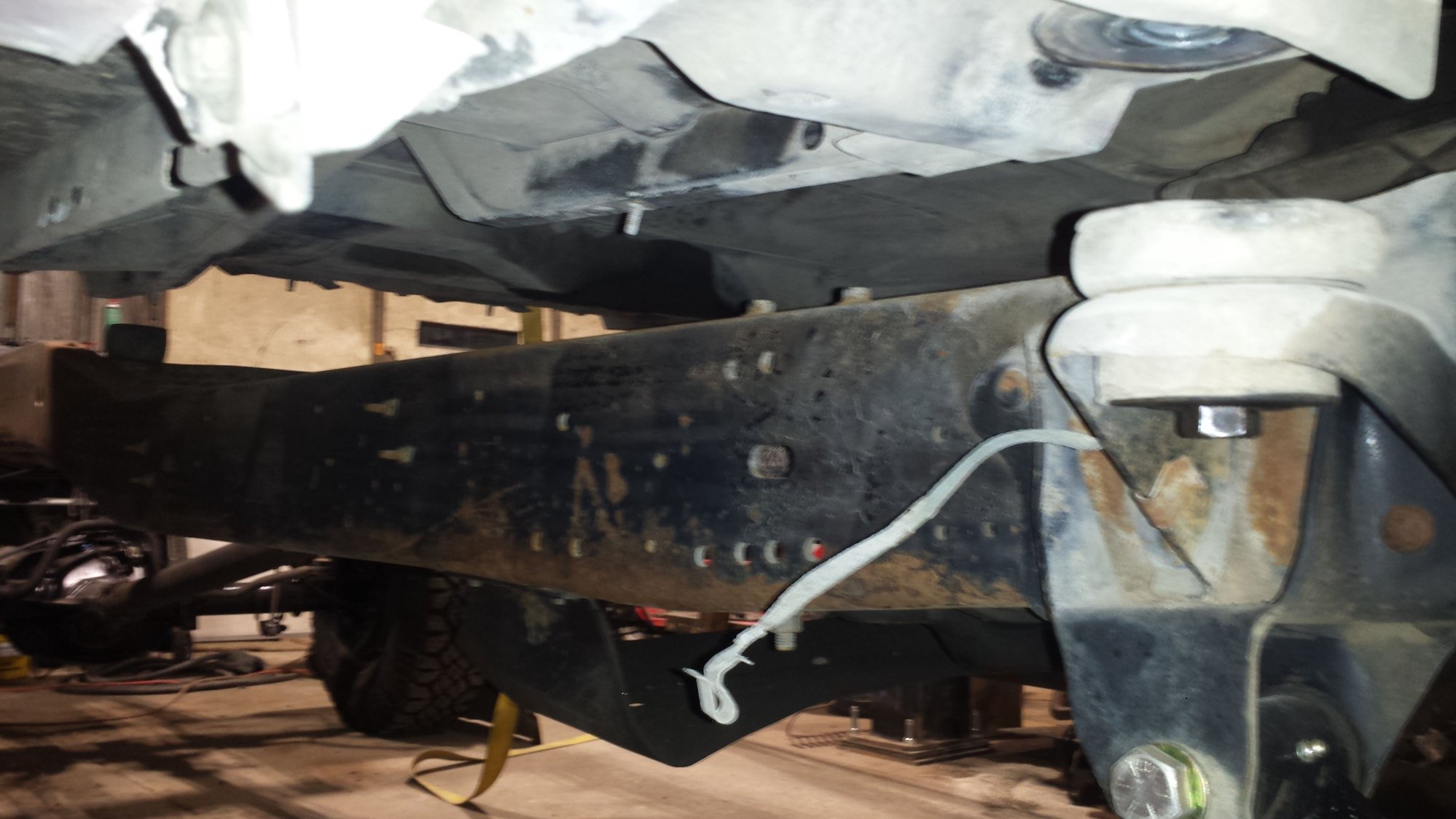

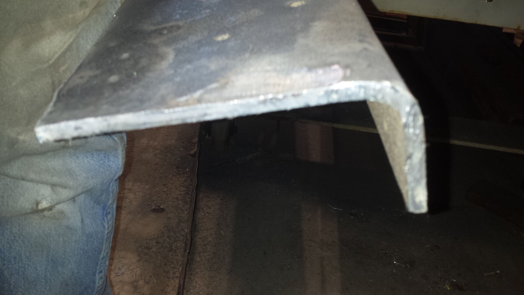

The second layer of frame. . .
Working on getting it fit. . .
All fit, cleaned up and ready for some welding. I'm going to be grinding the spring mount rivets once the frame and mount are tacked together and welding them together so the mount is part of the frame, and then replacing the rivets with grade 8 bolts.

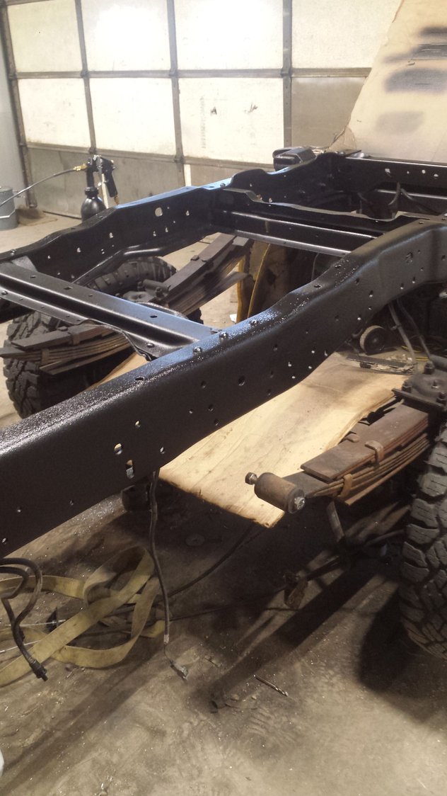

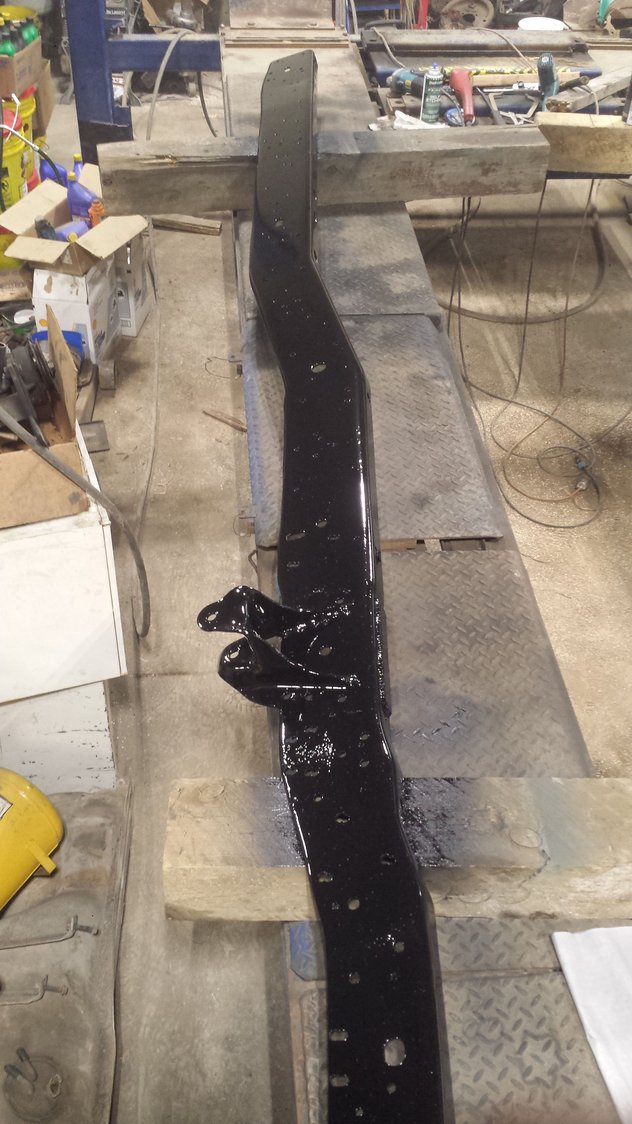

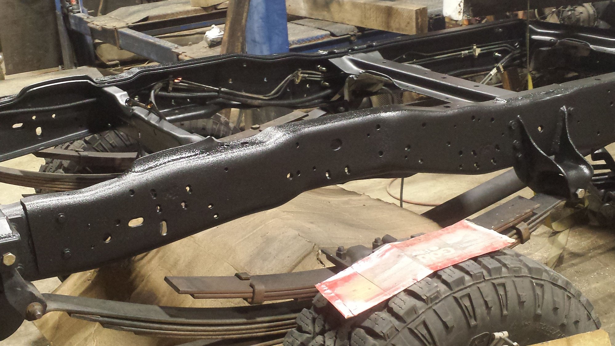

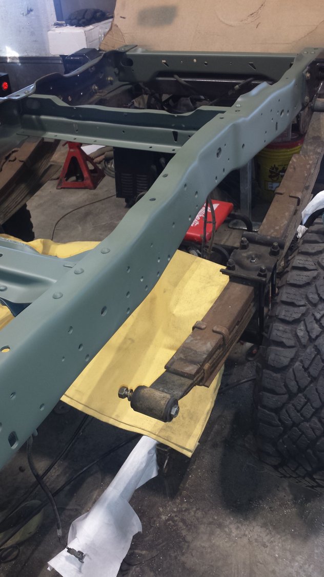

Everything in primer...
And then paint...
And then wax.

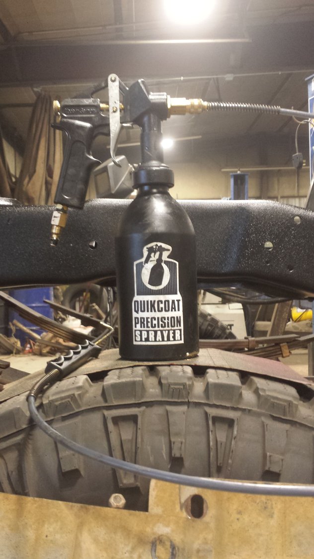

The gun I used for the wax. For wax I bought a 5 gallon can of Undercoating In a Can.
Finished product!
