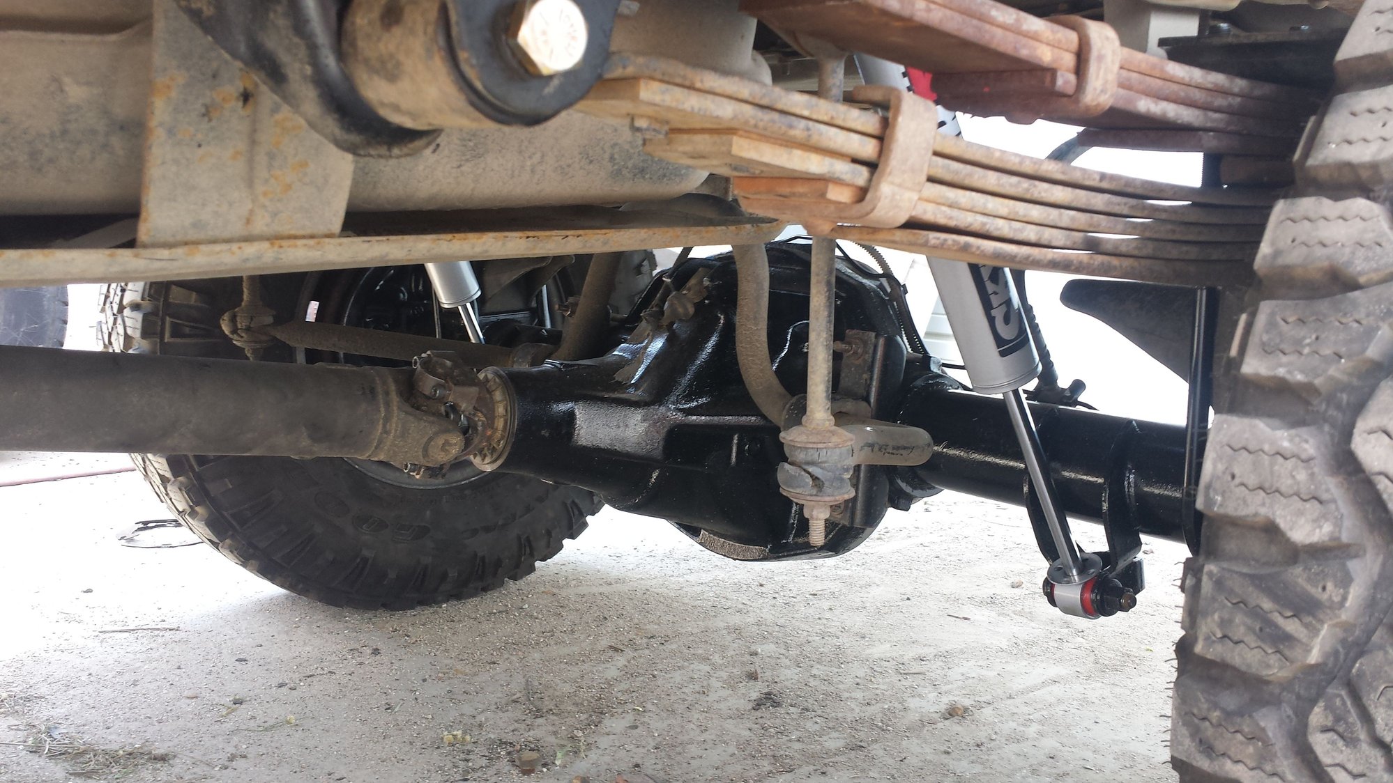

Turning the oversized bushings.
The turned bushing and the unturned bushing.
What I started with (springs relaxed)...
And what I have now (springs loaded).
There she be!
​​​​​​​Finally finished up the rear end and will be starting on the front soon. I am also gonna be starting on some of the body work soon.

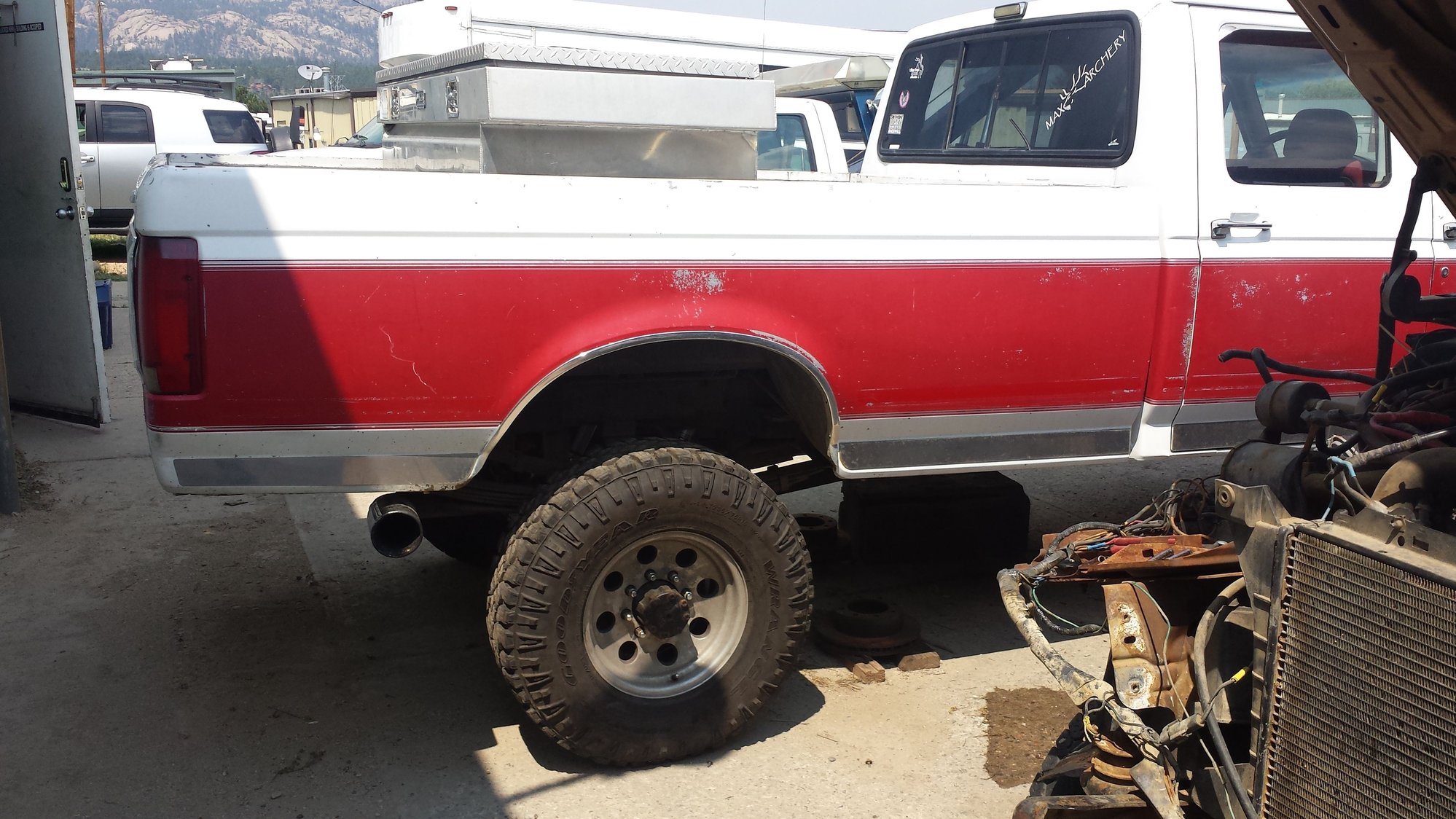

The truck is sitting on 33s just for reference.

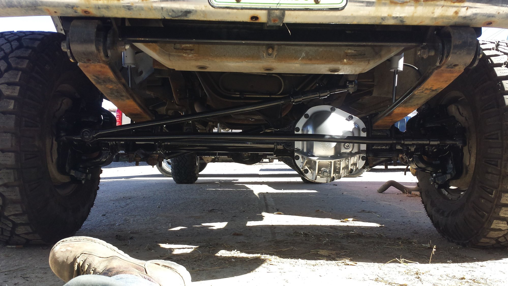

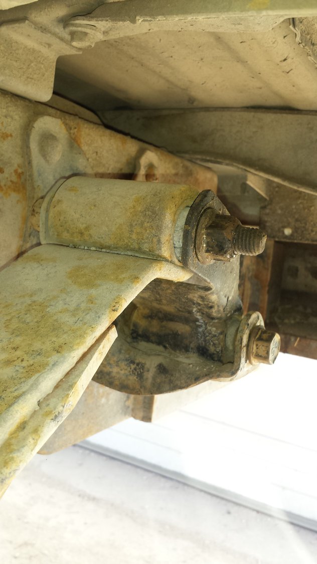

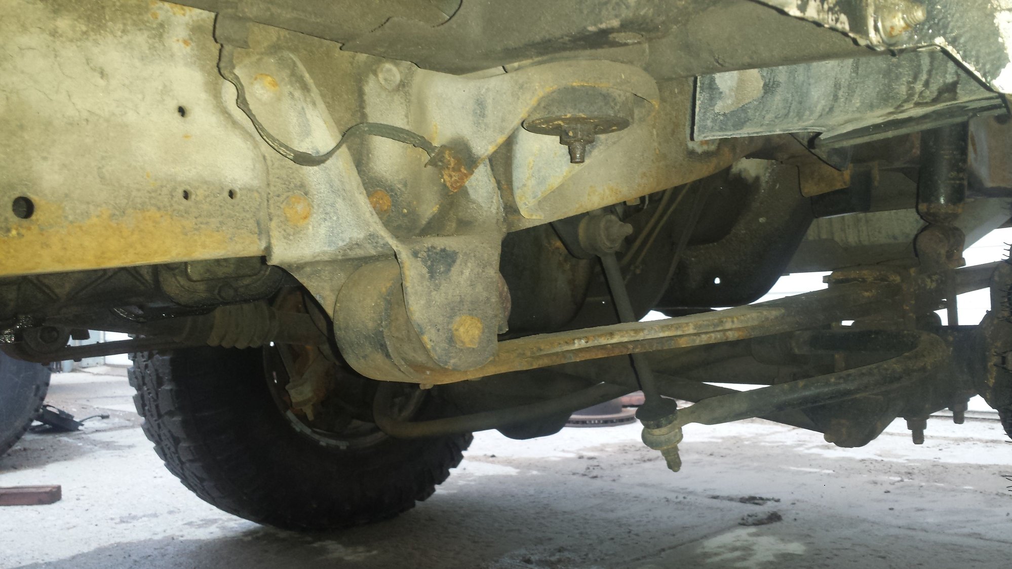

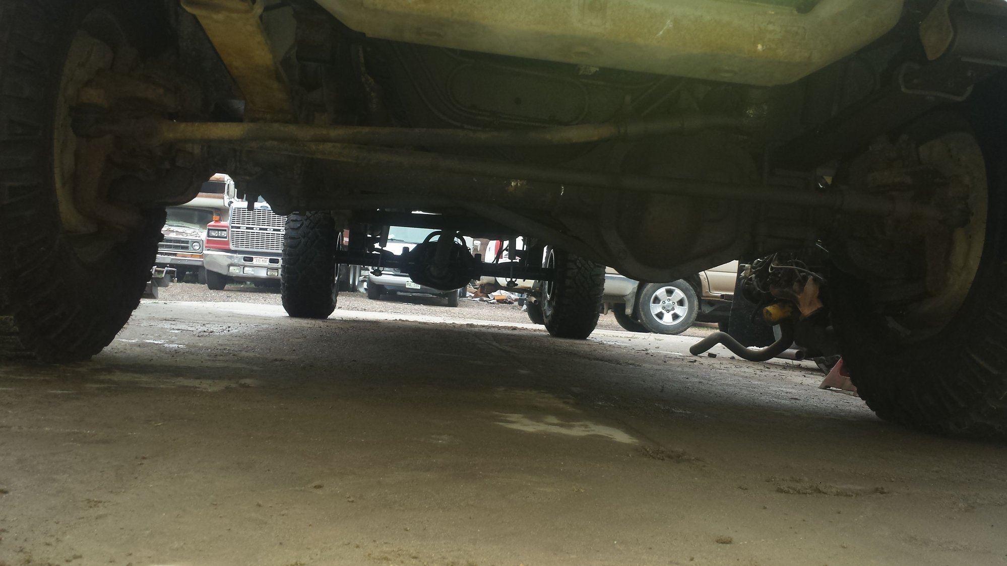

Howdy guys, I figured it was past time for an update. So here It is. This is......
What I .....
Started with.

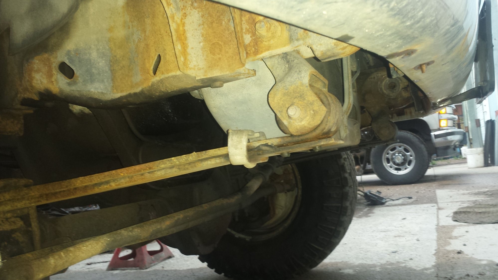

Original suspension.
I got all the dirt and grime cleaned off the axle. Now I'm ready to clean all the old paint off so I can paint it.

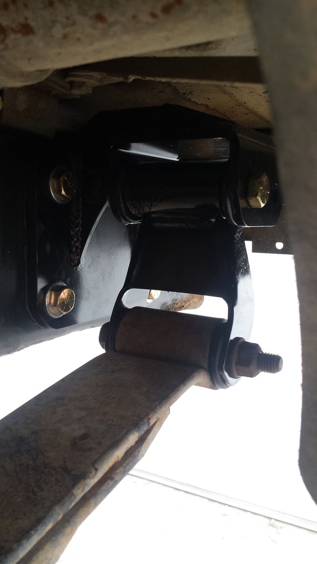

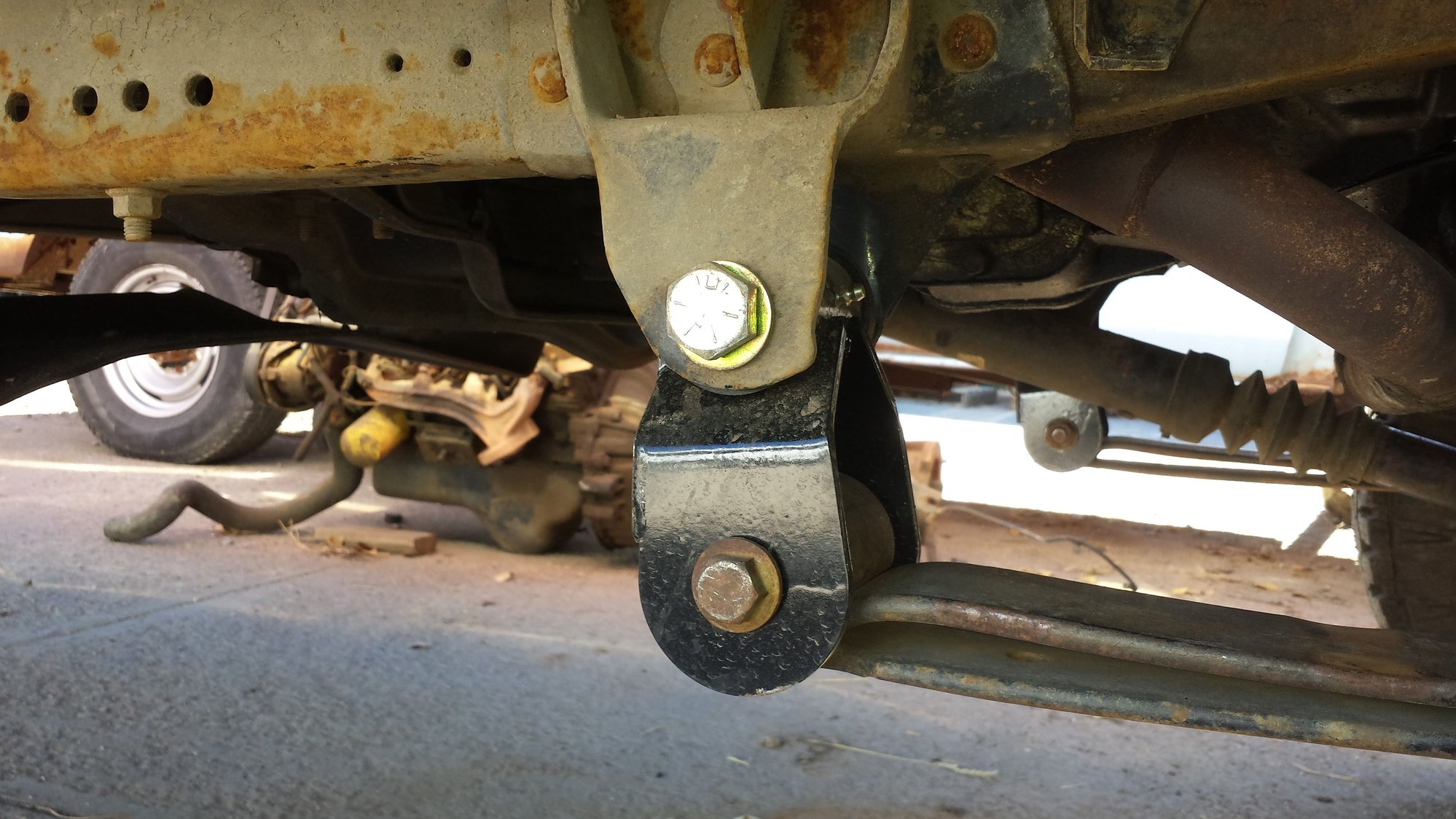

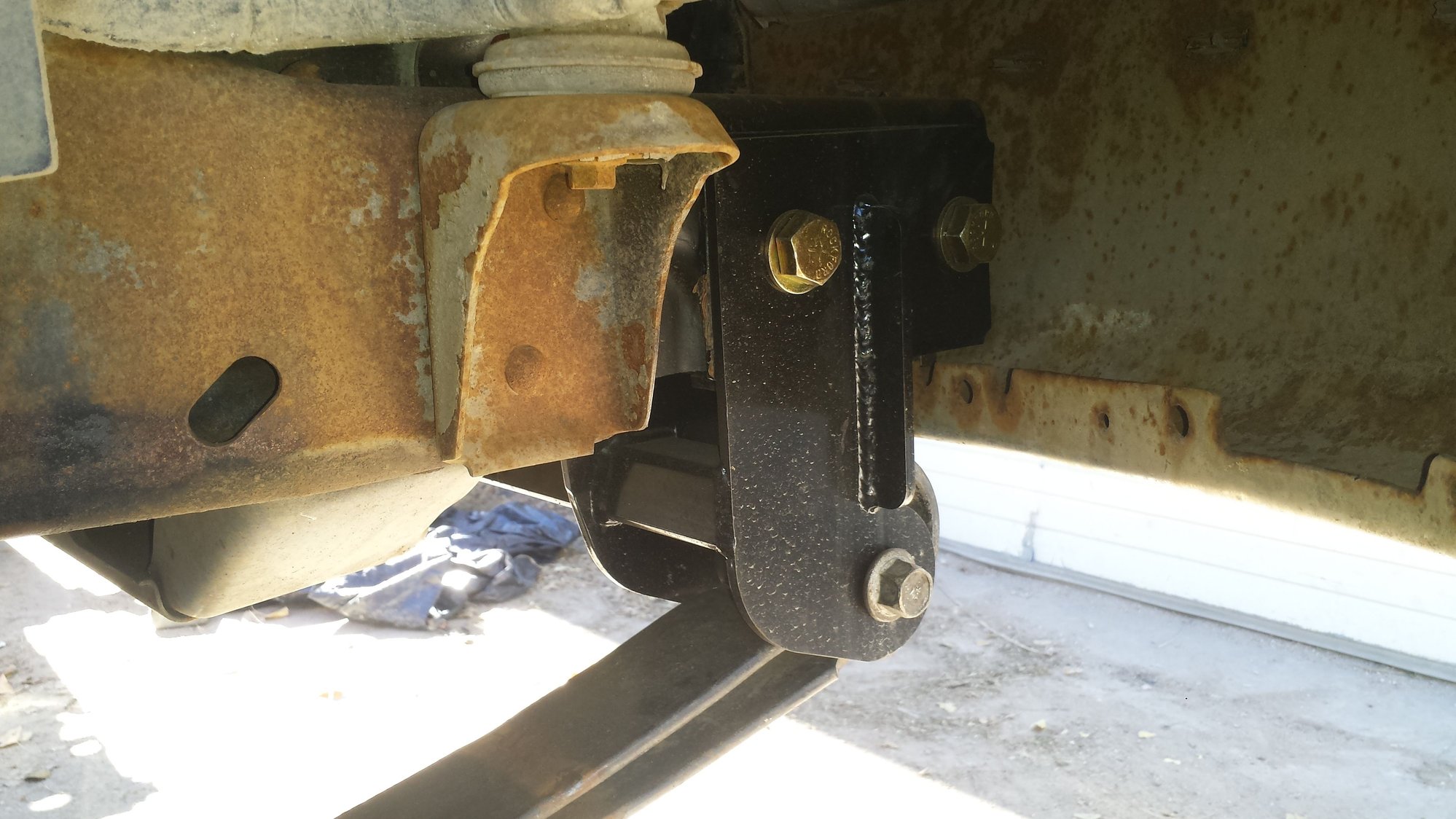

The new suspension.

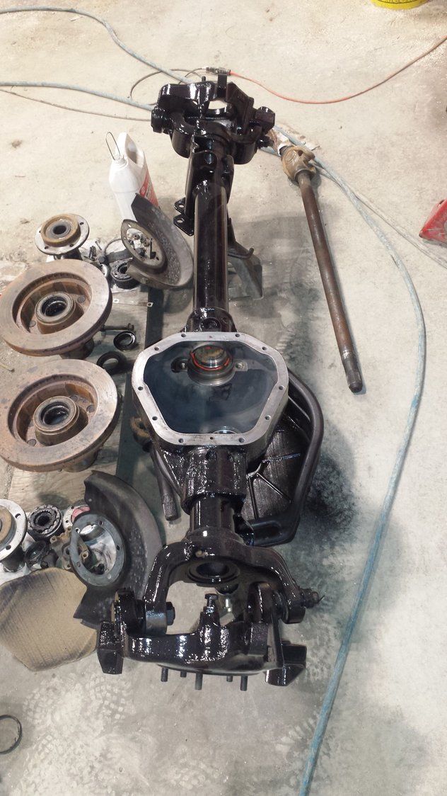

Update. Sorry it's been forever guys, I've just been working my tail off. Prepping the axle...
All prepped and ready for paint...
All painted up.

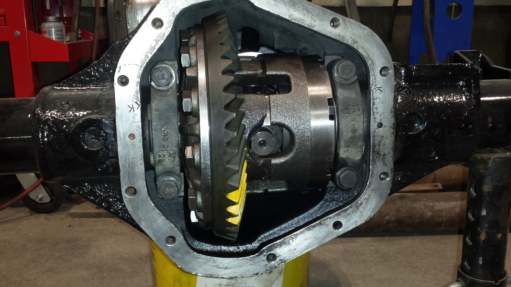

I decided to install a power-lock in the front.
My homemade diff armor and drain plug (not welded on permanently yet, the drain port is just a 1/2" pipe coupler).
My old stub shafts were shot where the Torrington rides them. So I upgraded to 35 spline chromoly stubs.
And the new 35 spline hubs to go with the stubs.
The power-lock permanently installed.

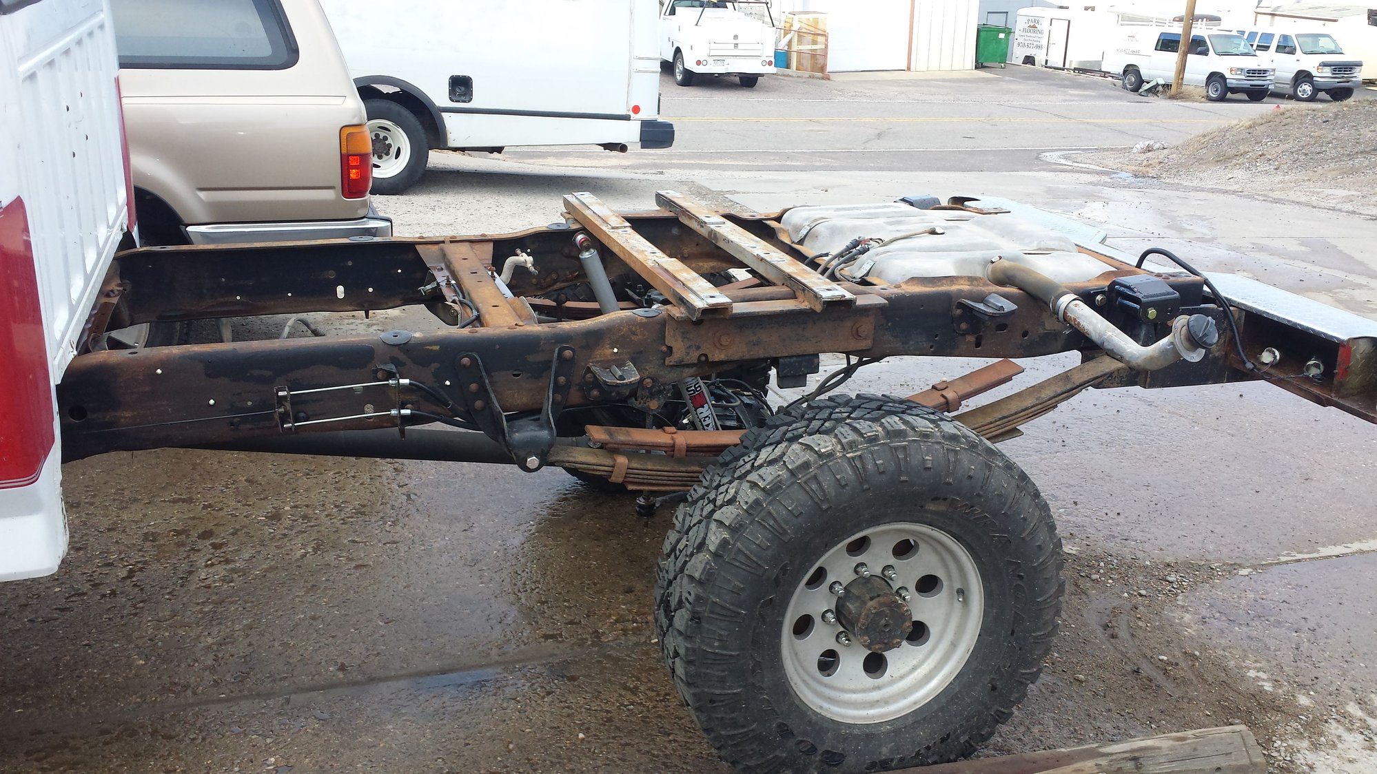

Alright, update guys. So the story goes like this. When I finished up the front, I noticed that the drivers side seemed to sit WAYYY lower than the passenger side. A few measurements confirmed that the drivers side sat an inch lower than the passenger side. At first I thought it was the springs. But a top of axle to bottom of frame measurement indicated that the frame is level on the axles. I finally traced it down to body mount bushings. They're all shot, but the drivers side is worse than the passengers side. So I'm doing polyurethane body mounts. And while the cabs up, I decided to go ahead and pull the bed, clean up and paint the frame, and double the frame. So the swap has been pushed out a little, seeing the new body mounts will change clearances. I'm also going to redo my overload perches while the bed is off.
