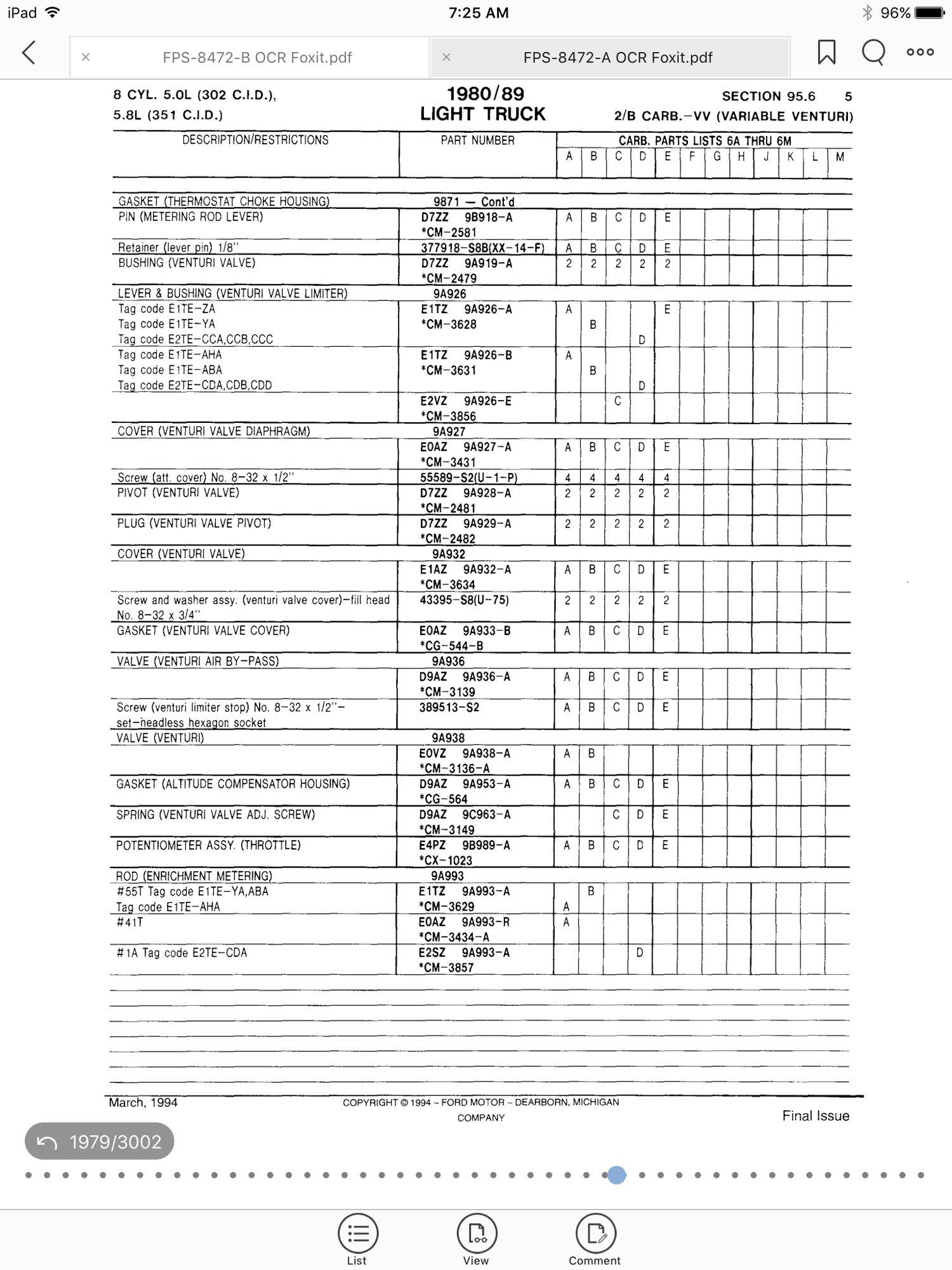

Ok, here's the parts list for 1-64S-R10. And I'll see if I can find the parts list for that carb.

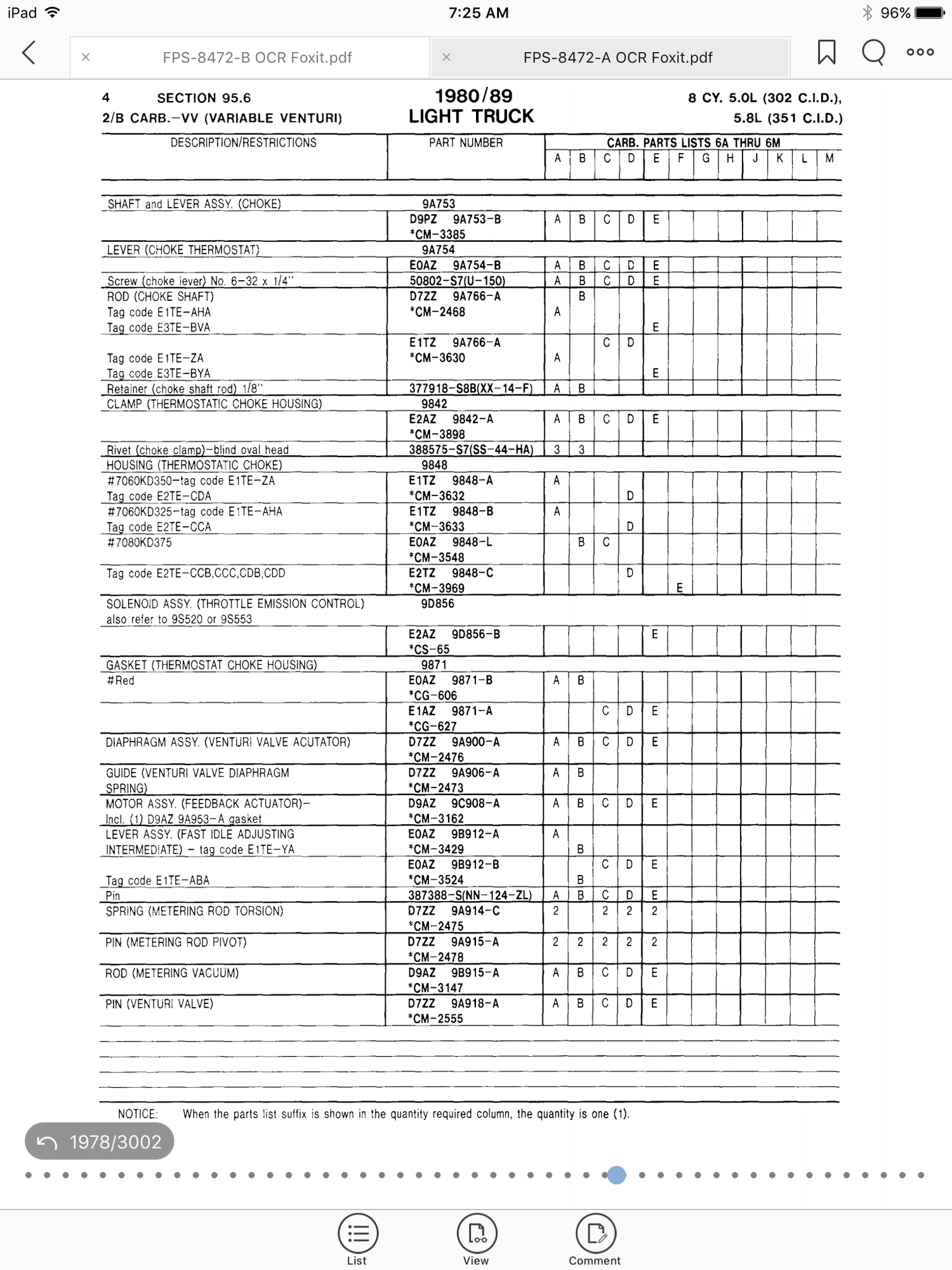

And, here are all of the parts for that carb in column D:

My first look, the two things that stuck out for me was;
1. (from gary’s first page post #52)
Vacuum Motor assy. (carburetor air cleaner) D4ZZ 9E607-B *CX-120
Vacuum Hose Routing map; A/CL DV - Motor Assembly - Carburetor Air Cleaner Vacuum
2. (page 2 of carb parts breakdown)
The Spring for the term; “Choke Control Modulator”
But no “Choke Control Modulator” part, just the reference to “Diaphragm Assy. (Choke Pulldown)"
Well, only because the vacuum diagram show the connection of “C” & “V”, and the pdf carb parts list shows the Choke tubing with the “Tee”, and the Carb Adjustments book shows the Choke Diaphragm connected to the top port on the Carb with 'Tee" in-line, do I think for now the “C” is connected to the Choke Diaphragm, for now…..
