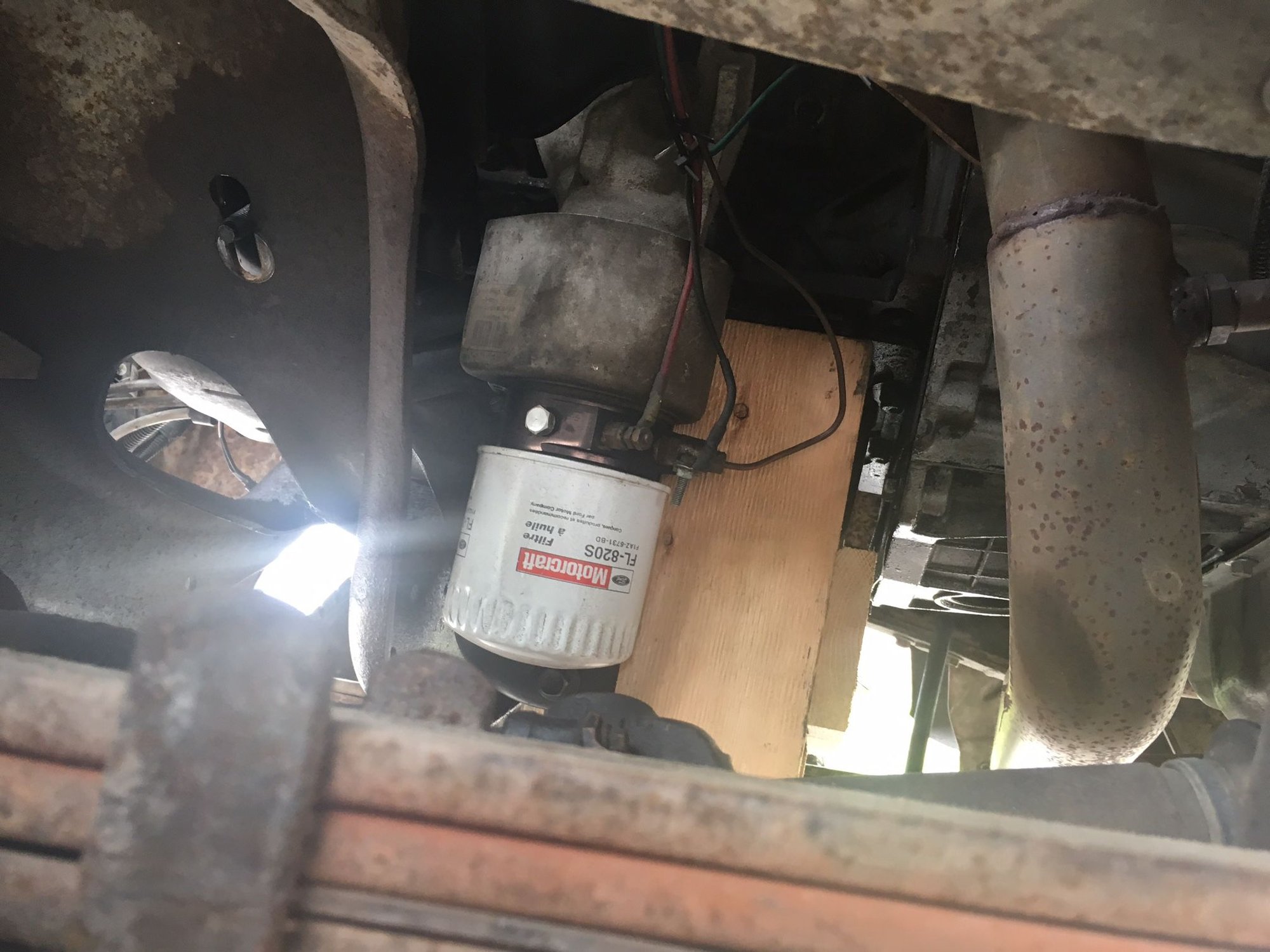

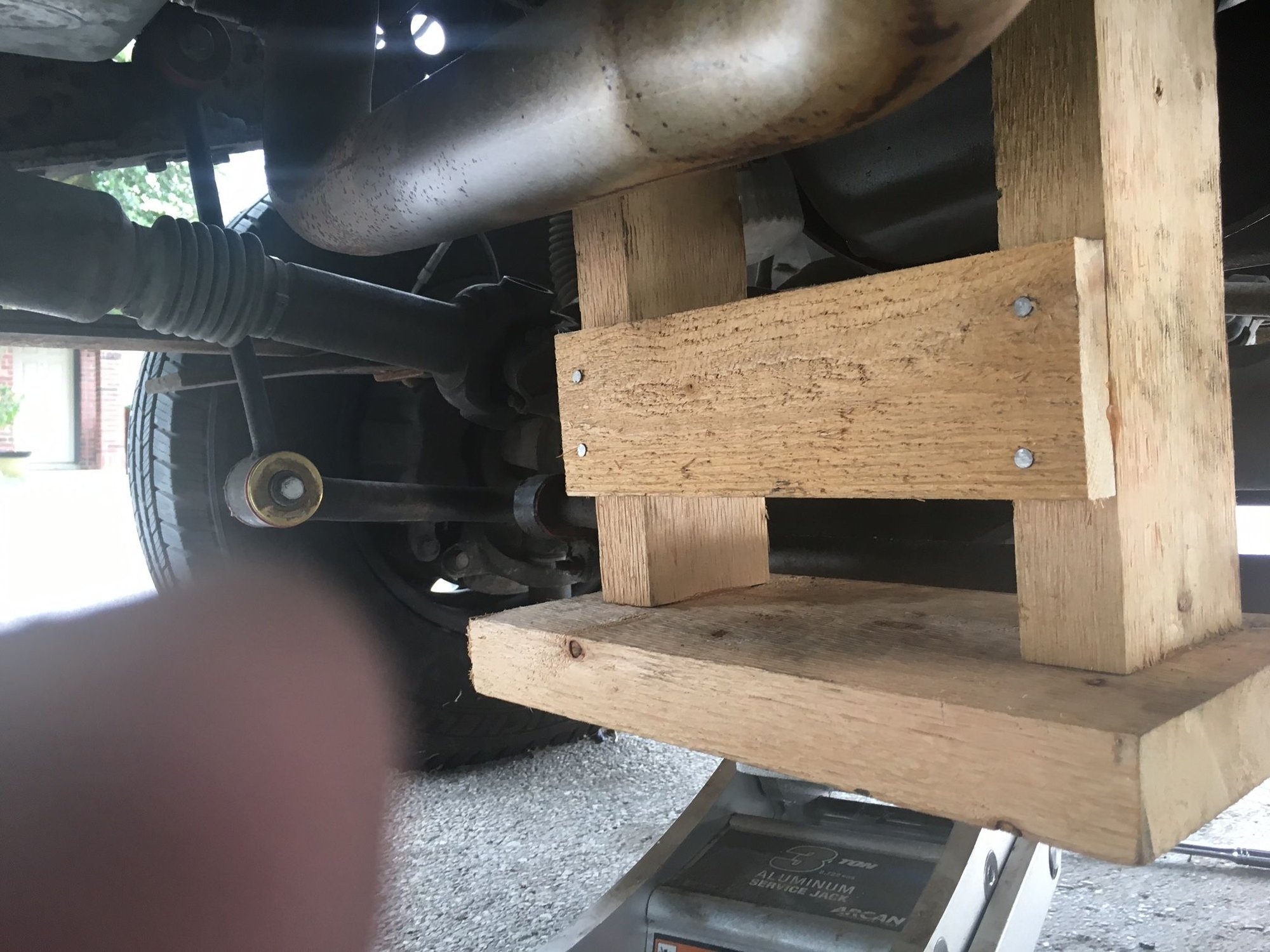

Lift the engine at the skirts of the block where the pan bolts to it.
I have shorty headers and a custom exhaust. I just unbolt the header collectors from from everything else before I lifted.

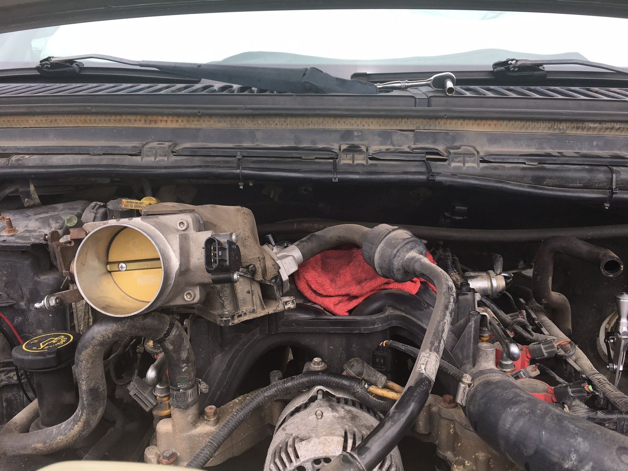

- The Elbow throttle body needs to be removed in order to get the needed height.
You can leave mostly everything hooked up, except the throttle cable cruise control etc... then set it off to the side.
- I aligned the left and right by measuring and then lifting the side that had a smaller gap for the slots. The bottom bolt on each side I aligned to the bottom edge of the slot so they where even at about 9/16". I did this using a 2 x 4 however I did not lift the engine like this expect for alignment.

I was able to move the elbow far enough out of the way to lift the engine to get them out.
this is the Lift I fabricated to hit the sides of the block its scrap wood. 2x4's would have worked too.
I think if I would have made it again I would have put something in there to catch on the transmission at the same time.
I need to clean up the wiring for the Auto meter tach... I took this to show that you lift it straight up between the exhaust on this side.
