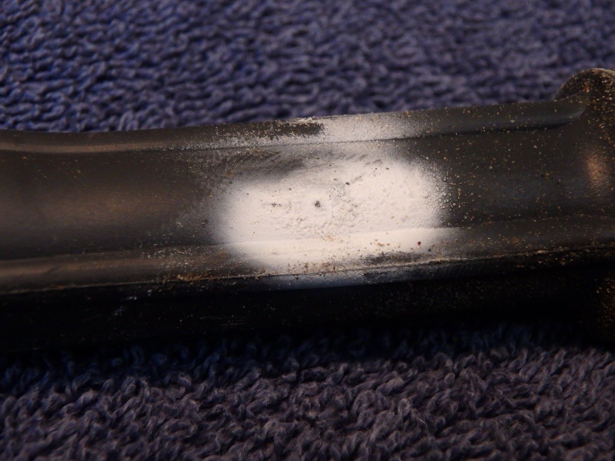

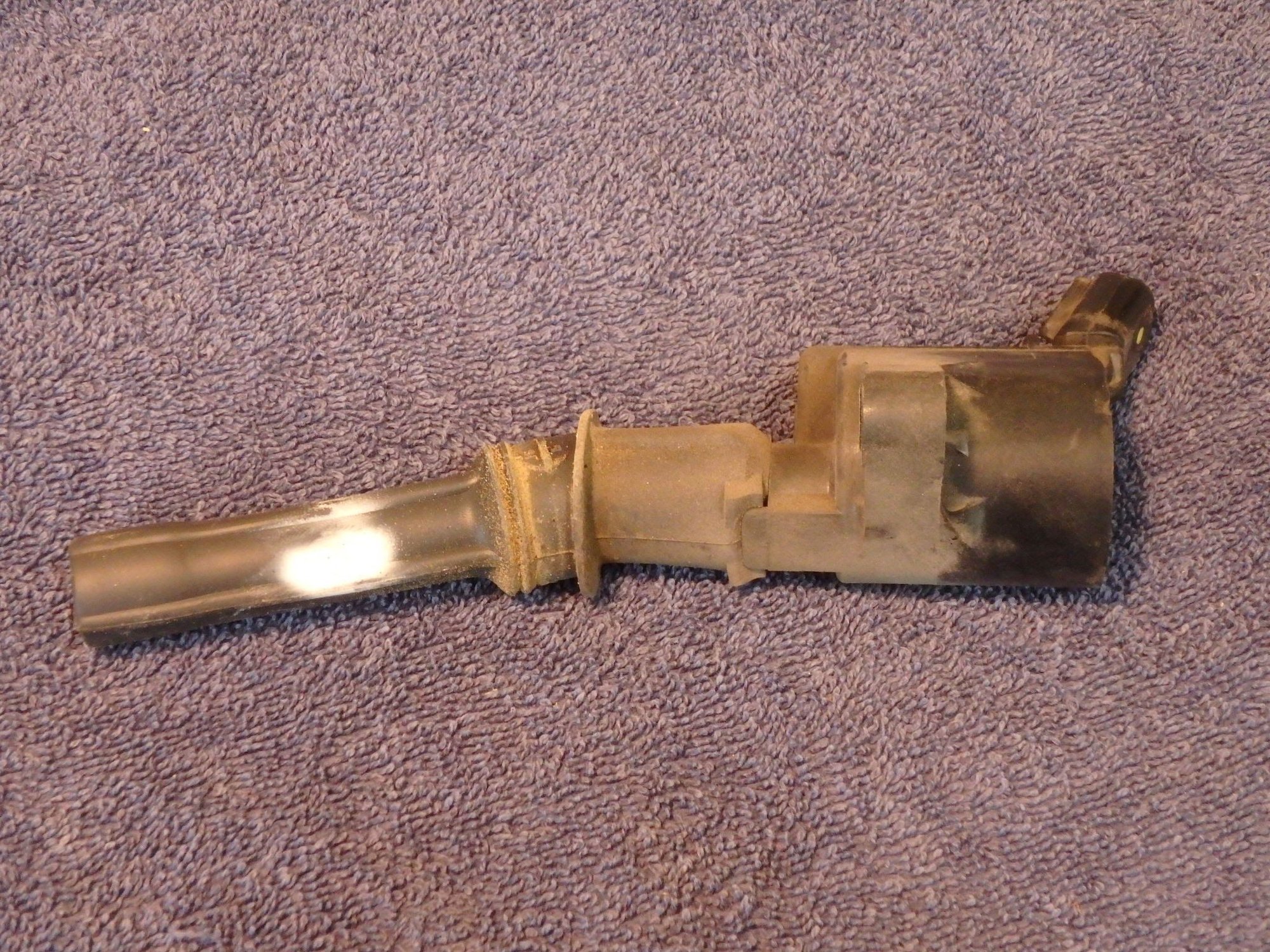

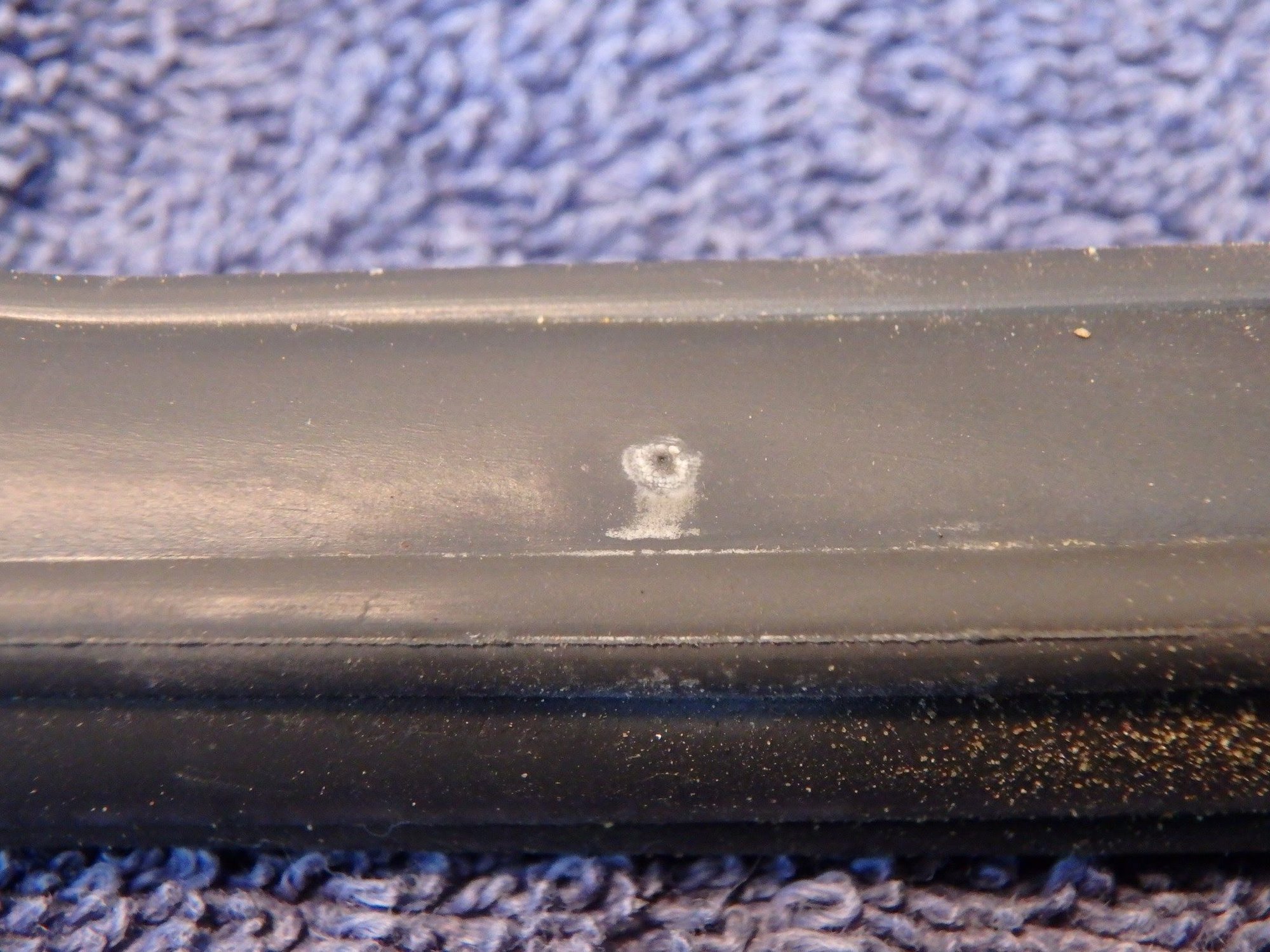

To the experts here...is this white powdery residue on the COP boot due to arcing to ground?
Background: '02 EX 6.8L V10 started missing/running rough at low rpm while travelling at 55-65 mph in OD. While moving some trailers around the property this week, it kicked out P0720 and P0301 showing misfire on cylinders 1 and 6 (up front). Plus intermittent flashing OD OFF light.

Not an expert, but I'd think that's probably what it is.

I'm with jayjordan on this. As an electrician, that looks all too familiar....

Yep all new boots and plugs at this point. Be ready for a couple coils soon as those are usually done by 100k.

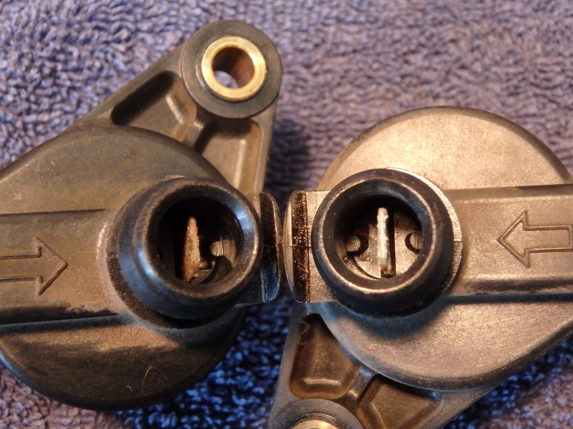

Thanks, all! Does a coil failure usually kick out a misfire code? Or do they die quietly?
A few coils have corrosion on the connector where the spring stick in. Cleans out OK though.

I would just do plugs and boots/springs and if the misfire persists, then change the affected coil. No need to replace them until they die. Just avoid the cheapo eBay coils and stick with the suggested one from the tech folder. I believe it is a denso found on rock auto. Not a bad idea to carry one in the glovebox if you travel a lot. Your pics are a classic example of boots that can't contain the lightning.

And yeah, that's arcing
