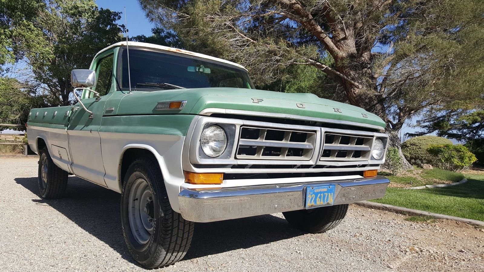

my sons 72 F250 front bumper is out of alignment with the grill ad body (passenger side is lower than the driver side), and it appears there is no way to adjust the bumper seeing how it bolts directly to the frame? Anyone else have this issue before?

interestingly enough, the passenger side is lower and also further out forward from the driver side... The driver side looks perfectly aligned with the grill, I just can't imagine how the passenger side could be further forward by 1/2" or so, I mean the frame doesn't stretch, and it the passenger side frame horn doesn't look bent at all. I'm going to pull the bumper off and check things out.

here's a pic of the front showing the bumper misalignment...

Actually I think it is frame damage. If you use an angle finder and check the frame's left and right end angles from the side, I bet you'll find the left frame horn is pushed back and up. If I am correct that truck hit something on the left side. The L/S is back and up. The right frame bumper mount point is now a pivot point. Which forces the R/S of the bumper forward and down. Like a teder todder.
I think your 100% on track here.

Only the 250 4X4 and 350 had the extra mounting brackets to attach the bumper. The others are direct mount to the frame horn leaving you without any adjustment. A good frame shop should be able verify and correct it for you.

It doesn't have to be frame damage, it could easily be, (and most likely is) that the bumper is simply bent and tweaked.

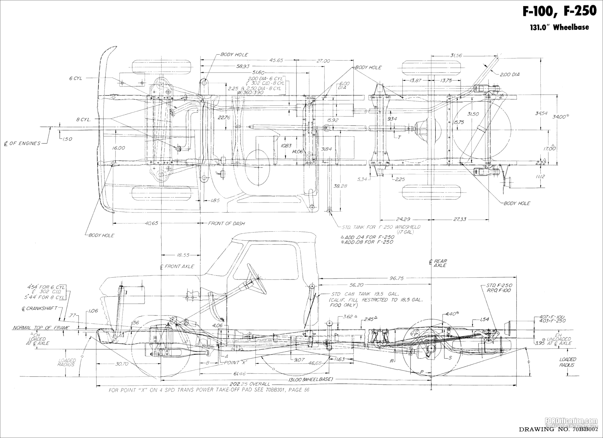

LWB frame dimensions.

Steve, is there a diagram like that somewhere for a SWB? I looked around at Fordfication and couldn't find it.
