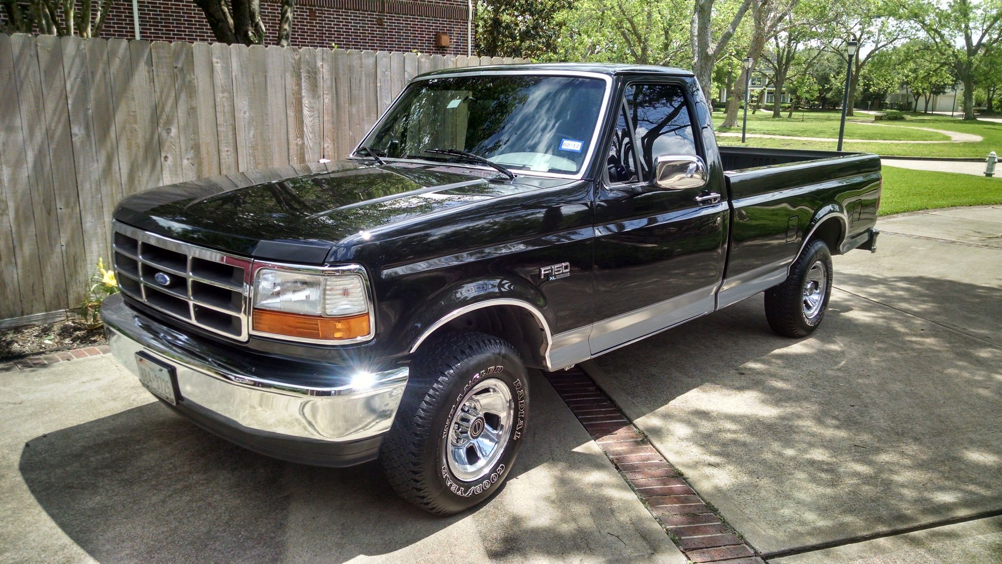

I put 1 1/2" level pads on the front of my truck and four new KYB shocks. I have the stock wheels and do not want to change them. With that small level will 33" tires work or would I need a small suspension lift? I don't want to put 31" on as it does not seem to justify new tires. I also would not go over a 4" lift as it does not interest me and a 4" is actually more than I want. My goal with this truck is to have a nice fairly stock truck to just enjoy and maybe take to a car show. I know a lot of you folks use them for work or play but being retired, I just like driving mine around and shifting. Then bringing it home and cleaning it. It didn't look anything like this when I got it. Thanks Sandy
