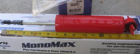

Still looking for more control (ie stiffness) in the rear, to match what I have up front. Re:The current/previous setup
This is also something of a follow up to the KYB:Gas-a-just v GR-2 thread,
and I have been schooled once again that the KYB Monomax is (likely) a performance spec above the Gas-A-Just.

Yeah, up front I've been using the 565051 for several years.
Interestingly, just now when running a google on the number rather than googling say "Aerostar Monomax rear" I came up with their dimensions page.
I then ran a test of the chart using dims off the current shocks and did in fact come up with an Aerostar rear, only it was in their Excel-G line, #344290.
The Gas-A-just KG5492, also shows up in the list, with slightly shorter dims.
Haven't seen anything else in the length, end style, and eyelet dims.
