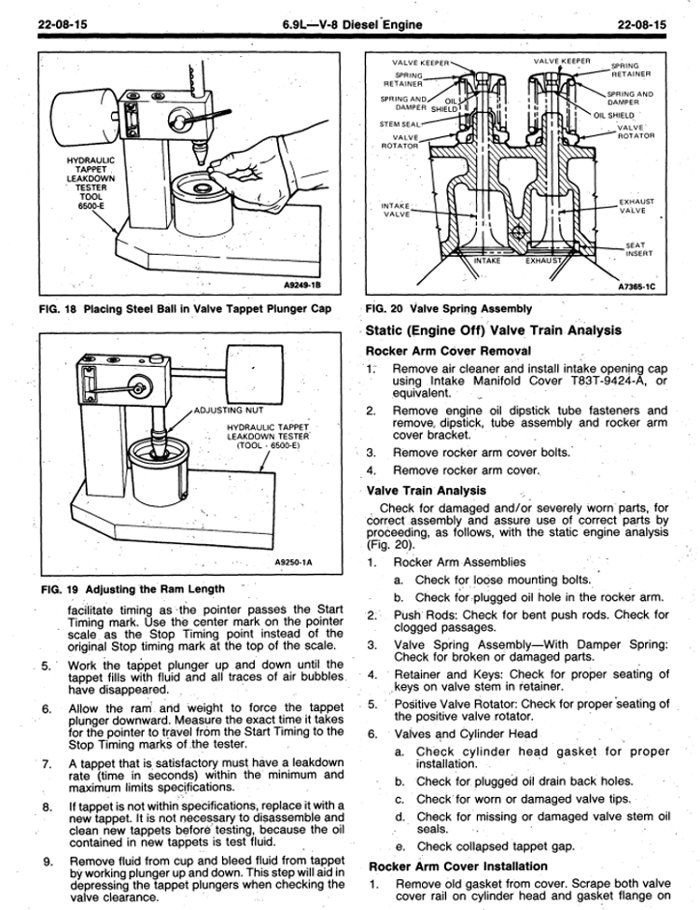

I couldn't find the low end limit for compression either but the 'normal' acceptable variation in cylinder compression between lowest and highest, stated in my 87 manuals for the 6.9L is 75%. That means going down from 410 psi (in number 8), would be 307 psi, or going up from 300 psi would be 400 psi. All it says is that a variance exceeding 75% implies improperly seated valve or worn or broken piston rings. It seems to me it would be blowing a lot of white smoke if that was the case.
He says it's running good otherwise so I wouldn't call the engine "Worn Out" yet, not as a whole, anyway.
The noise must be coming from the valve train and I'll post a page from my manual for diagnosing that, should be the same valve train except for the size of the valves. Quite a lot of things to look at.
I don't understand why one cylinder, #8 would be so much higher. Maybe it got better lubrication? It seems like the rear two cylinders on these engines 7 & 8 get pointed to more often than others when diagnosing problems, like IDI-John's glow plugs/controller problem awhile back AND the unmaintained CDRs leaking into the rear two cylinders.

Compression Test & Valve Train Diagnoses from 1987 Ford Shop Manual
Two pages. The air leak I mentioned previously that could affect lifters would be at the oil pick-up tube gasket mentioned in second column on first page. You may have to enlarge these images to read them clearly. This is the best I can get from the scans on CD of the original manual and have file sizes small enough to upload.

I just re-read your original post. That does seem like it could be from an air leak at the oil pick-up tube! Bad gasket or a crack.
I would take it off and examine it very closely for cracks and replace the gasket.
